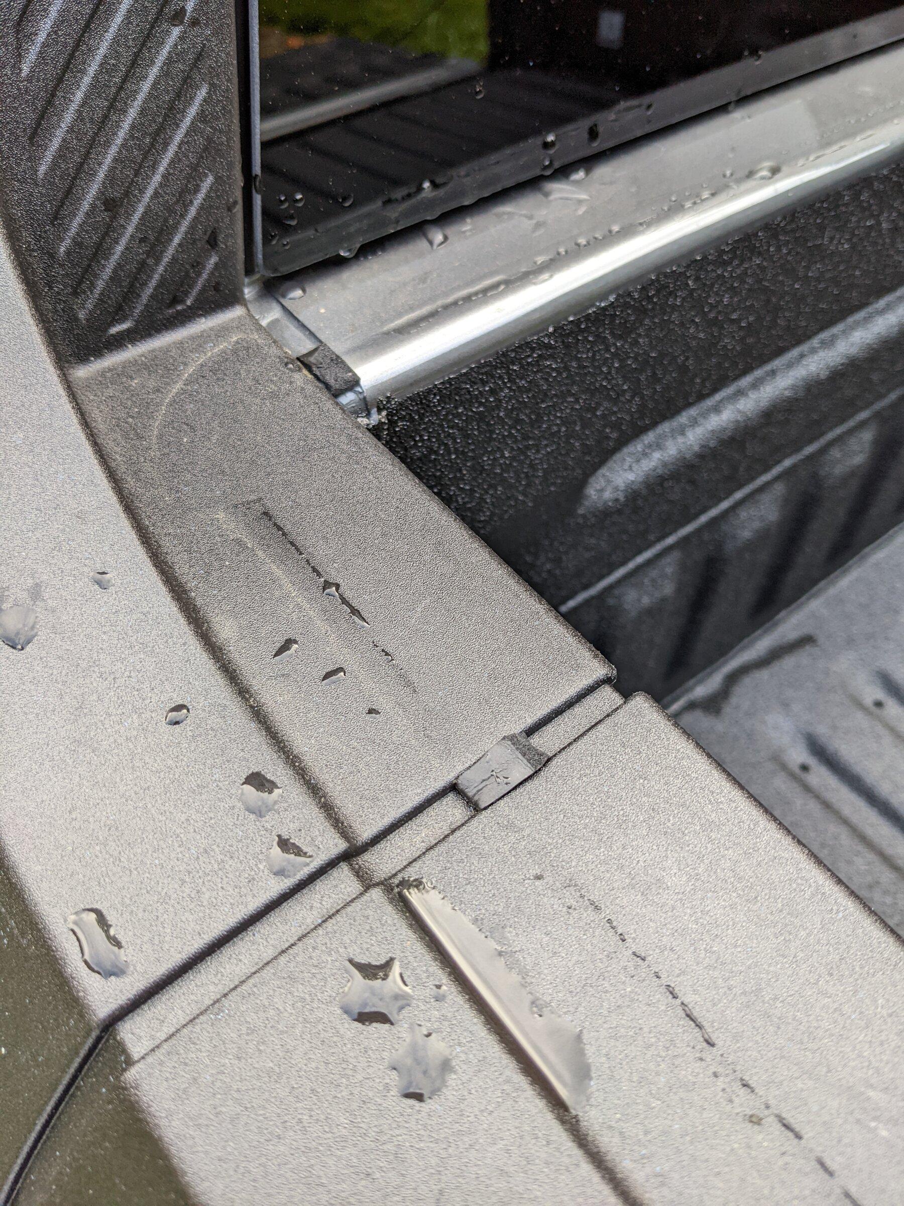

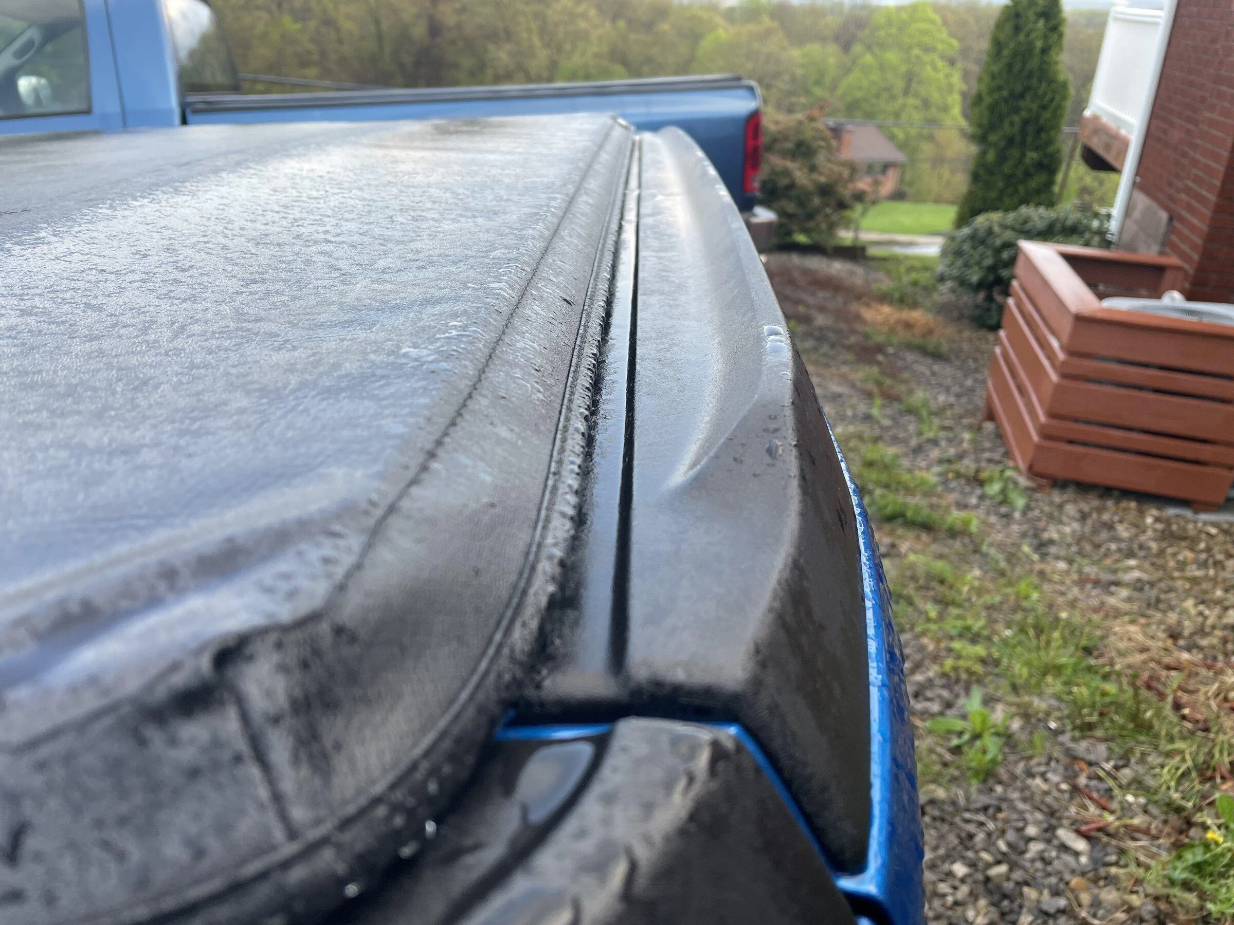

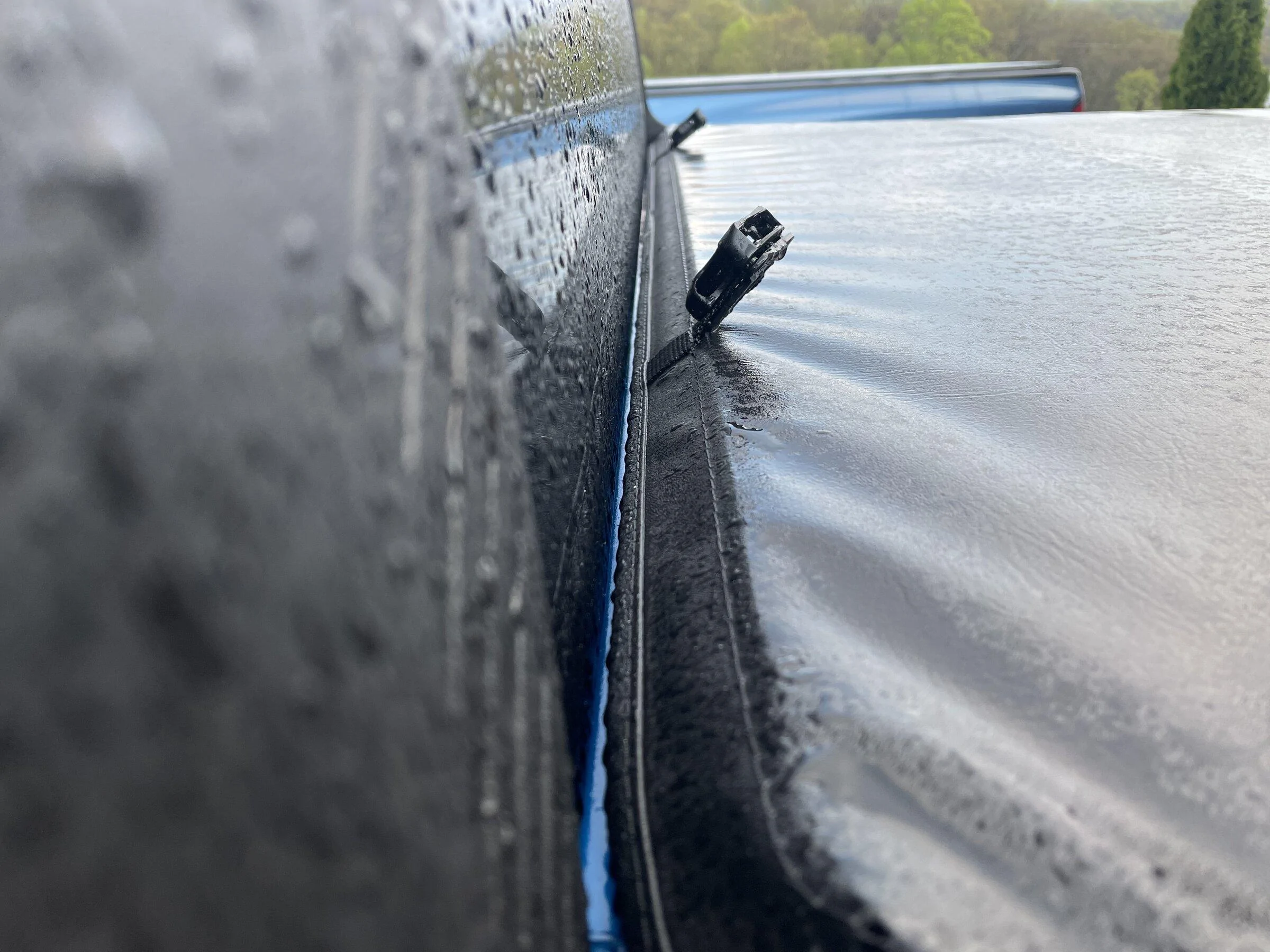

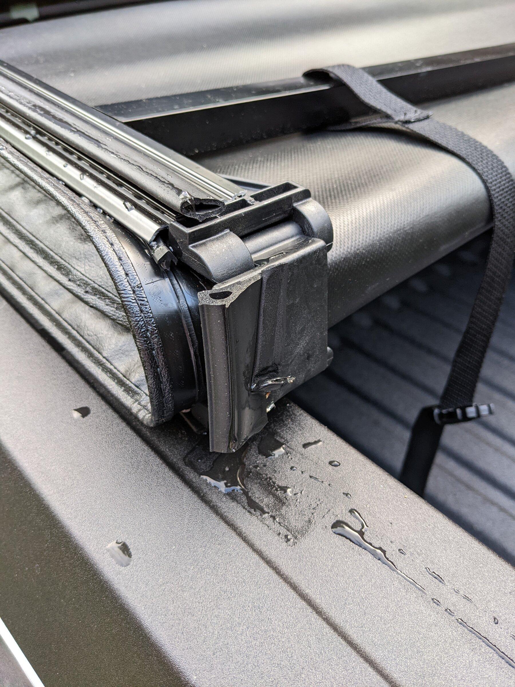

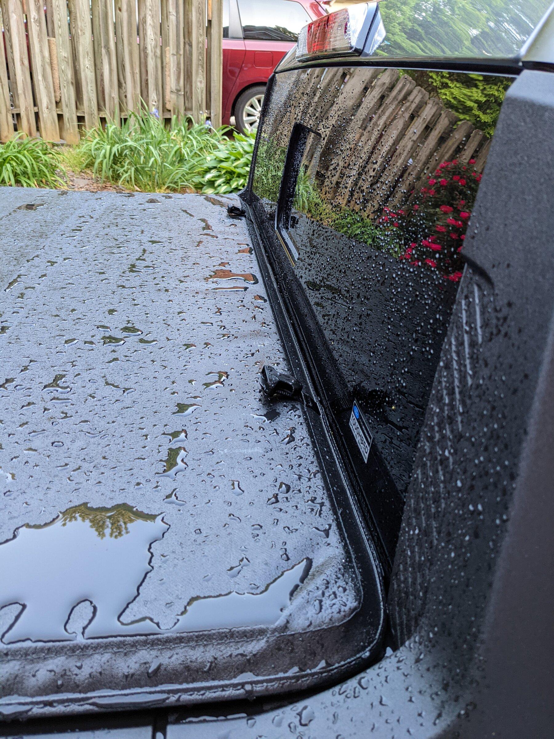

I have a gator sfx trifold and initially tried to install it so if was "centered" in the bed - about a one inch gap between the cover and the back window glass. However, I get a significant amount of water leaking in from the back cab-side of the bed.
I'm going to stick a small bit of that tailgate weather stripping in the joint between the body piece that's up against the rear glass and the bed rails, and also install the cover so it's flush against the glass and see if that helps.
Does anyone else have any tips or tricks for the gator cover to help make it more water resistant?
