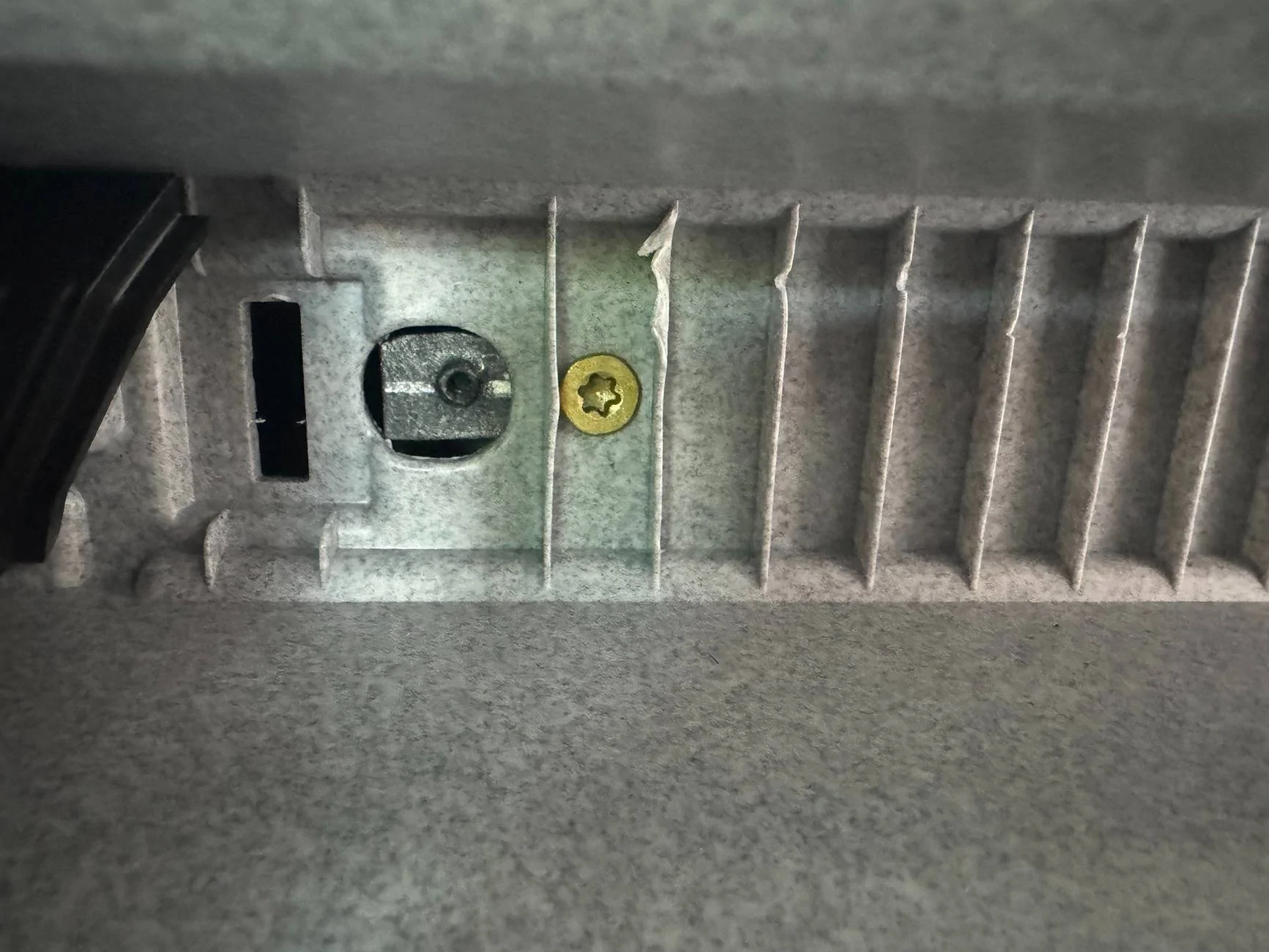

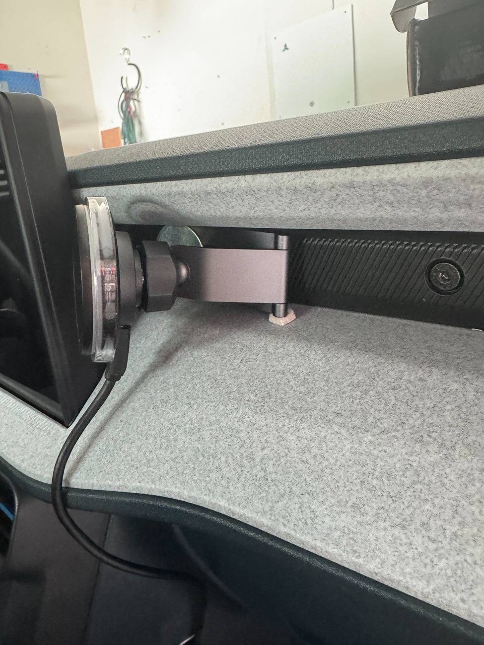

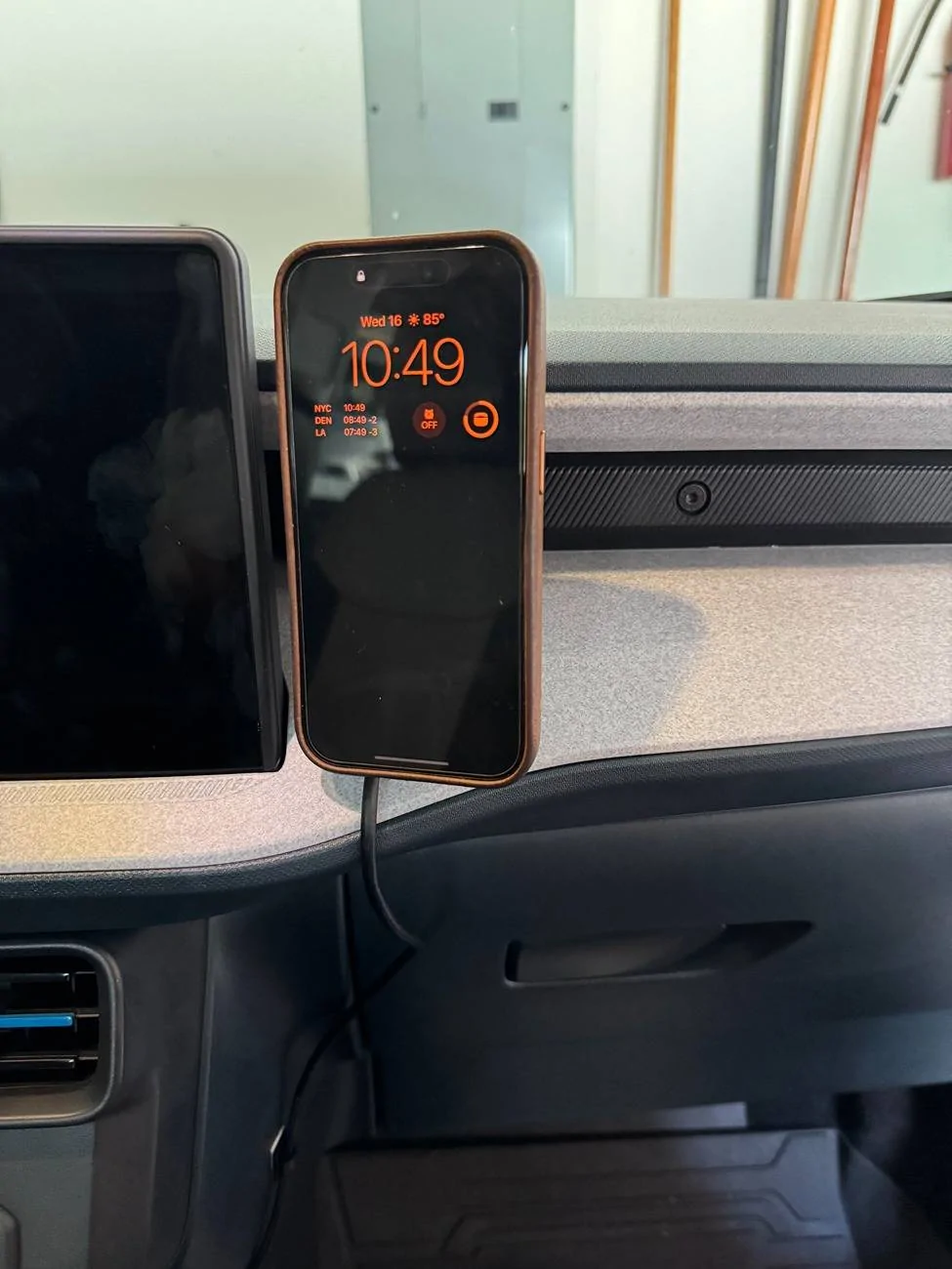

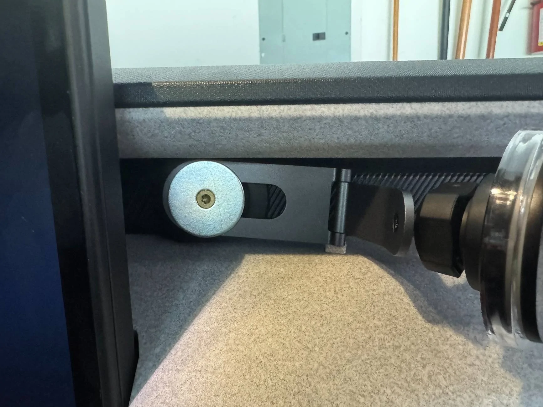

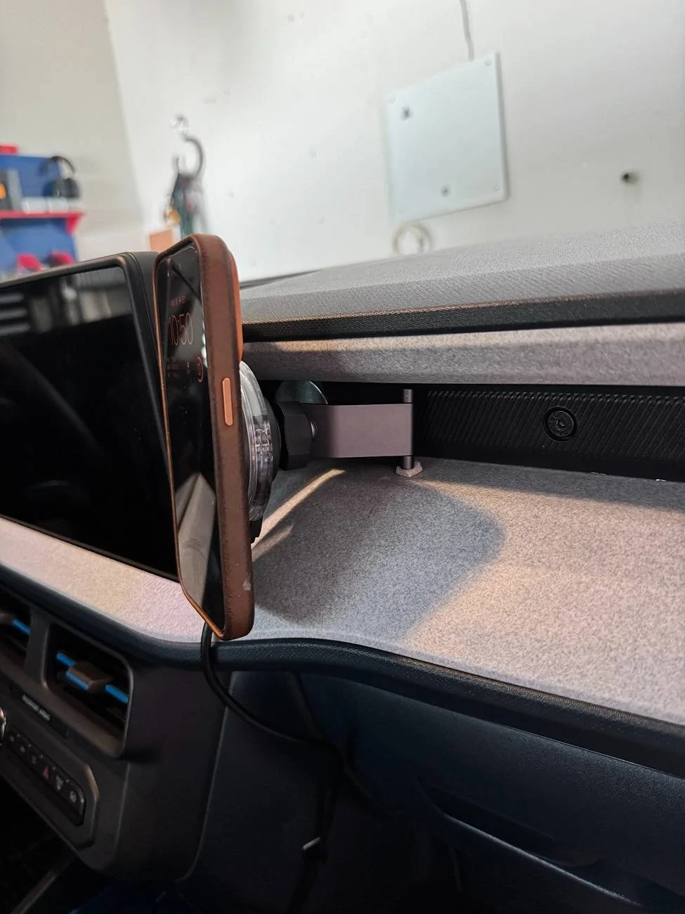

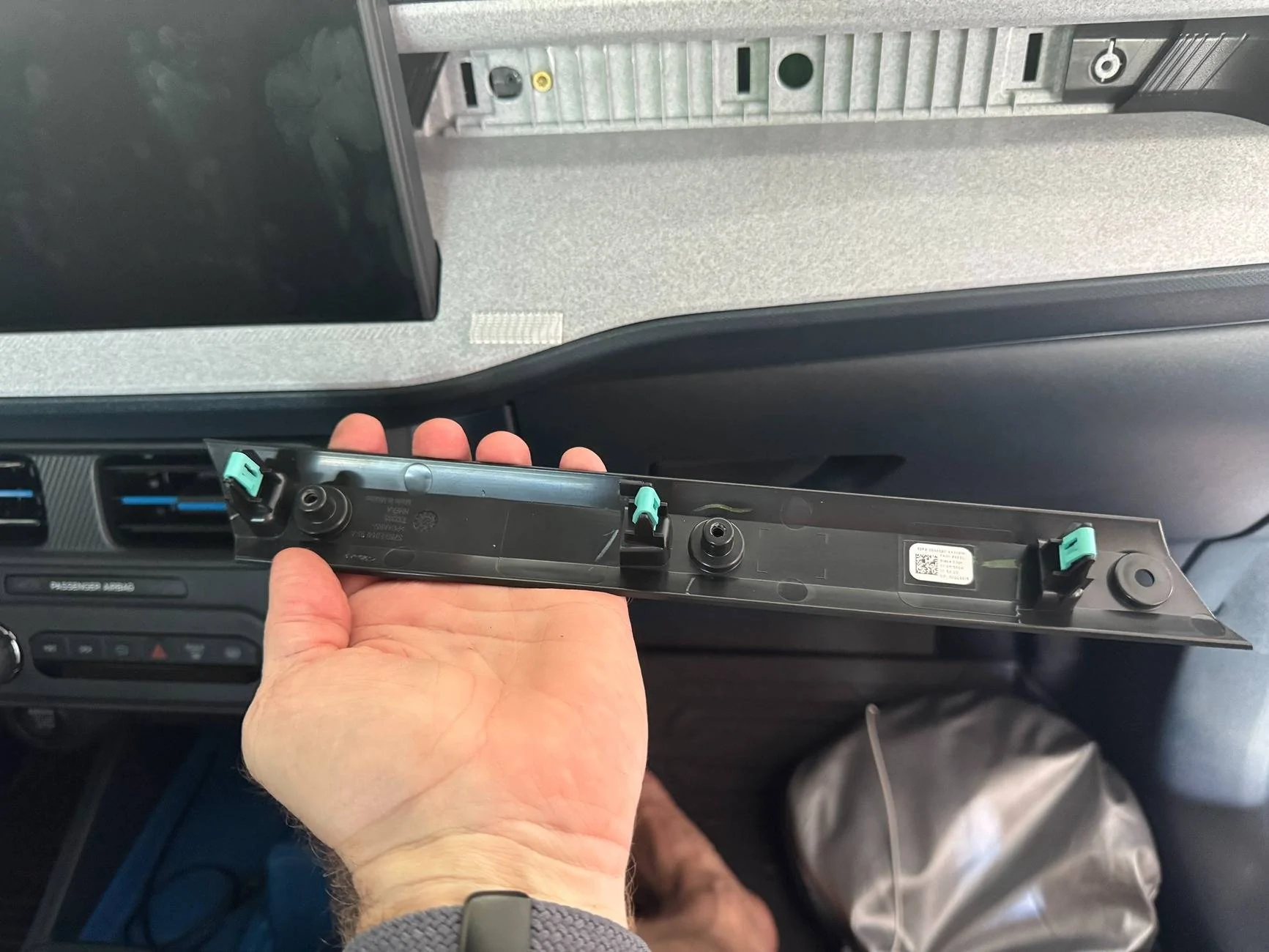

Hi all,
Here is my take on a phone mount for the 25 Mav since the cubby is not available anymore.
I took out the decorative trim piece (3 screws and 3 clips) and mounted a sturdy piece of plastic behind to give the mount more stability.
I predrilled the holes to make the installation easier. Take care not to block the hole for the clip.
I then reinstalled the trim and used a longer screw to secure the mount. I added a little piece of felt to prevent any rattling.
It feels pretty sturdy, keeps the phone cooler while charging and gives better cell and GPS reception for navigation.
This is the mount I used:
https://www.amazon.com/SYNCWIRE-Uni...ocphy=9051707&hvtargid=pla-2281435179738&th=1
It has a standard ball mount so you use many different attachments.

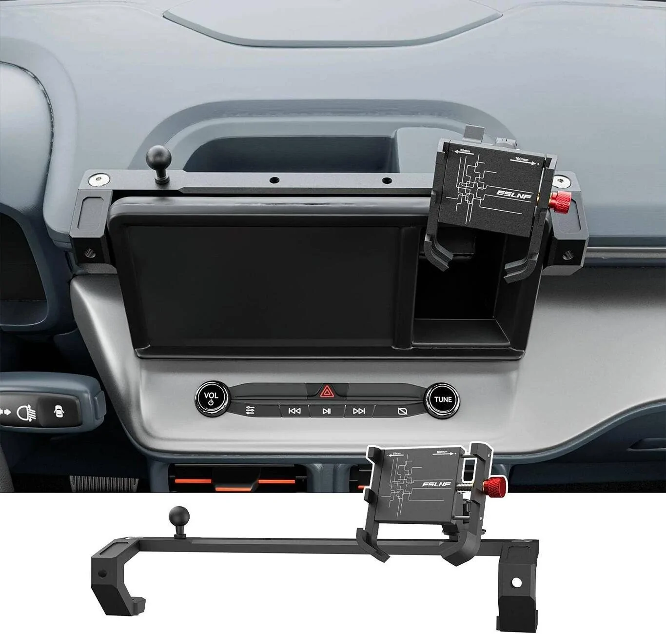

I recently saw this on ebay.. pretty slick but idk how practical. says it works on the '25's

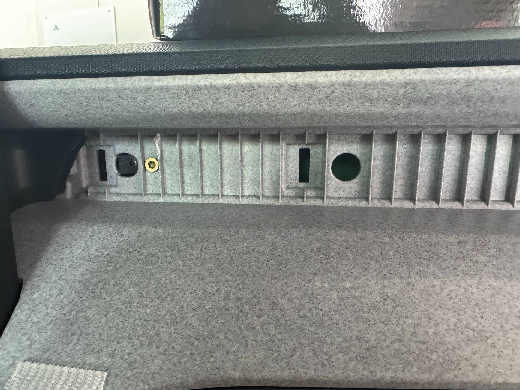

Thanks for these pics. I've been wondering if the exposed bolts on that center trim piece would be strong enough to support accessories (like a phone mount/charger).
Thor0510
Thorsten
Dec 18, 2024
2025 Ford Maverick XLT Hybrid AWD
I tried without the plastic backer piece and it was too wobly for my liking. With that piece it's much more rigid
eBay link
For me, I have a '22 so I have a cubby mount setup (using this holder) with AA. True, sometimes I don't place my phone in the mount. It's a solid and economical setup, compared to the above.
I tried it. Does not work. Returned.
