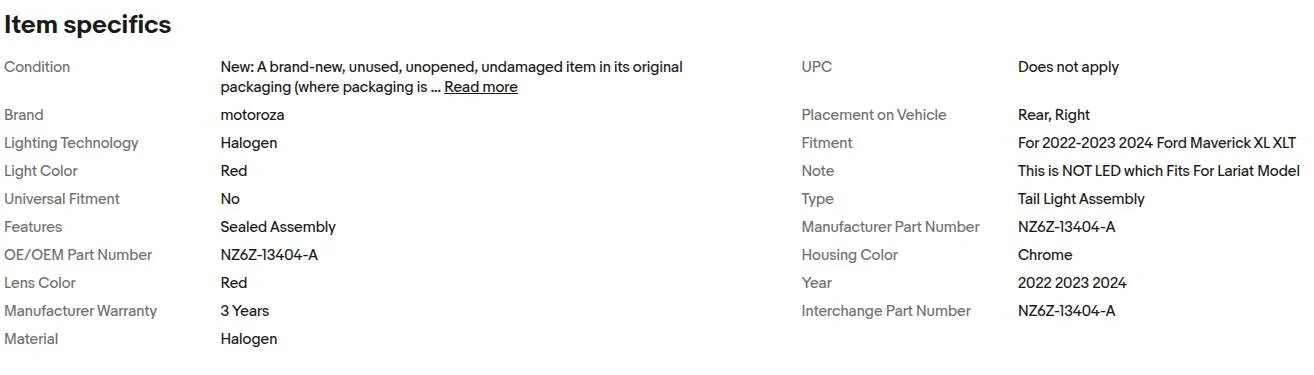

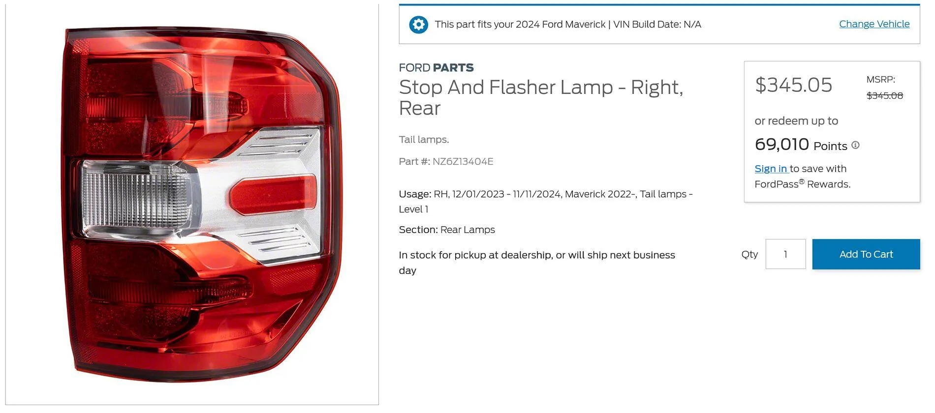

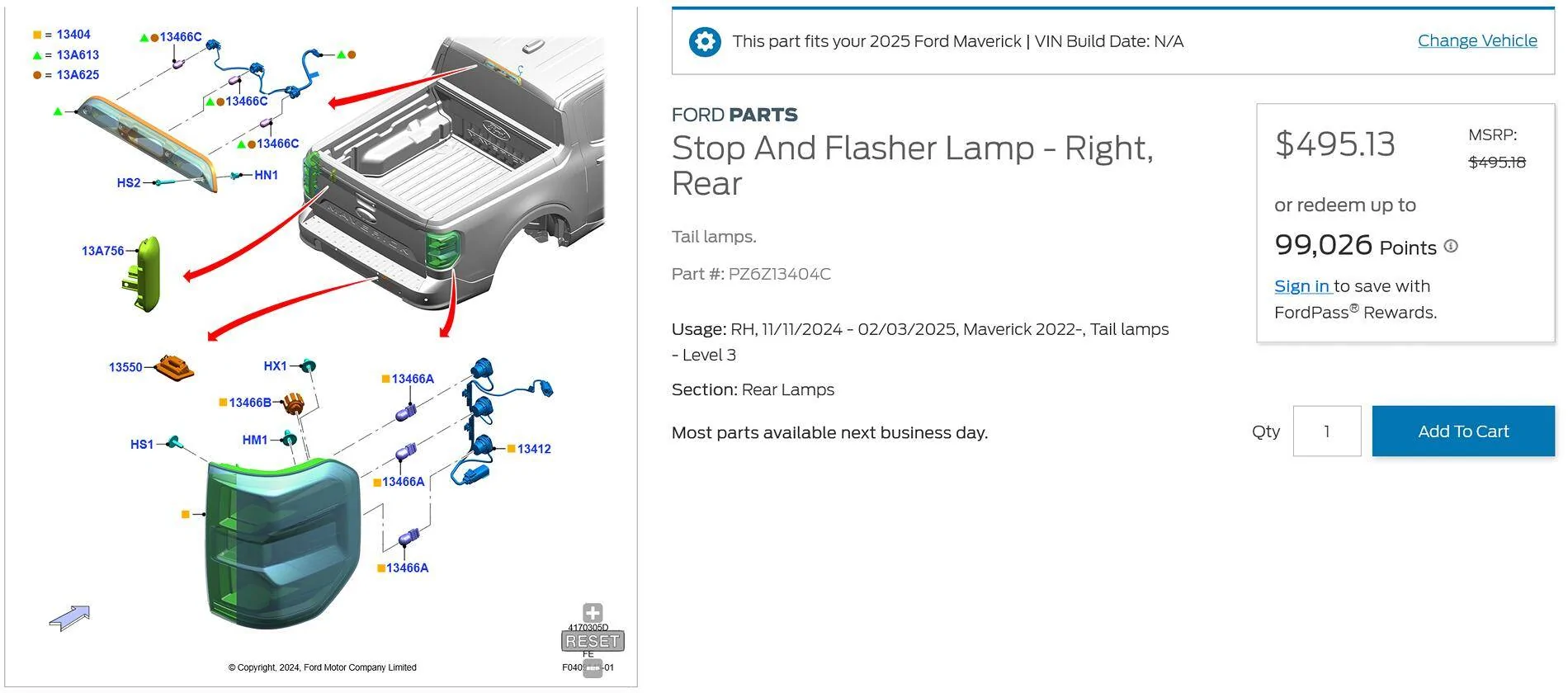

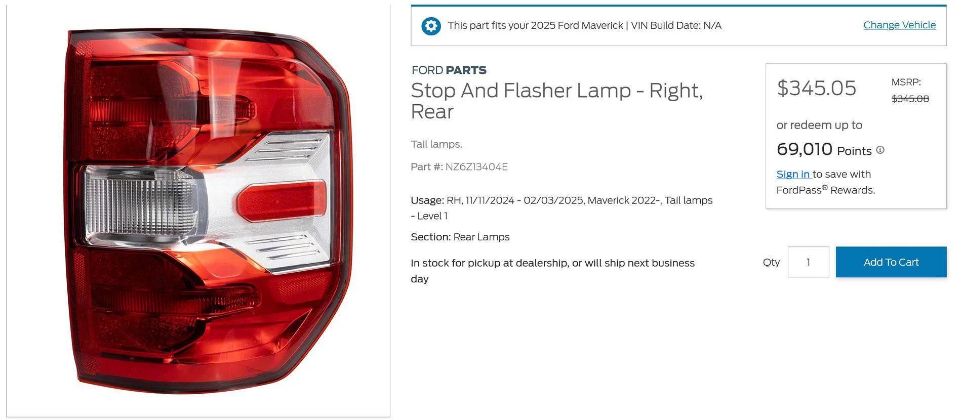

hi, specifically I'm looking at a rear light assembly, I have a 2025 2.0 ECO XLT, I found online and the description is for models up to 2024. I don't know for sure but I'm suspecting the description hasn't been updated. I've emailed the seller but in the meantime I'd like to ask here because there's a wealth of knowledge here, ie Do you think the 2024 light assembly will fit the 2025 ?

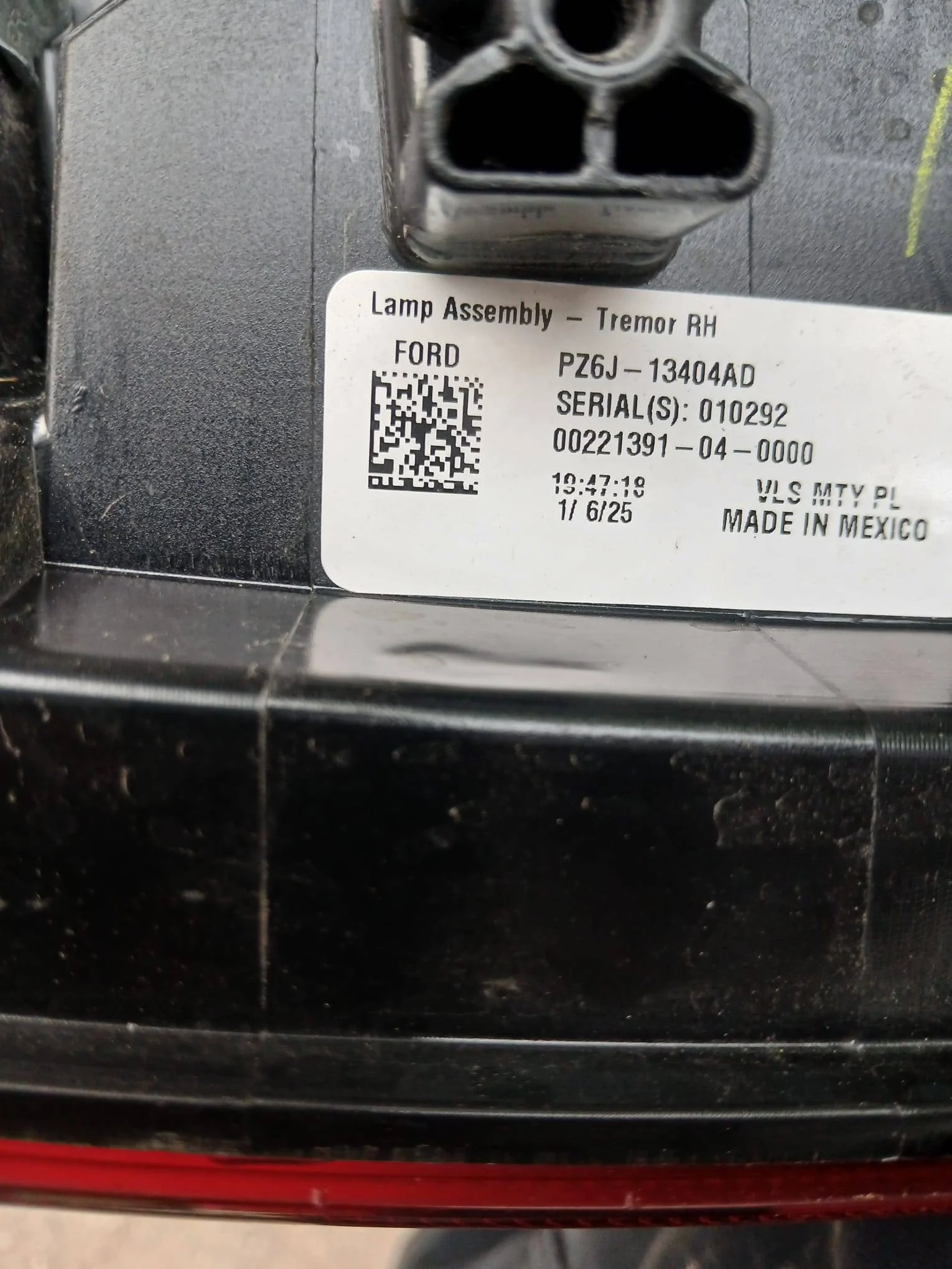

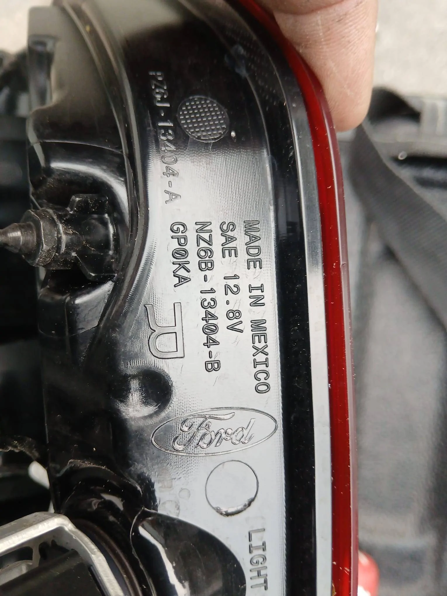

I pulled my light and notice how the light states this is for Tremor ? I don't have a Tremor, so definitely these are the same for Tremor as they are for XLT.
here's the description from the seller....
