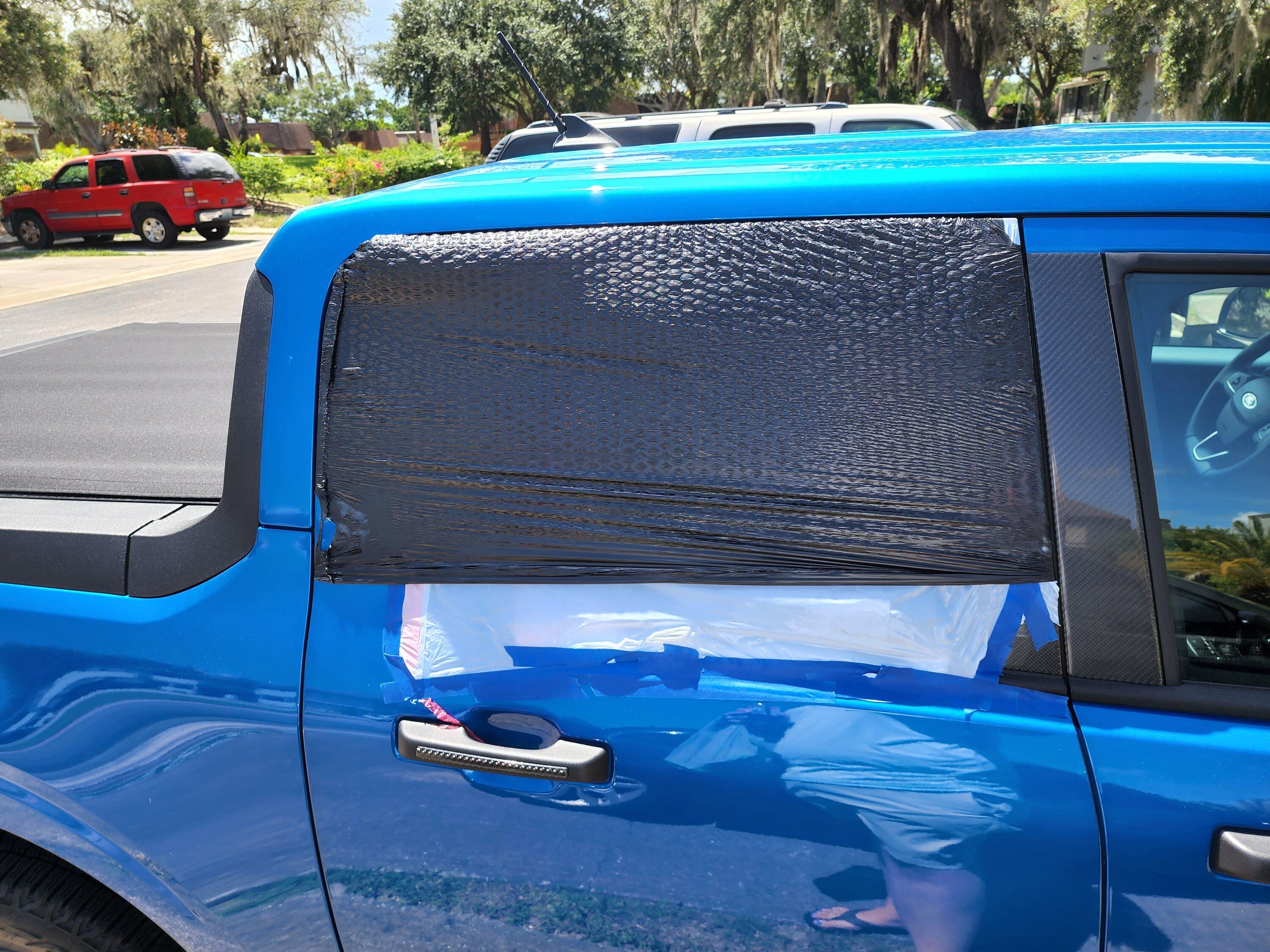

Whelp, hot day, rolled the windows down to dump out the built up heat aaaand
Ford Maverick One-Way Window 20220723_150742
I'll be waiting until Tuesday for the dealership to take a look at it. I'd get in there myself to see what happened, but I'm not risking a warranty rejection. Too much rain in Florida for this shit lol
Edit:
Just adding this as an update, it was the switch, which burned out the motor :) Dealer says switch won't come back up, so replacement motor and master switch... Which are both on backorder.
I've got three windows for the foreseeable future LOL

The glass fell off the track?

I've seen on other discussions where the drivers switch was at fault!
That's a thought! My guess is the passenger window switch wouldn't work either in that situation? Got me curious...

It's like it's bound, I couldn't draw the glass up with tape like I've been able to do with other windows
That sucks man.
But I will say, looks like a professional trash bag cover job. So you’ve got that going for you!
Power window switches are wired in series. So if there is a bad connection in one, neither will work (for that window). Try pressing HARD on the switch, a lot of times that will make a non working switch work. I had an auto repair business for years.... and people would neglect to tell me that their window switches were bad. I always rolled the drivers window down so I didn't lock the keys in.

That sucks man.
I agree looks like a professional tint job.

Thanks! Gonna slap a Ford logo on it for Tuesday
Just looked closer, did you add carbon fiber style B pillar and door handle accents?
Going to give this a shot, what's the risk at this point!
