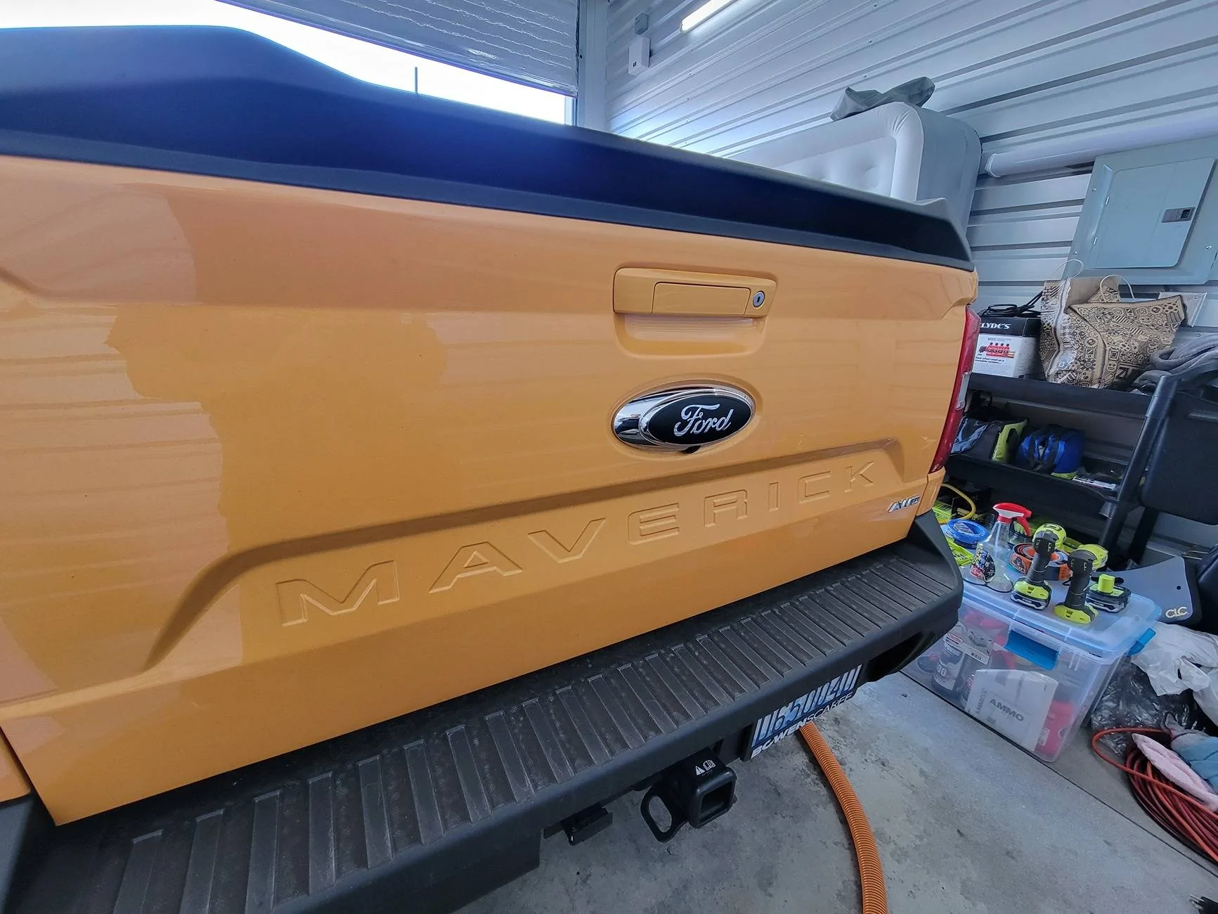

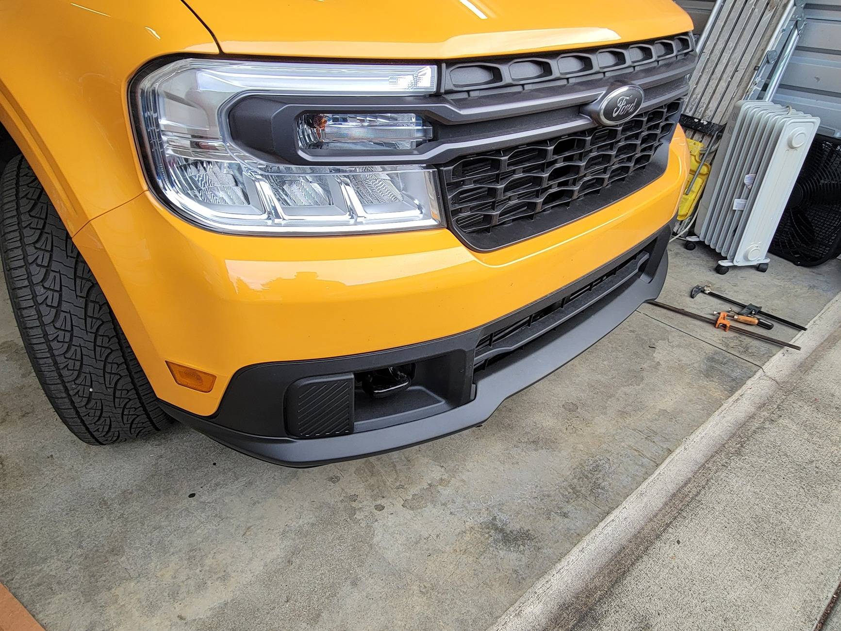

I finally got my mirror caps, door handles, and yes even the ranger painted tailgate handle installed. It was an ordeal. But patience and a myriad of curse words later... success!

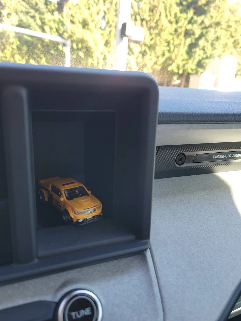

I added another painted piece today. Off ebay, they did a great job of customizing this thing. Doesn't match my truck exactly, but it'll do until someone makes a better scale model.

Looks great, what was the ordeal? Install?

I got the passenger door handle clamping mechanism inside the door clamped down without the door handle installed, don't do that. Had to use a pick tool to reset the mechanism. The front door handles I bought had the wiring for the keyless entry, but I have an xlt and guess what? The inner portion of the handle that goes into the channel towards the front of the truck hits something inside the door and I had to trim about 1/2 inch off the end of the plastic. The tailgate handle bolt on the drivers side was off by about a
1/16" to one side. I had to drill out the hole in the tailgate interior to make it fit. That's a couple of the issues.Loll

You forgot to paint the "grey" parts that go around the emblem and through the headlights.
I thought about it. Right now I'm moving on to suspension and wheels. The interior is almost completed, the exterior is as far as I am going for the moment (still crossing my fingers for a widebody kit, and im working on my plastic welding to try to cut that hideous rear bumper cover down), and then it'll be time to bump up the power!
