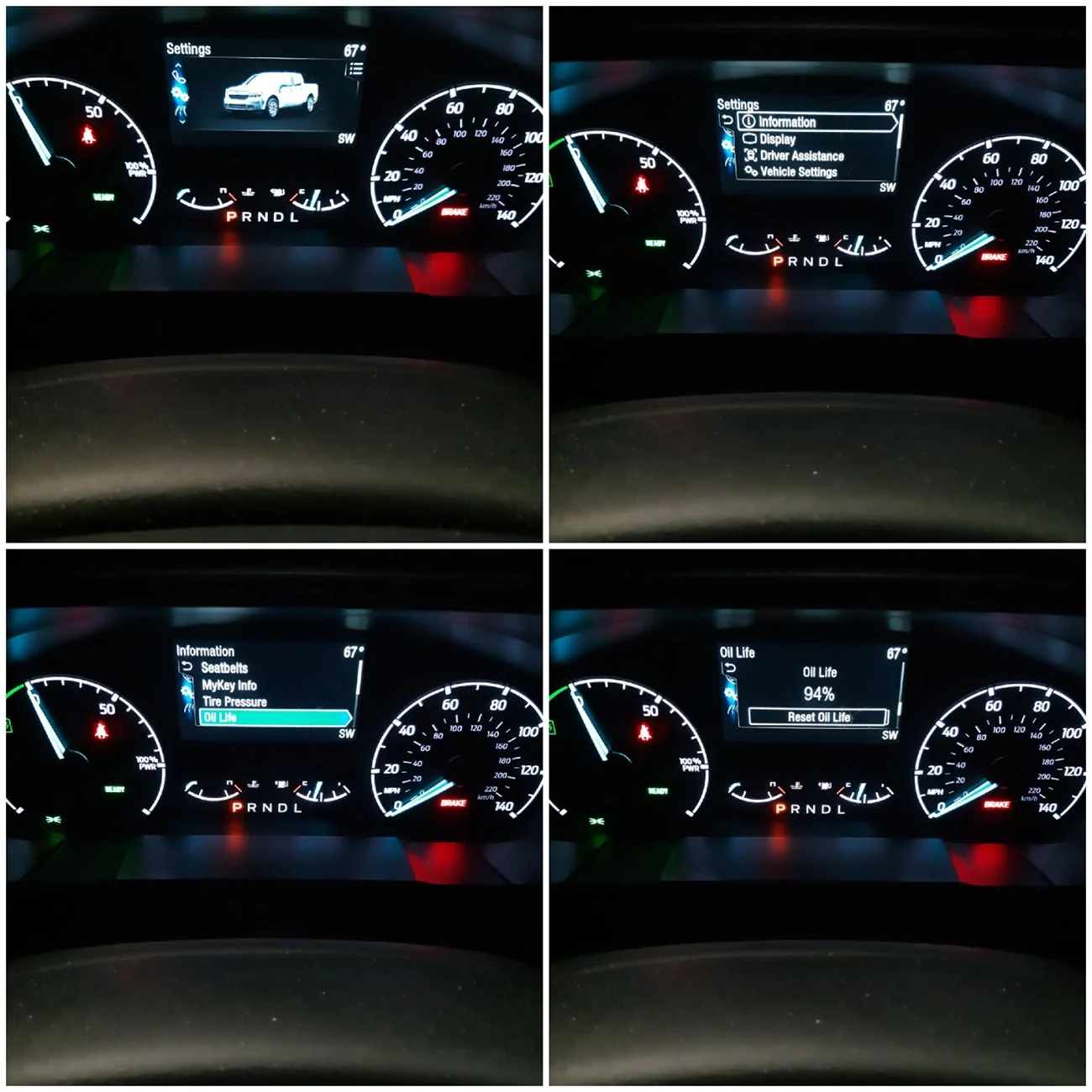

I've got some pictures, video and page from the owner's manual.
I hope these help.
Ford Maverick Oil Life Reset 20260303_123759

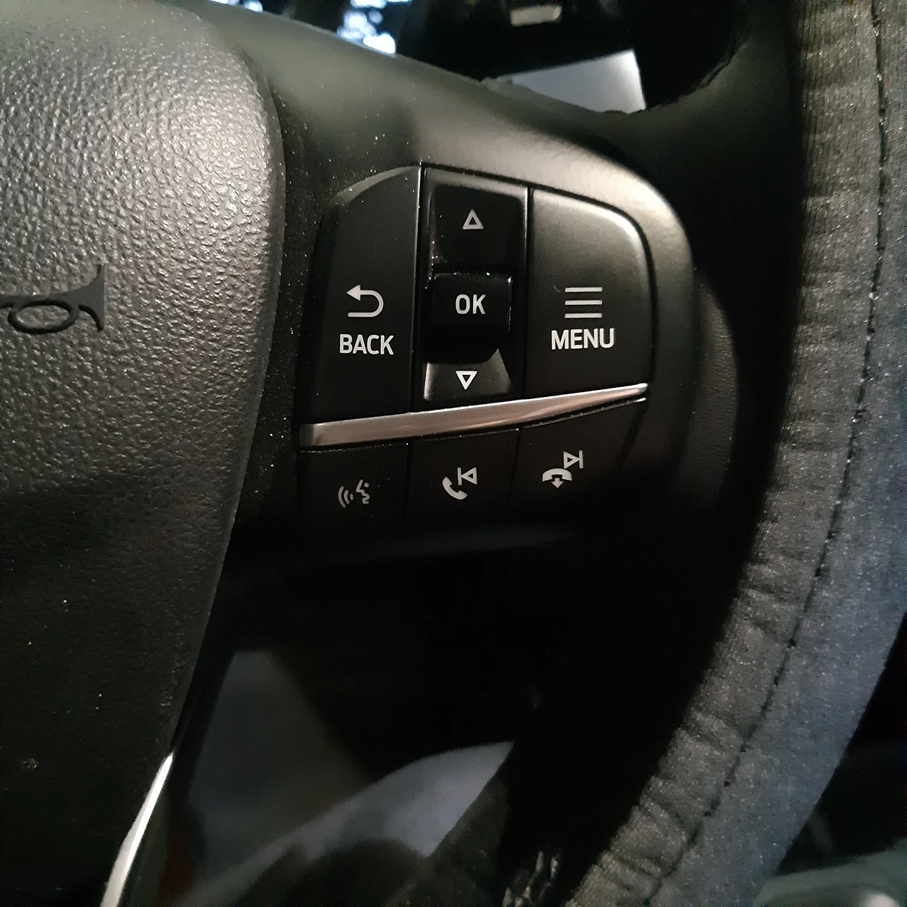

Using the okay up down menu and back button is how you toggle through the screens.
Ford Maverick Oil Life Reset 20260303_123728
When you get to the final screen that says oil life you press okay and hold it in and it will reset.

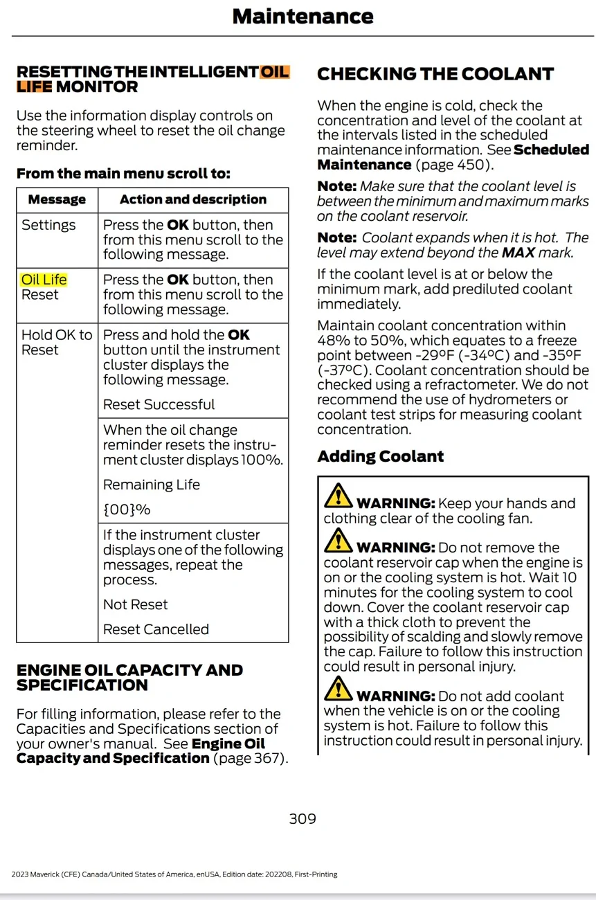

Also page 309 of your manual.
