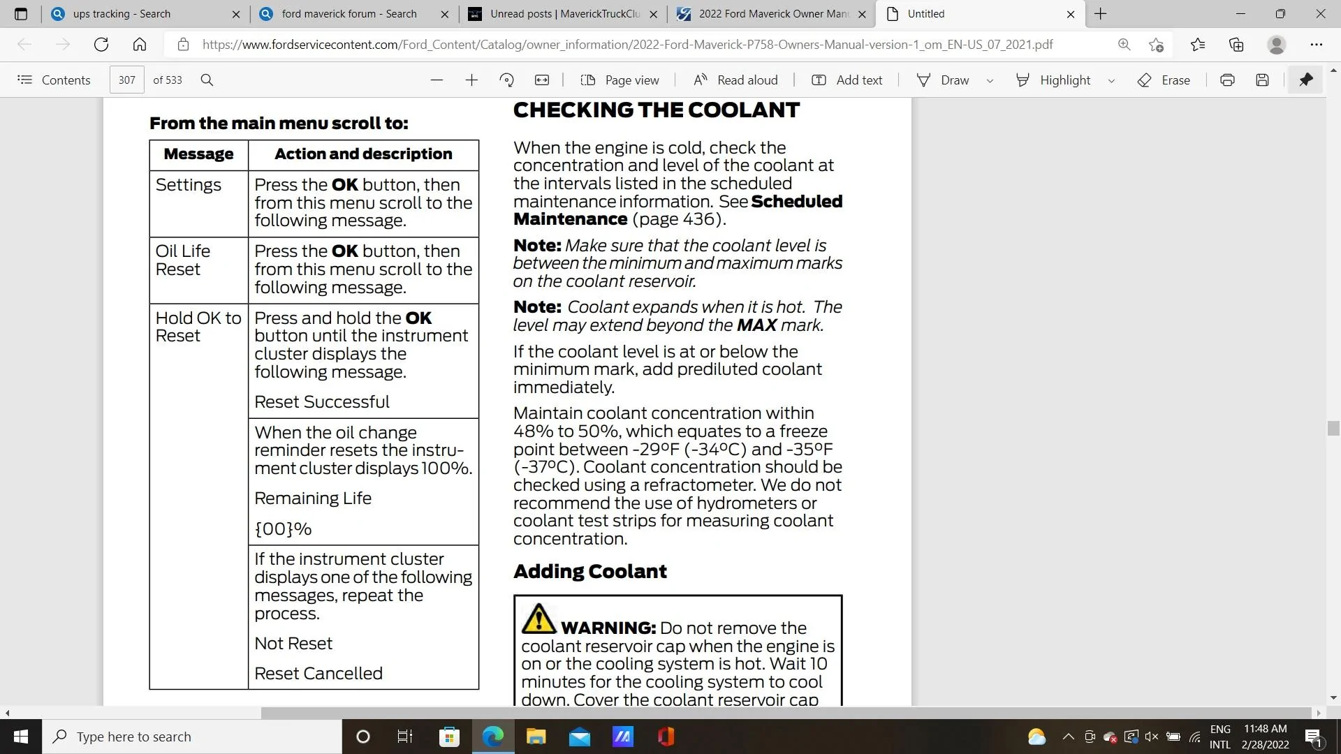

Anybody know how?
I have a hybrid and I changed the oil at 5,373 miles. FORDPASS app is showing oil life remaining at 60%. How do u reset that back to zero?
I looked in the manual and checked settings in the car but don't see that. Do I just have to wait until the message pops up?
