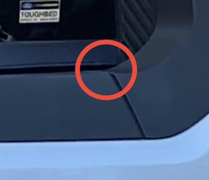

I have the thick weather strip on the bed near the cab, no water coming in there
Yeah the back of the cab is fine for me
Yeah I used it just like in the directions. Even extra around where the bulkhead meets the rockerpannel.
The whole back is dry. Guess the problem is the water has no where to go

I havent done the tailgate seal yet, didn’t understand the instructions, but have an idea what to do and am waiting on warmer day. I was getting a good bit of water in the bed up near the cab when we had hard rains and truck parked. Used plumbers putty yesterday (pic) and This morning was none.
I'm going to call truxedo tomorrow. Plummets putty is a great idea
Hey don.
Quick question. Are the side rails completely flush with the roclerpannel? The side rails weather strip doesn't hang over into the bed?

My side rails hang in about 1/4”
