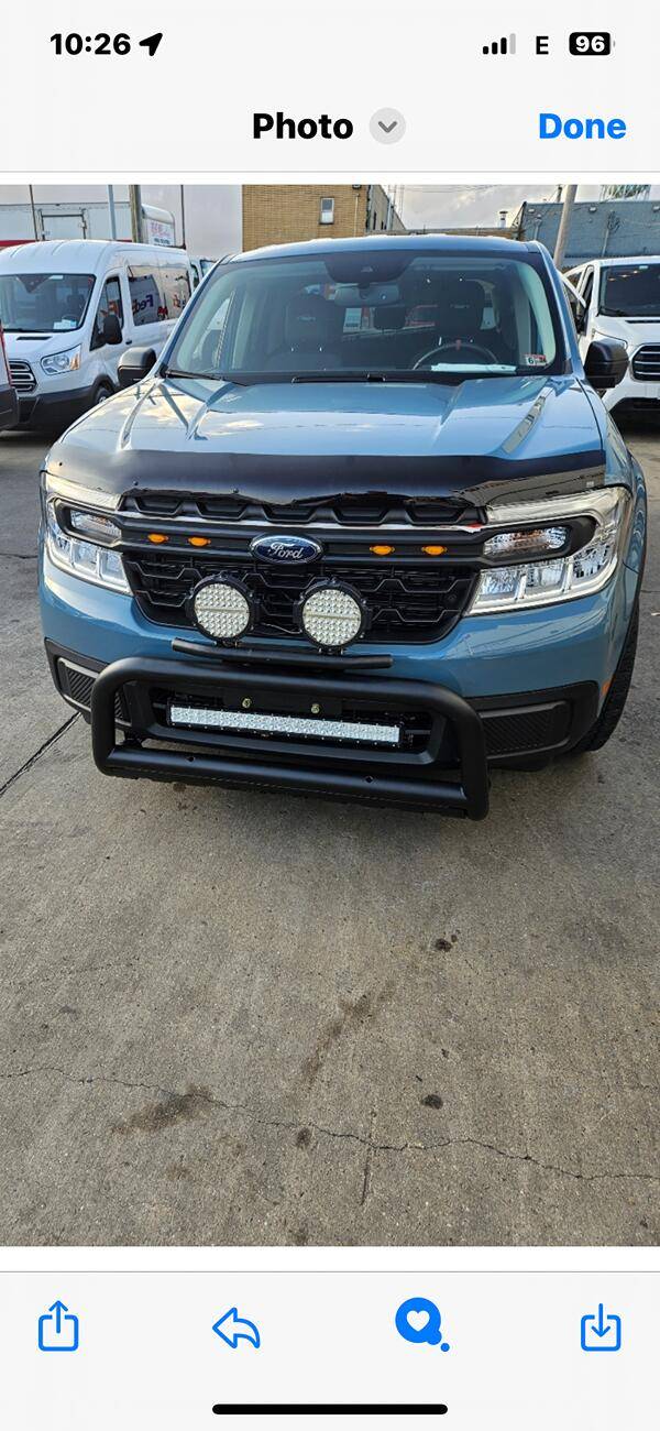

Do you have the Broadfeet bar stacked with that small bar/light mount that mounts where a front license plate goes? If so did you attach thru the bumper to a steel support or did you attach to the Broadfeet bar? Thanks!
I started with the small light bar/license plate holder, with the lights attached to it. I bolted that through the bumper to install (dropping the bumper made install of the raptor lights into the grill much easier, as well, and the lower led bar was added at the same time)
There was no Broadfeet Bar available at the time, so I ran the Mavi that way until I discovered the Broadfeet Bar, and then I installed that.
The alignment of the small light bar/plate holder, worked out perfectly with the the Broadfeet Bar (I got lucky, go figure).
by the way, the Broadfeet Bar really reduces clearance at the nose of the Mavi. It will drag on steep driveways and high curbs, or parking lot stops. It’s not a major issue, just requires a bit of awareness.

Do u remember which Broadfeet bar u used? DC6 or DC8 or another? Looks likee a perfect matchup with the bumper to not block any radar sensors. Thanks

I have the DW8 from Broadfeet
Yes with the skidplate, Nice! Did you ck out the DW6 skidplate model that bends in the middle instead of straight?
