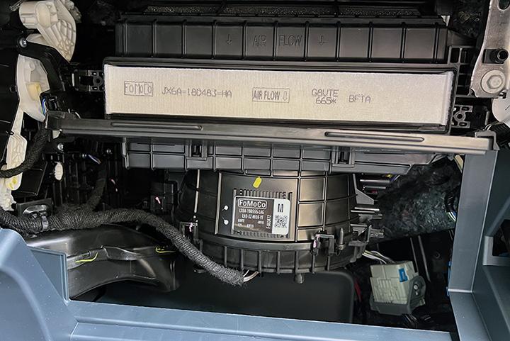

Been having this problem, want to punch a hole in the ducting after the blower fan but don’t know where to drill one. Any ideas?
Did it once last year by going through the drain port on the bottom of the truck but that was a pain in the ass lifting it and taking off all the aero and heat shields.
Ford Maverick Musty smell with fresh air F110B9FB-F6E0-48C1-A2DC-83145BAEEED0

Yup filter, and ducting to filter is good. Reason for punching hole is I'd like to spray expanding foam cleaner while fan is running to get a good cleanse, if I can't find a good spot to punch a hole I guess I'll just route the tube from the filter housing down past the fan and let it drip out that way.
