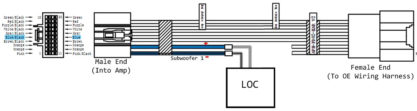

I used the the PAC plug in harness and I have all the wires ran correctly for my amp and my rca converter. I have power to the amp and the controller but I can not get any sound out of the subs. What speaker wires and I supposed to splice into in that harness

I have attempted many different ways to make this adapter work, but I haven’t found a way to get sound to an auxiliary amp. Do you have any pictures on how you wired yours or any other suggestions?

It should be something like this:
Ford Maverick Maverick Subwoofer Upgrade 1668045197153
(Edited to make line converter wire input color clearer.)
