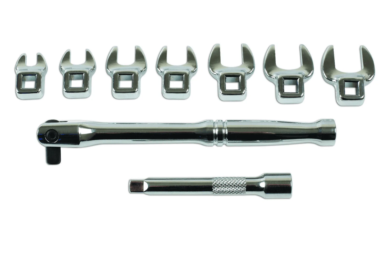

How would you torque that, other than just by feel?
Put one of these on your torque wrench, and calculate the effect of the offset. My torque wrench came with an offset chart to make it easier.

good call, my brain is not working yet LOL

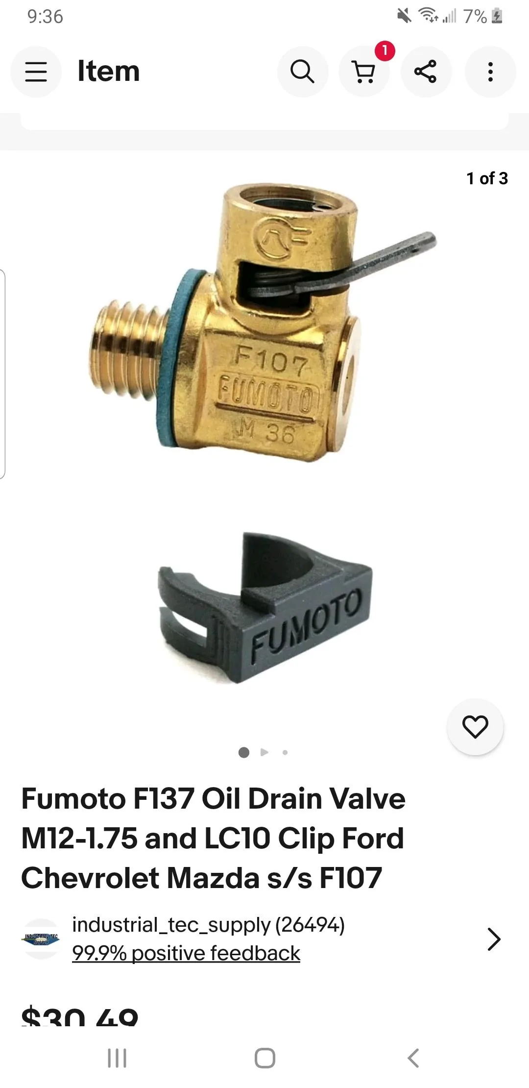

Gonna pick one of these up for my Maverick to replace the oil drain plug. I have one thats been on my 1994 Silverado since the truck was new. Swapped out the OEM plug for one on its first oil change. 29 years later no problems. It's great. Spring loaded detent, and stainless steel ball valve. No more 15mm wrench needed. Slide the pan under, and open the drain valve. When done turn the valve to close it. The lever drops into a spring loaded detent that's fairly hard to open. Vibration is not gonna pop it loose. The newer ones do have a plastic safety clip though for extra insurance. You can also get these with a hose nipple on it if you want to route an actual hose off of it. Fumoto Engineering. This same part number fits my wifes impala. I may have to get 2 of em. Fumoto recommends their bolt torque on these. They stated that stock drain plugs are torqued in at a higher value and that would damage these. The maverick fumoto valves are to be torqued at 15 foot pounds.
I remember seeing a video where someone wanted to use one of these drain valves, but was thwarted by the geometry of the oil pan around the drain plug. You may need to get some sort of extension.
Ah... Found it. It was Cuban Redneck on his video about doing an oil change on his EcoBoost. Here is the timestamp when he mentions the issue and mentions the needed extension:
They make several different types of this valve including a brass extension. My wifes impala takes the same PN# , so I am going to get one for her car as well.

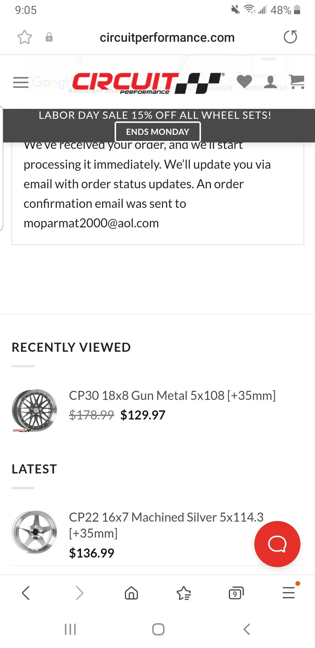

Checked w circuit performance last night. They are having a labor day sale. Turns out the CP30 rims I have in gunmetal grey in 18x8 are on sale and being discontinued. I put one in my cart to have a spare wheel just in case something ever happens to one. There was only 1 left in their inventory. So I bought it. I will just leave it in the box and store it in the loft of my shop.

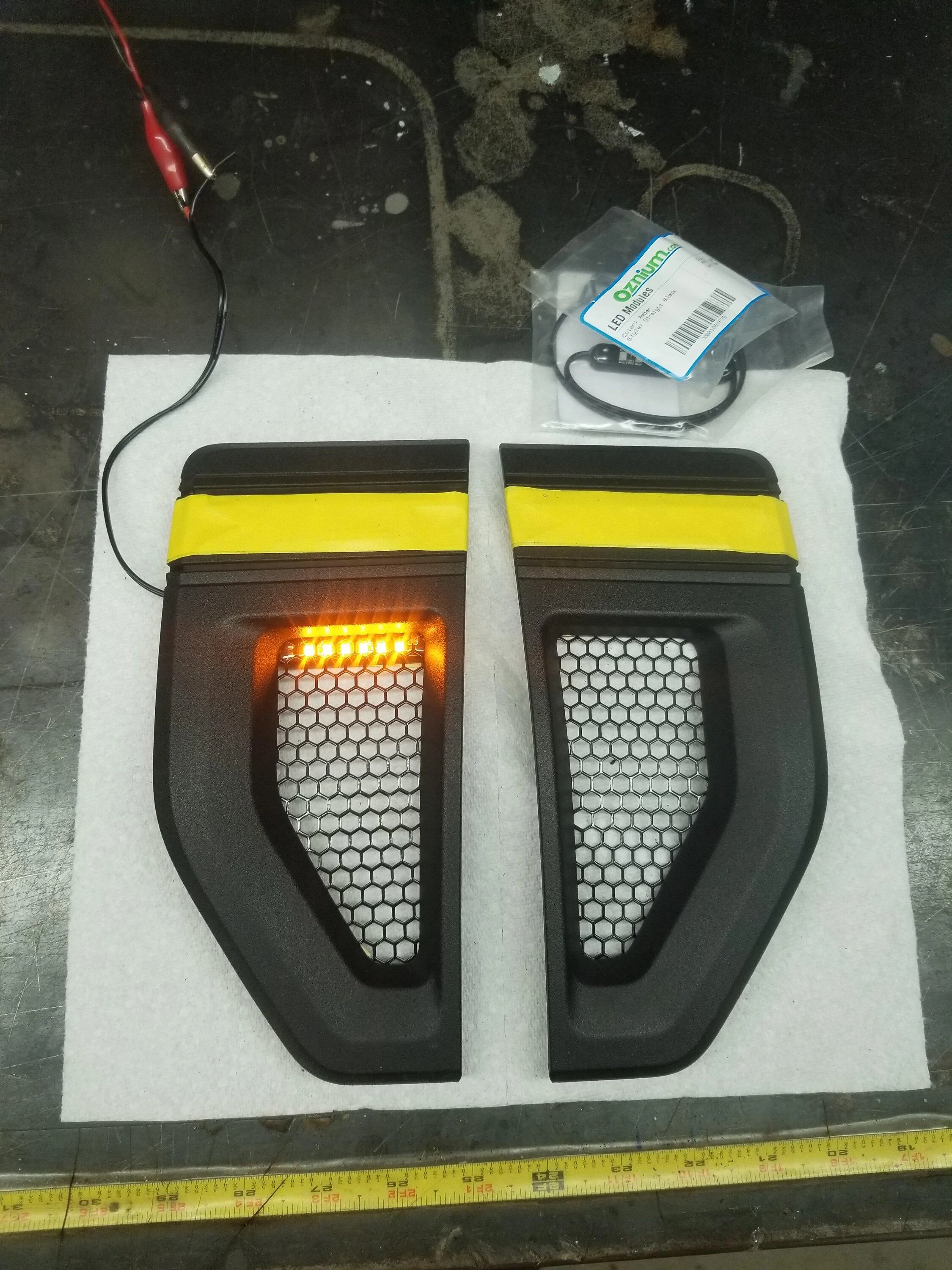

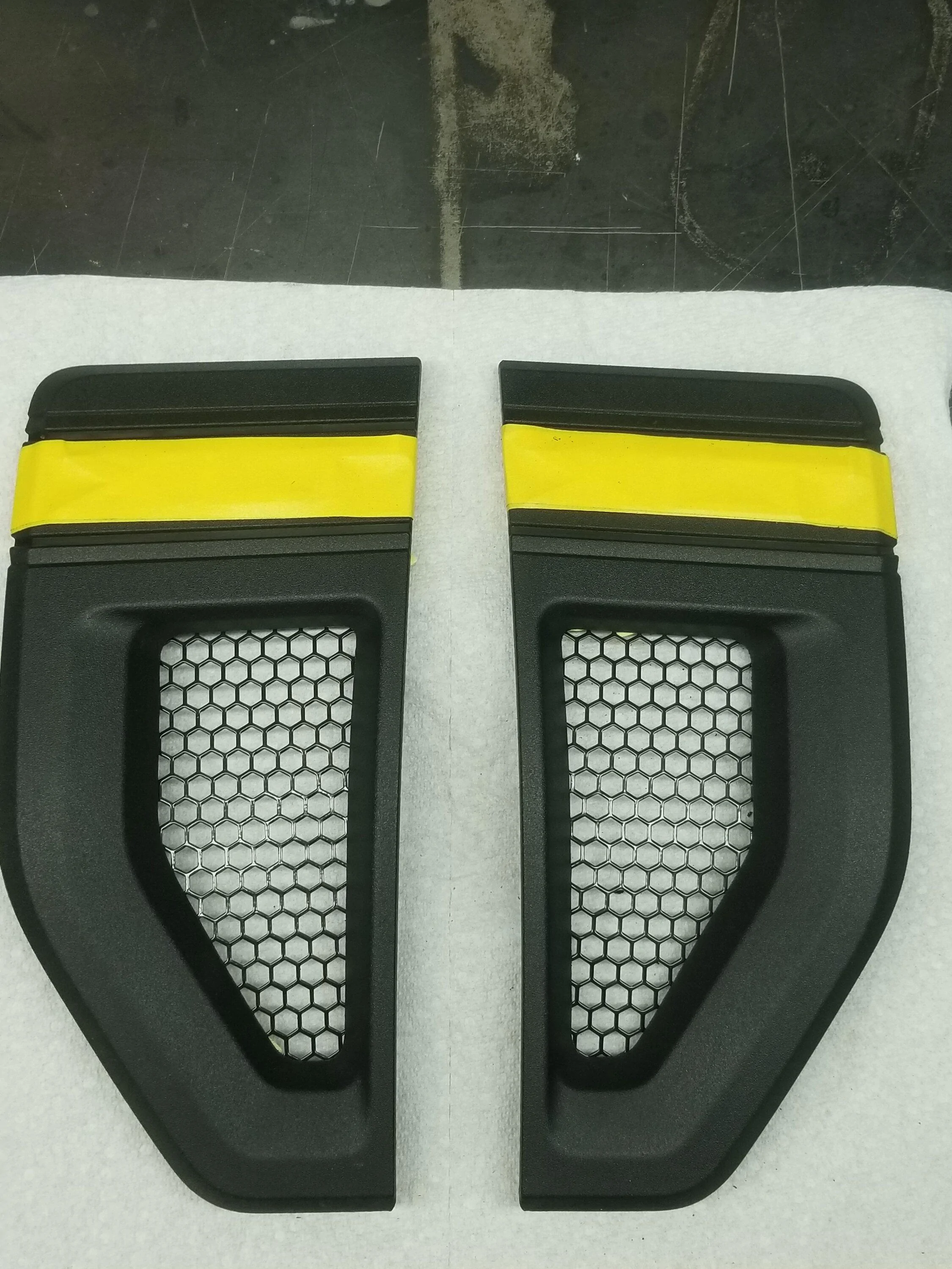

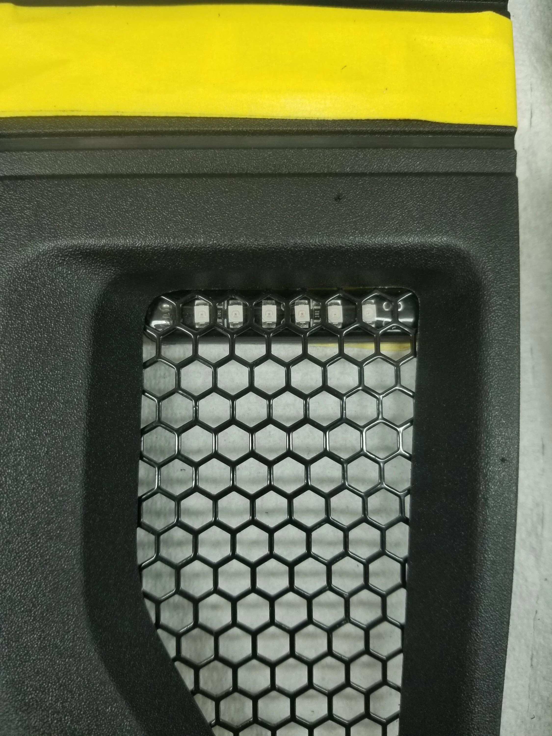

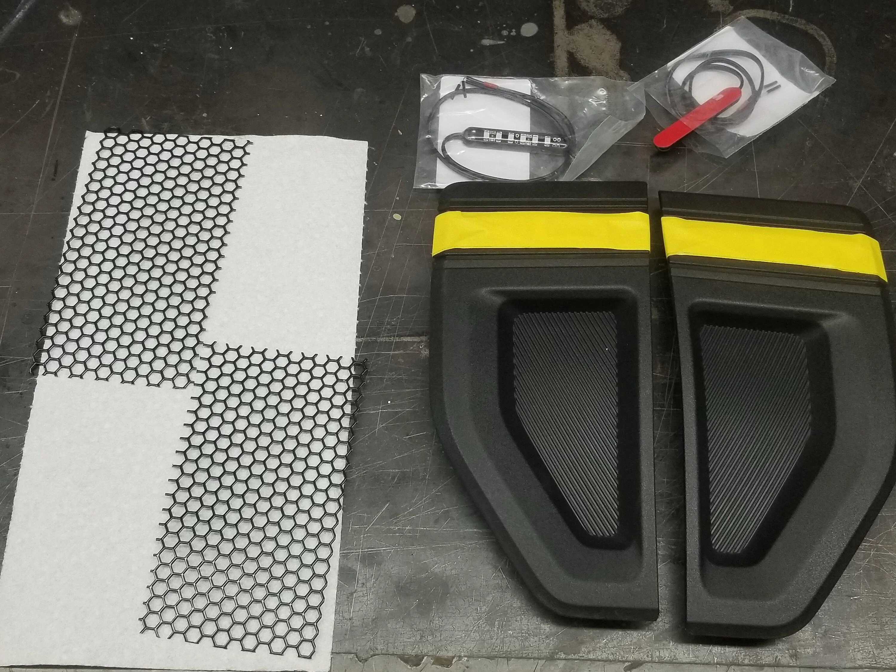

Well I havent been to this thread in awhile. Modding the fender vents and adding in hidden side mount turn signals.

I'd like to see photos of your modified side vents installed on the truck when you get a chance...

Back on shift for the next 8 days. I prob wont post up pix until the end of next week. I still have to glue the screen in, and make the mount brackets for the lights.
