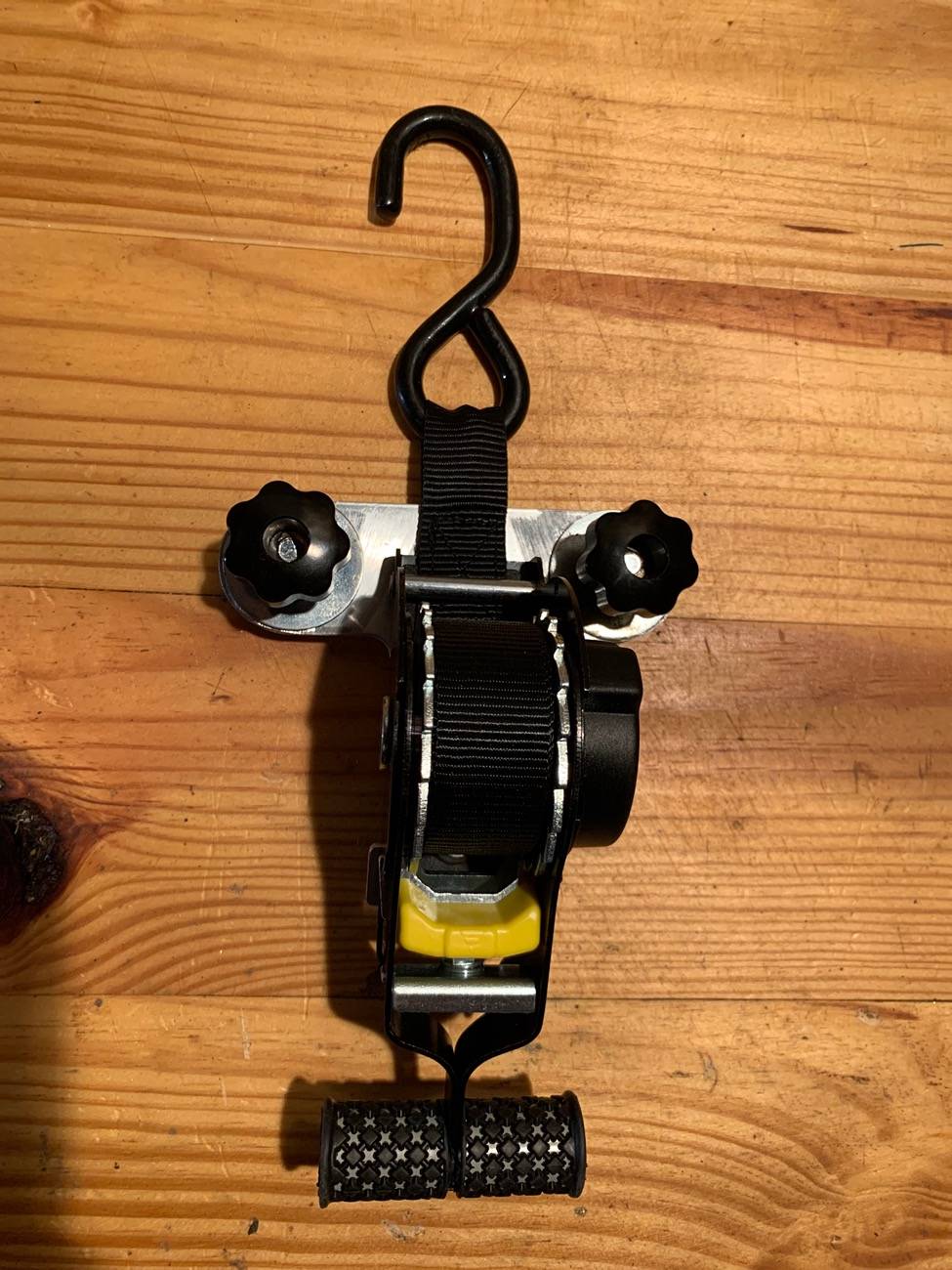

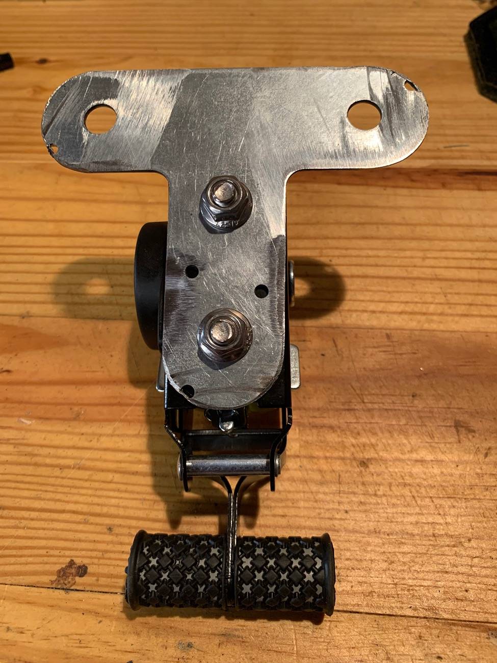

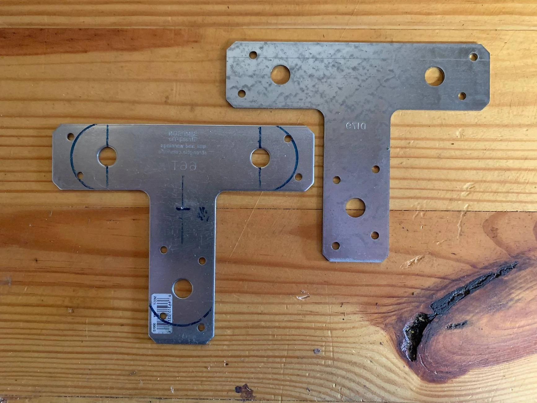

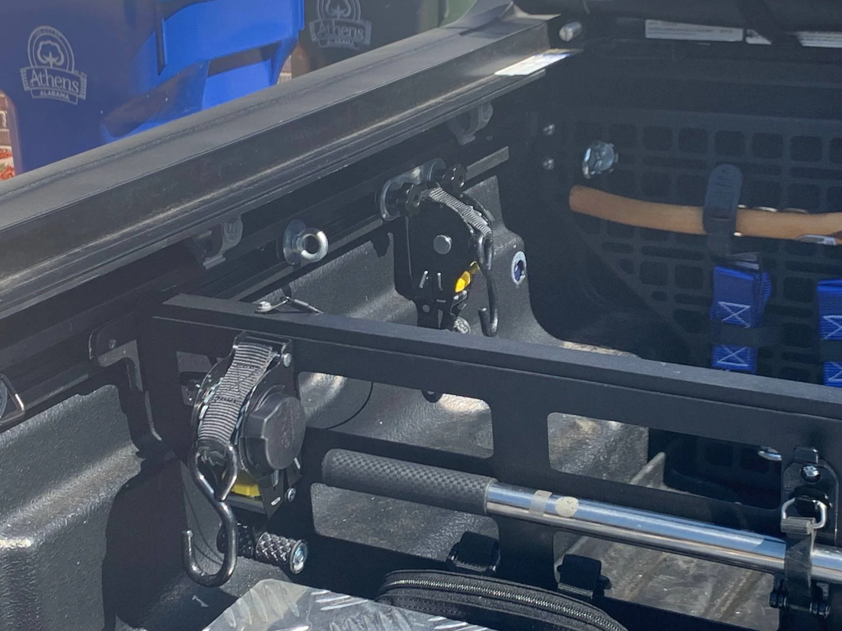

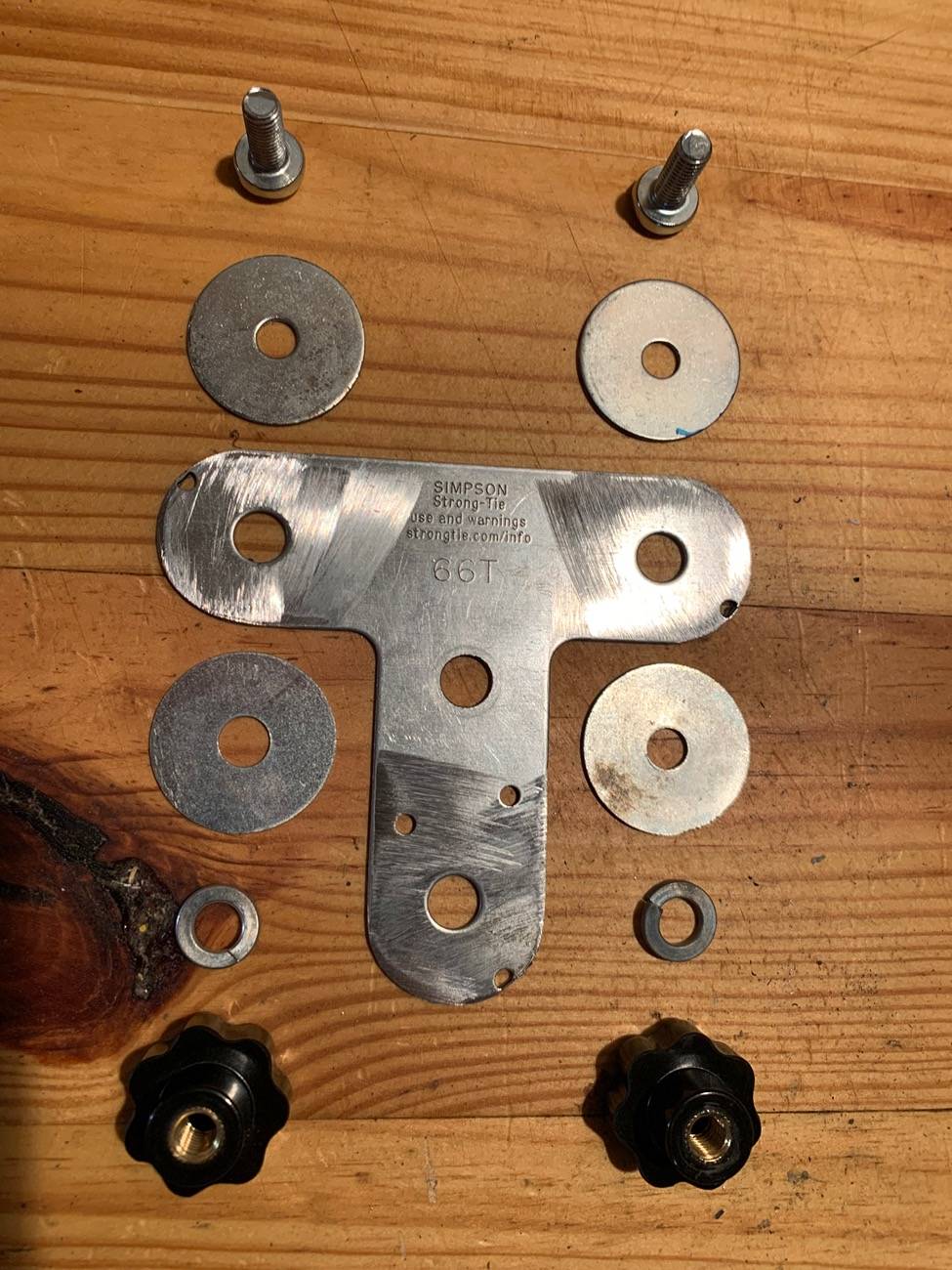

OK, I understand the forthcoming Mabett ratchet straps are designed to be fixed in one location, high in the rear corners of the bed. I modified a similar set to enable them to be positioned and locked anywhere along the side rails. The attached photos should be self explanatory. The start point is a T construction tie from one of the big box stores.
I actually have two pairs of ratchets in my Maverick’s bed. The first slide and lock along the length of the side rails. The second pair’s are mounted to the upper corners of my Mabett sliding bed divider. They partner with several DIY anchor points I added to the bed’s front wall.
