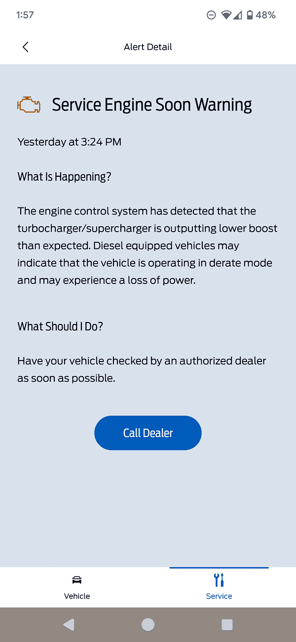

Anyone else get this CEL ?
Ford Maverick Low Turbo Boost Fault Code - Screenshot_20240701-015736

Do you have an aftermarket intake or a catch can? Intake or egr leaks can cause this but it's usually an issue with the turbo or pipes.

Nope all stock. Goes to dealer tomorrow morning.

Dealer says the Turbo/By-Pass BOV- Is faulty and is being replaced- Yay more boost- Interesting I wonder how long it's not been holding enough pressure ?
