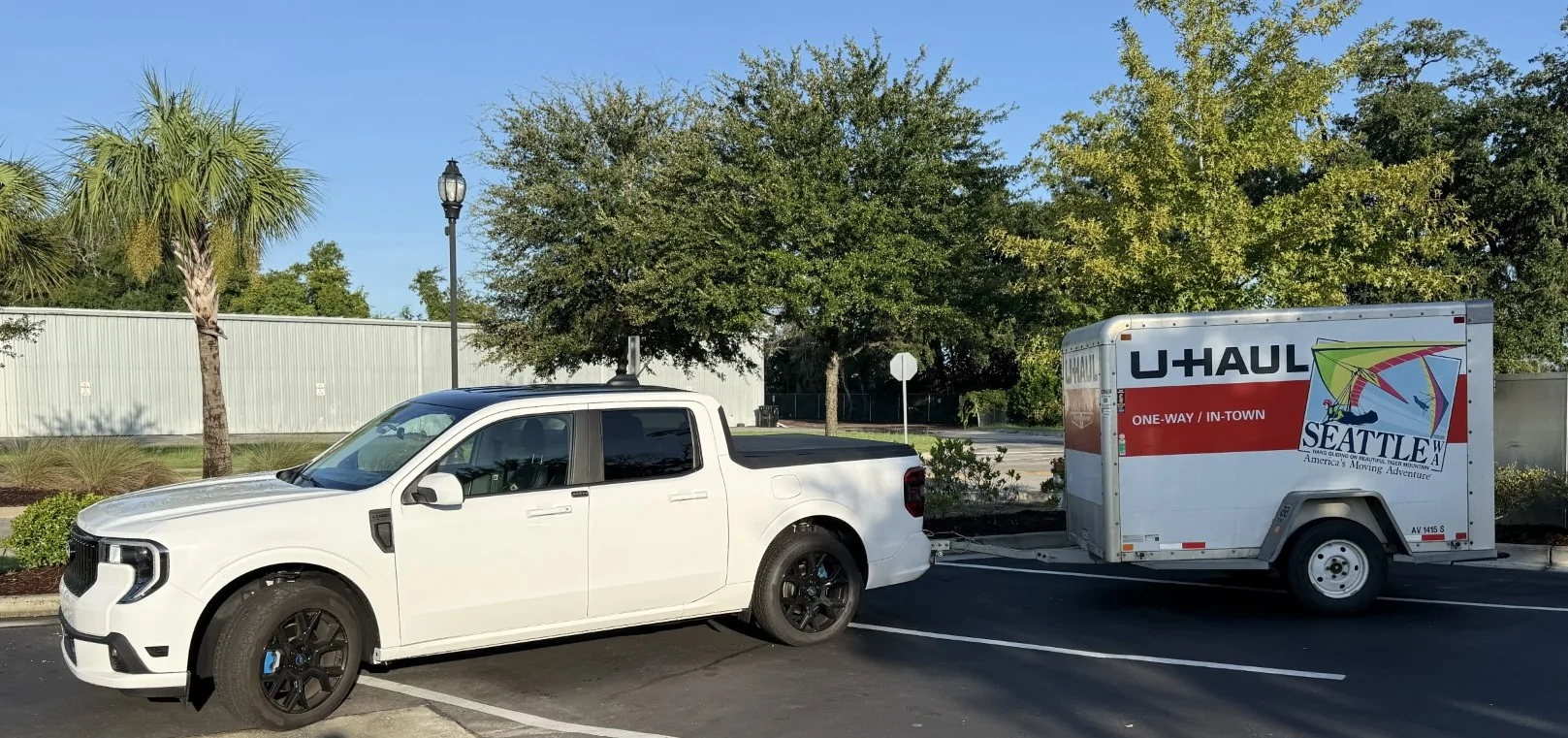

I’ve towed a uhaul motorcycle trailer with a 99 Kawasaki zrx1100 before and have put 18 bags of mulch in the bed on a different occasion and it was just fine. I don’t wanna do it often for a few reasons but wouldn’t be afraid to either.

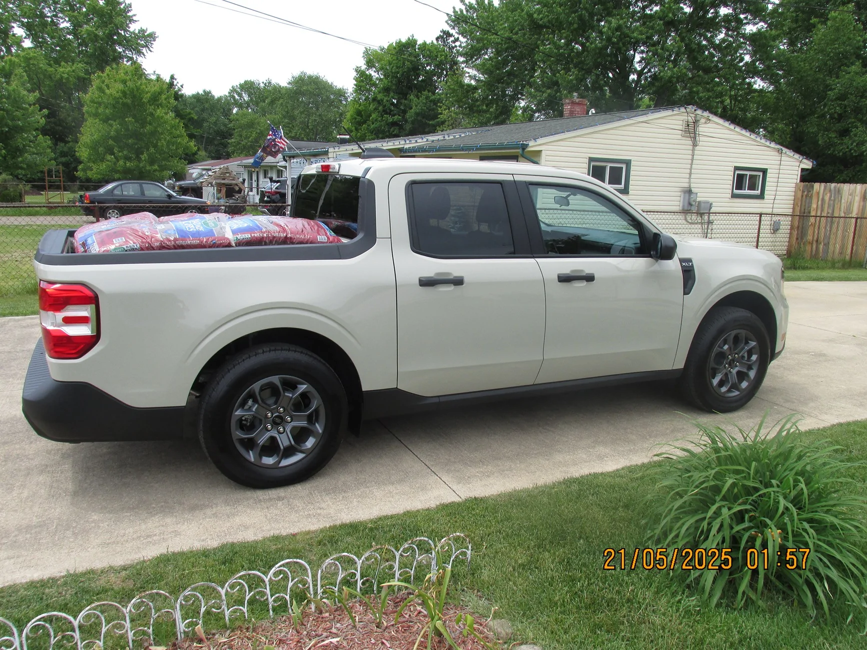

I don't have a Lobo but hauled 30 1.5 cubic feet bags of mulch in my Maverick!! Just curious what's the payload rating on your Lobo? Mine's 1,491 lbs!!

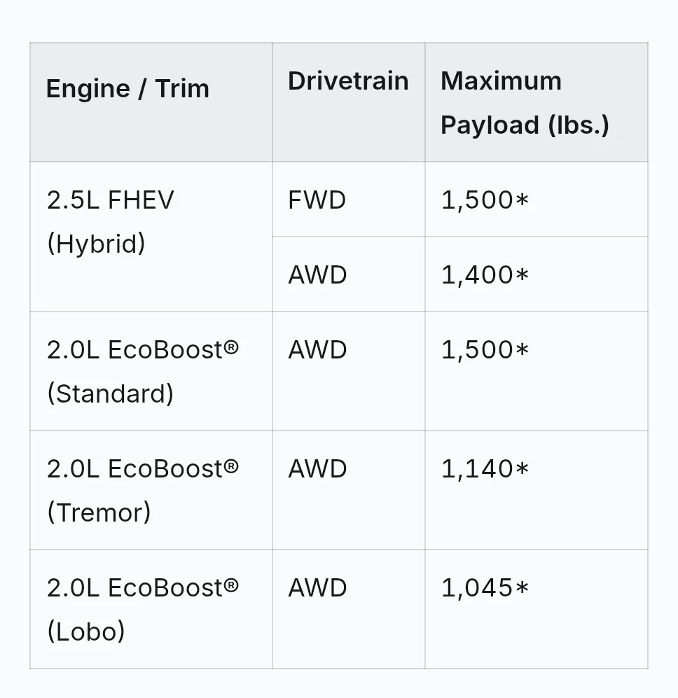

There is no need for this chart. Your exact payload is on the sticker on your drivers doorjamb.
BLUEOVALRACER was curious about the Lobo. I shared the chart differentiating the other trims as well.

Thanks, your chart showing 1,500 lbs. For the 2.0 EB was very close to mine which is 1,491 lbs. and gave me a general idea of the Lobo's payload!!

1140 max payload
2.0l ecoboost Tremor

Looking at the payload chart above, it looks like it's the suspension that changes the maximum tow rating, probably because it's softer (Tremor) or lower (Lobo)
With airbags in the rear coils, you'd probably eliminate the squat when loaded but keep the Lobo-specific rate when you're not

Payload yes, but towing is different.
