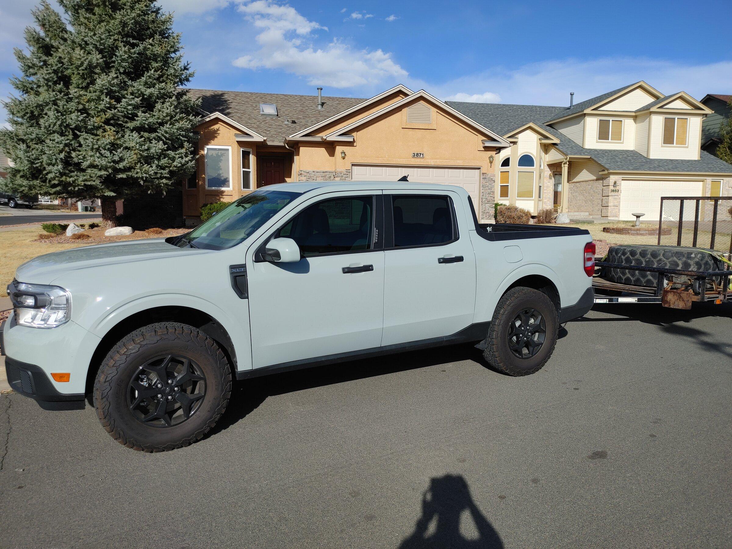

Had mine since Jan. Lifted right away, 2" level lift by FordRangerLifts.com. Stuffed 255/75R17s on it. Been getting about 23.5 mpg (25.1 before lift/tires). Rubs a tiny bit on the inside firewall at full lock still after some trimming of the pinch welds and fender liner. Can still u-turn and get around with ease. Overall enjoying it!

That's awesome!! Did you do the lift yourself or you know...?
Edit: Love the tint too!!

Looks good. One question, do you need to adjust the aim on headlights after lifting? Doesn't this put them above the legal focus distance

Yes, and I did. It was quite easy as the adjuster screws are right on top and easy to get to. The crisp LED cut off line was nice to get accurate and even adjustments.

Thanks. Glad you did that and told the process for others to follow.
