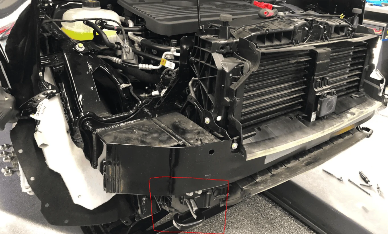

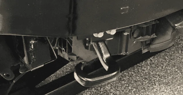

That will work on a Ranger or F150 but not the Maverick, at least not on the actual tow hook locations.
The F150 and Ranger have the bolts to attach their two hooks running vertically (up into the frame), the Maverick has them horizontally into the sub-frame. Here's the best image I can find of the Maverick/Bronco Sport Tow Hooks.
You can see, they bolt in horizontally to the vehicle, not vertically like on your Ranger. (Bronco Sport pictured, same concept on the Maverick)
Full image:
Of course you can always mount the bracket you shared anywhere else that you'd like, doesn't have to be a tow hook spot as intended. I'd still like to get some kind of bracket like you pictured, I definitely don't want holes in the plastic bumper cover if I can avoid them.

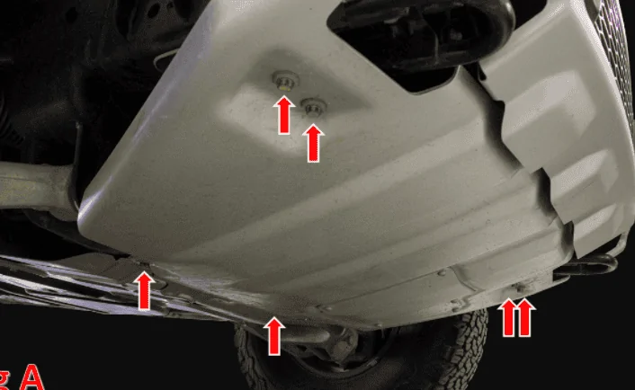

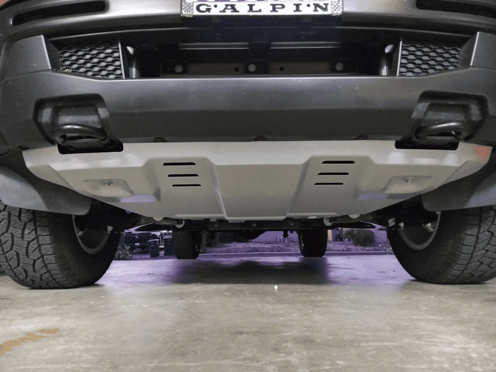

Actually looking at that bracket, it probably won't work on your Ranger either. It looks to be made to bolt up where the skid plate is, not the tow hooks. Which on the F150, you need special brackets to fit that Raptor skid plate on a non-Raptor, not sure how the skid plate looks on the Ranger.

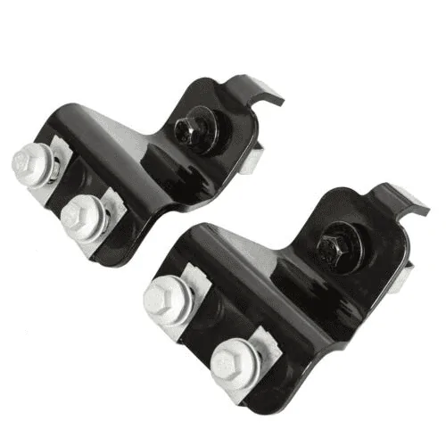

These are the brackets you'd need to bolt that license plate mount to your actual tow hook locations on an F150. Of course you'd only need one for just the license plate bracket.

Looks like Ranger only has one bolt each side on skid plate, whereas the Raptor has two like the bracket you pictured.
Full image:

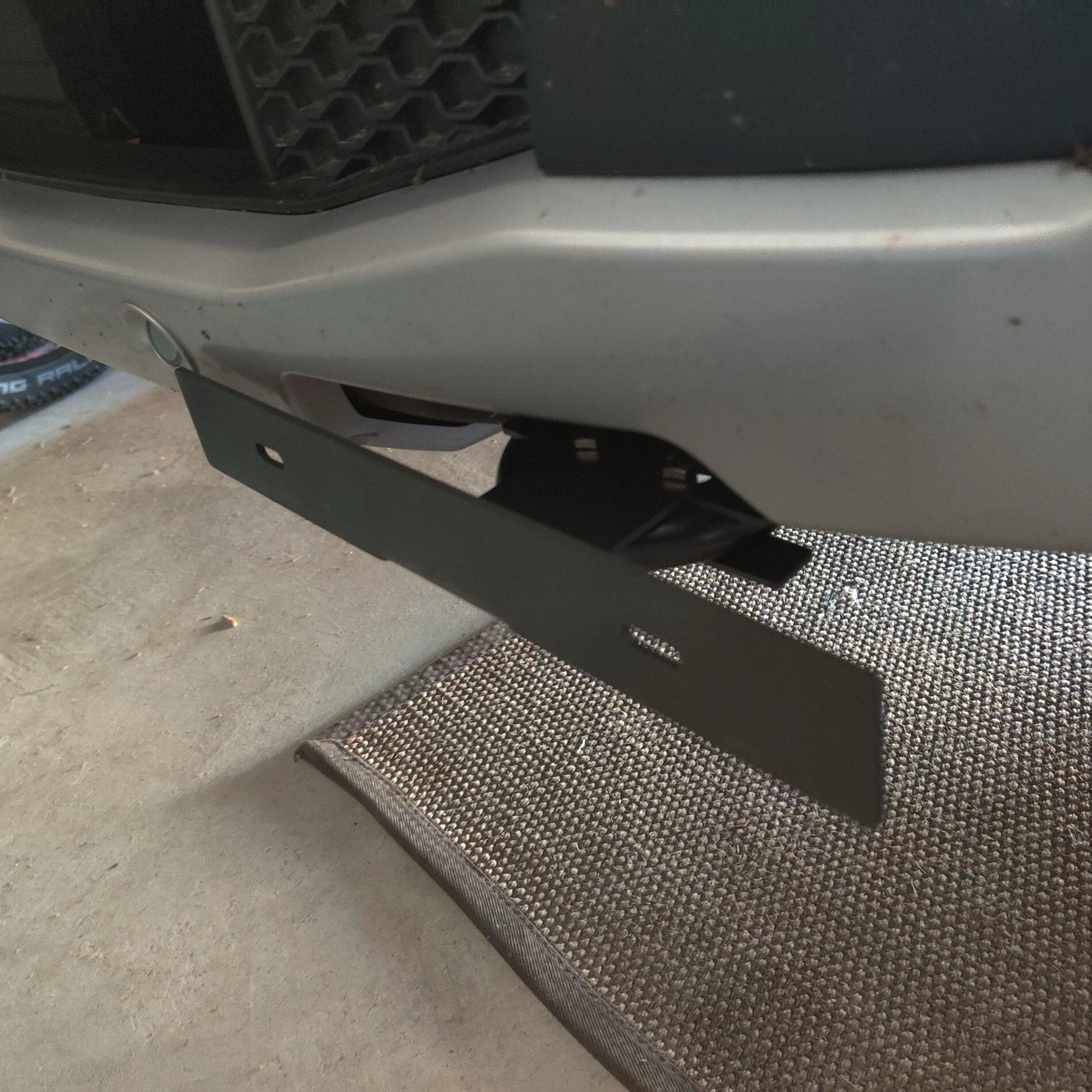

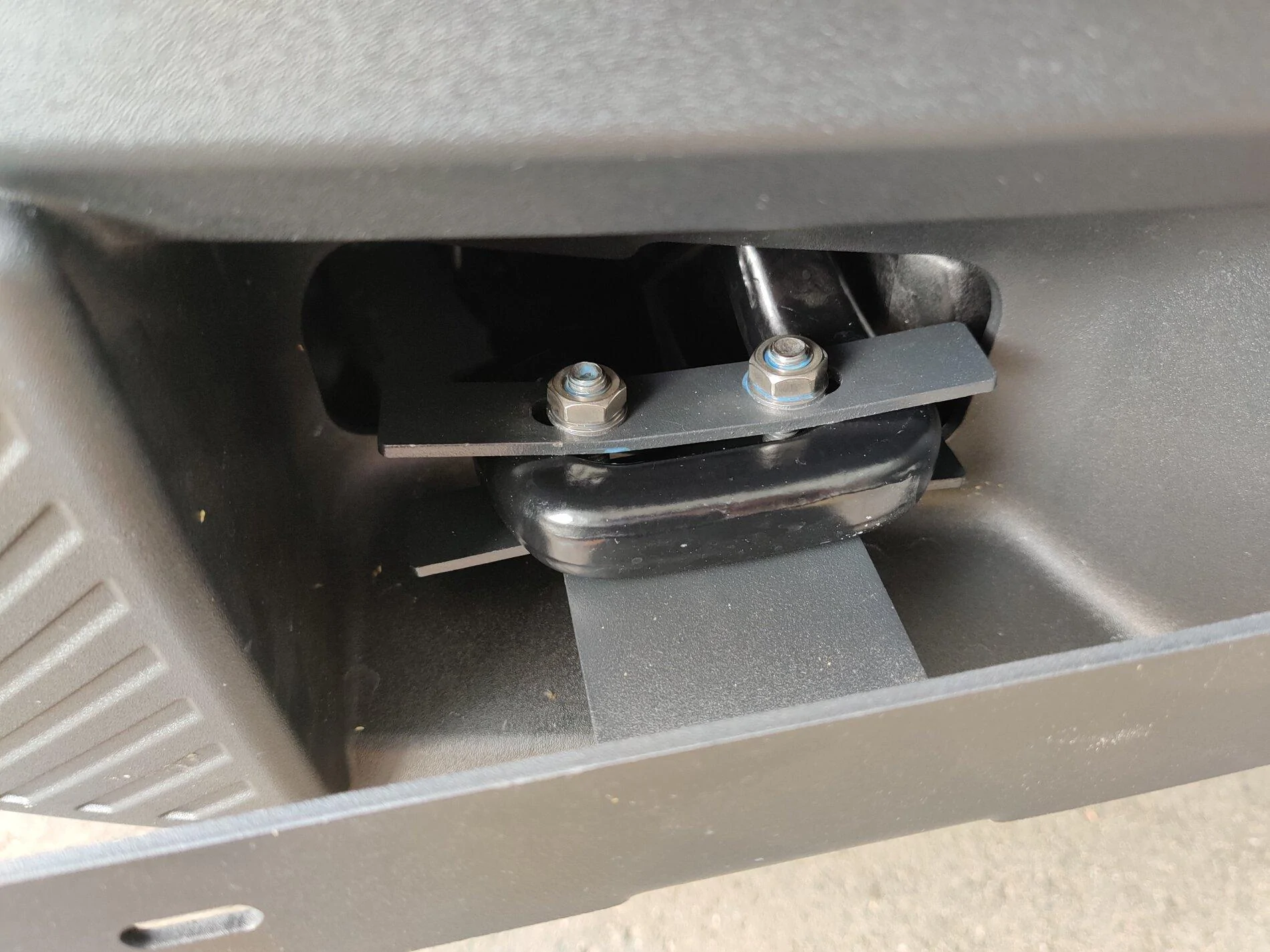

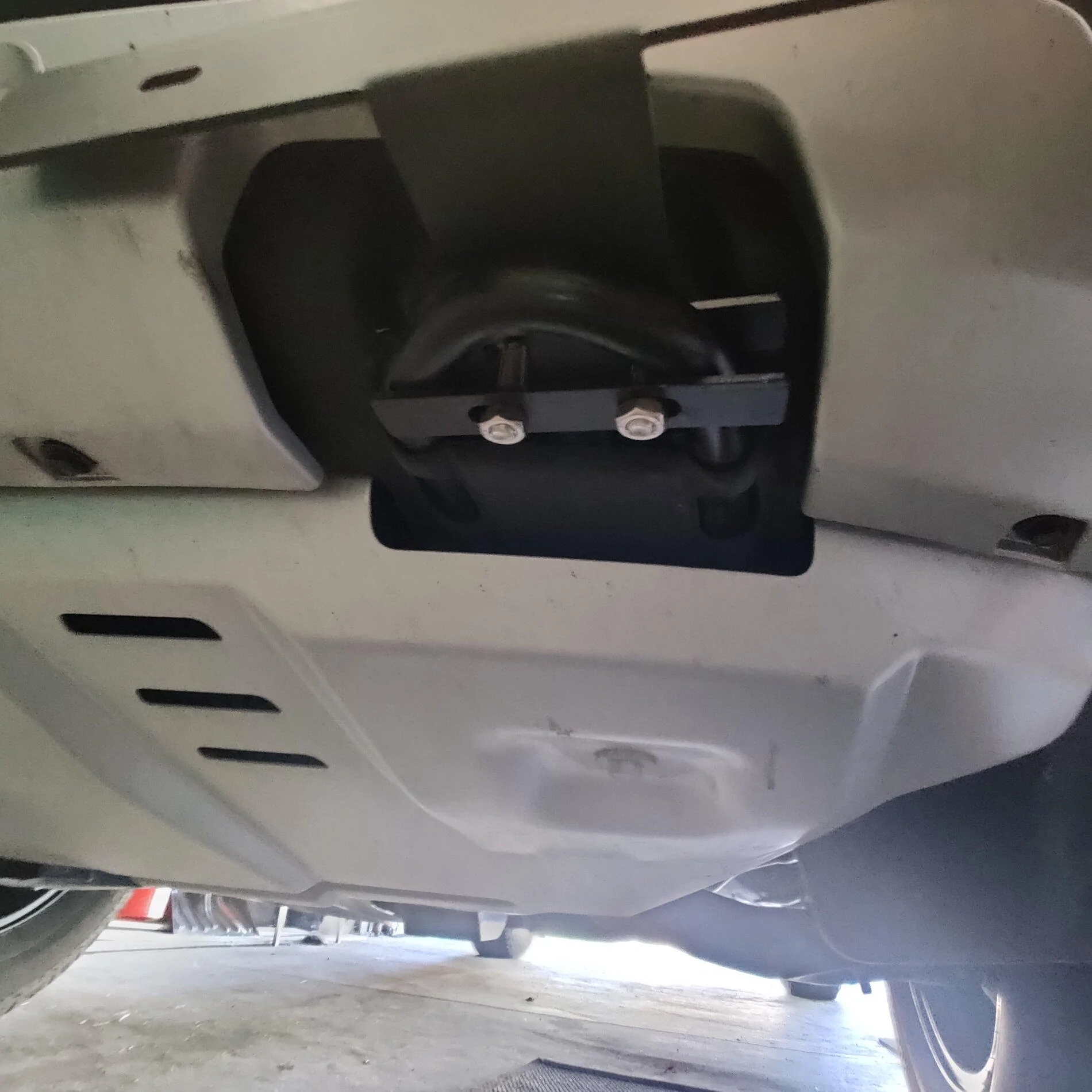

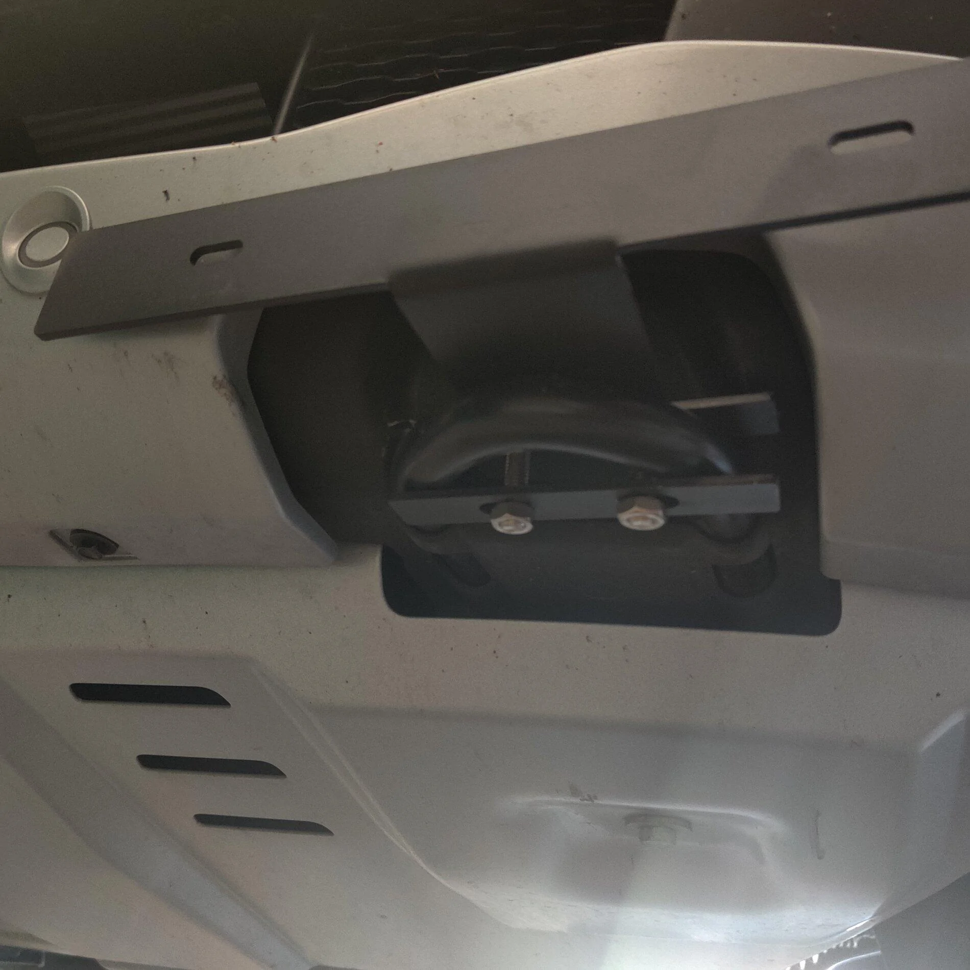

I think you are missing how the bracket I linked to works? You use the bolts through the tow hook itself, bolting two plates through the hook on the outside of the hook.
Anyway since it was Amazon and I could return them, I went ahead and bought them. They work as expected in my ranger, and I think they will probably work on the maverick too. Might be a slightly tighter fit given the hooks on the fx4 are a little recessed, but if the money I'm going to keep the bracket and give it a try!
Posting pics of it on my ranger in a minute...

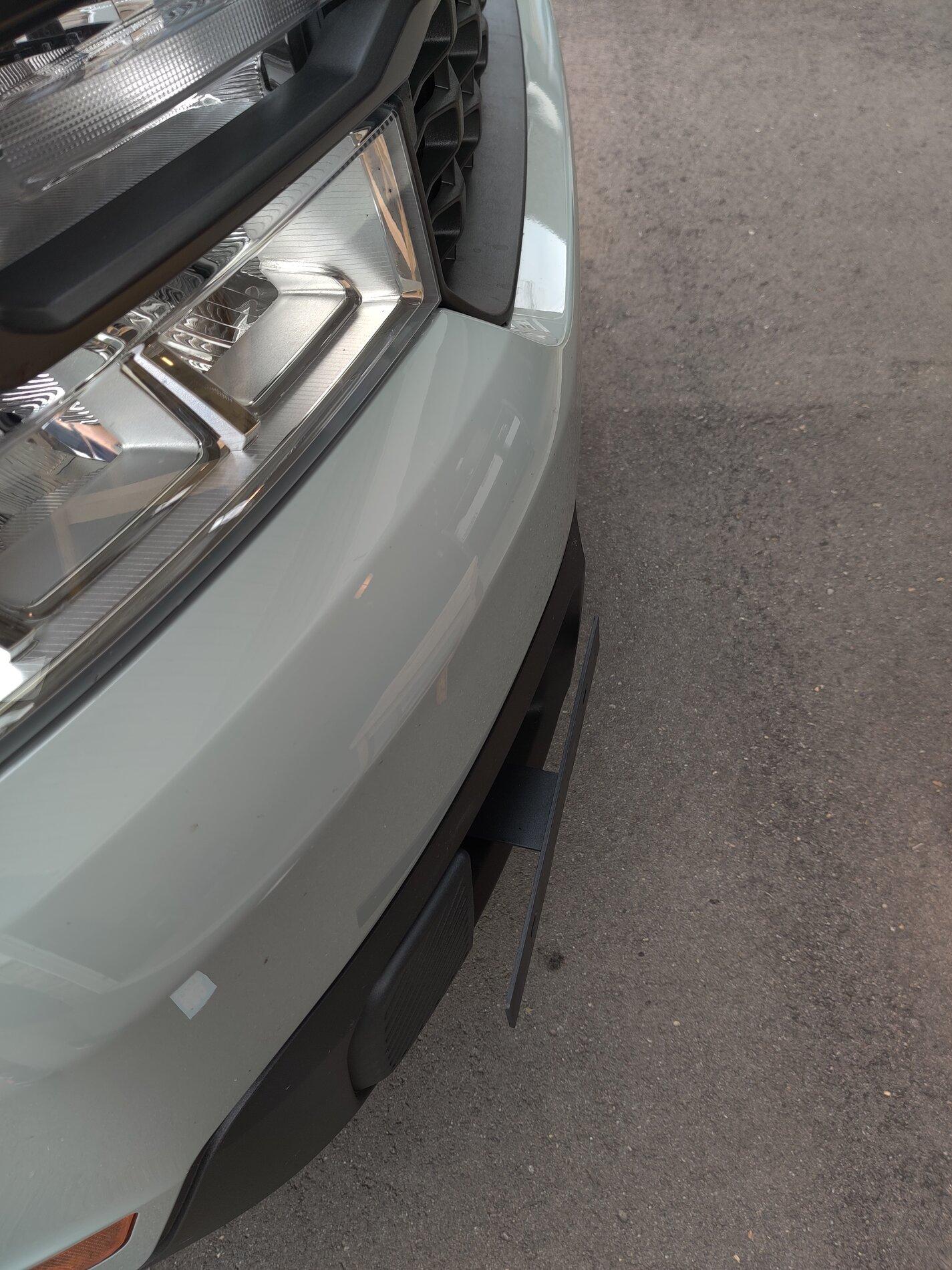

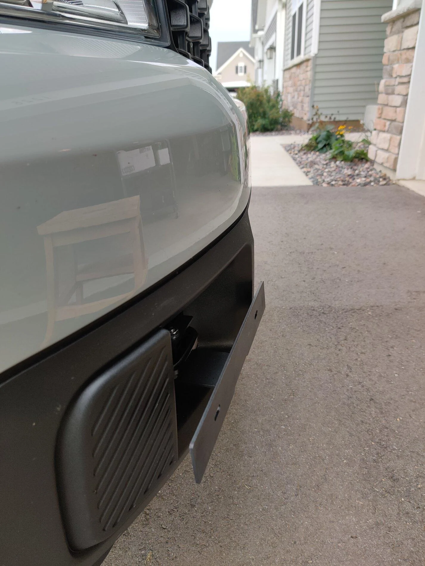

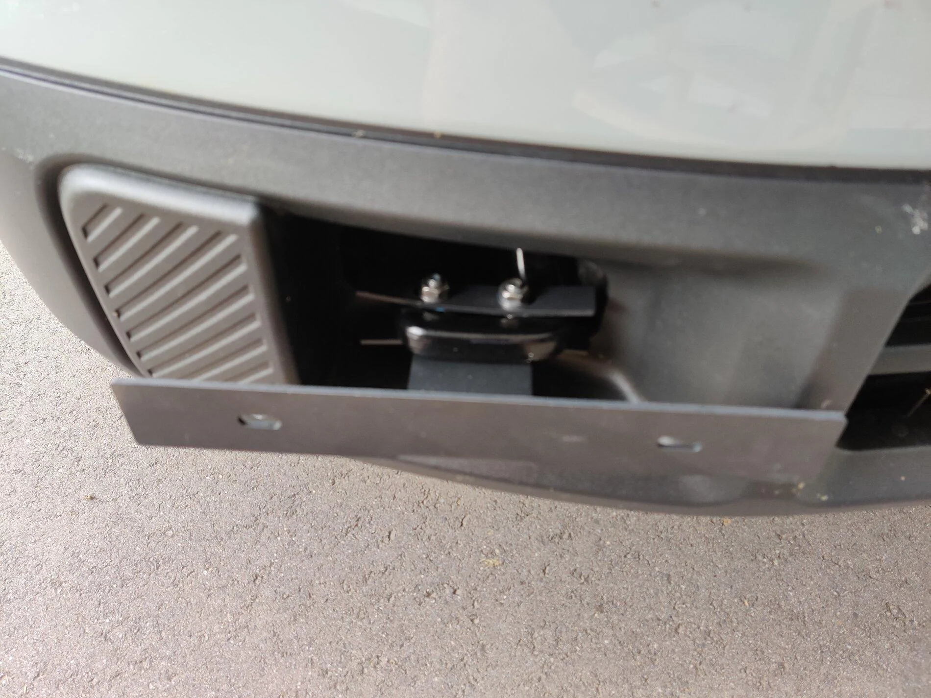

Ta-da!
Ok, so this does work technically. Well enough that I am going to stick with when I get my plates in a few weeks.
The Maverick hooks are different from the ranger, in that the hook is open ended. however, it curls in on the open side more than enough for me to be comfortable using the linked mount from my original post.
Also unlike on the ranger hooks, the hooks are too recessed for the plate to display square to the truck, however it is only at a slight angle. Not enough for me to think it will look odd one mounted.
