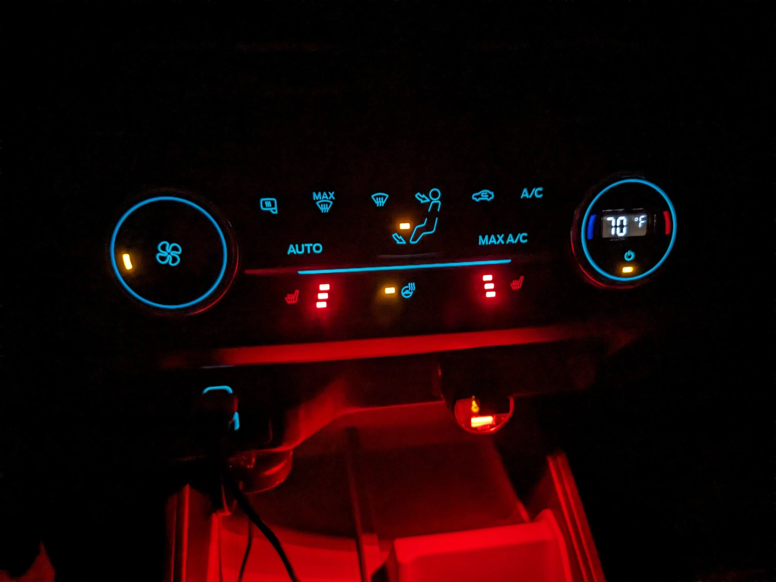

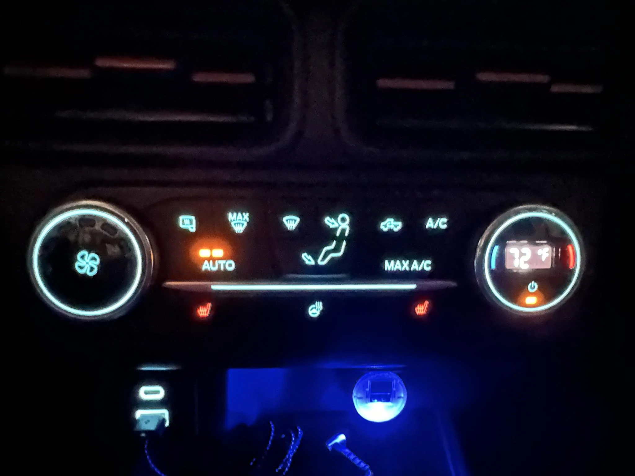

Okay, @Automan21, I have something for you. I have two menu items in the instrument cluster related to climate control using remote start. The first is likely what you've said you have called Climate Control. The second is called "Seats and Wheel" and lets me set them to auto or off. It sounds like you need that menu and to set the seats and wheel to off. Here is a pic of the dash.
Ford Maverick JOB1 Climate Control Swap Question/Help Seats and Wheel Auto Climat
I also captured a screenshot of the HVAC module in case it helps. Here is my as-built one.
Ford Maverick JOB1 Climate Control Swap Question/Help Screenshot 2024-03-05 211822
Here is a screenshot of the IPC of the (potentially) relevant entries (i.e., "Remote Start").
Ford Maverick JOB1 Climate Control Swap Question/Help Screenshot 2024-03-05 212416
And finally, here is a non-as-built screenshot of the HVAC options. (The mouse hover blocks an entry for "Heated Windshield".) Note that, although I have heated mirrors, both seemingly related entries are not enabled. I believe that's mentioned earlier in this thread.
Ford Maverick JOB1 Climate Control Swap Question/Help Screenshot 2024-03-05 211700
Hope this helps.
Hope this helps.
That did the trick. Had to go in and change the settings on the heated wheel on remote start.
thanks again!

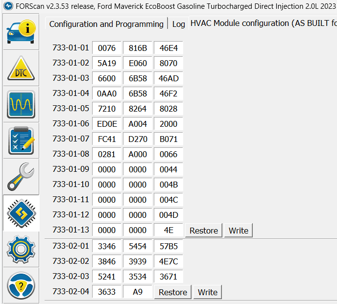

First, a big thank you to @Redneck Garage for his video on changing out the climate controls. I just did this on my Tremor today.
As they do require some tweaking via ForSCAN, I wanted to see if I could get some help on something.
The AsBuilt on the Tremor before making changes with the factory JOB2 controls:
Then I swapped the controls for the JOB1 version and used the AsBuilt values from my 2022 Lariat Hybrid:
Everything seems to work fine. AC button, heated seats, wheel, mirrors, etc. But I am being OCD :)
I got a checksum error on 733-01-08.
My ask is if someone can share their AsBuilt data for a 2022 EB Lariat with the JOB1 climate controls for comparison, and most notably what is 733-01-08 on those?? But if any values differ from above, I am interested to know which ones.
Also, on the HVAC values, there is one for Engine Type that did switch to Hybrid after this was written. I set it back to Gasoline and wrote it, but it did not change the values from what you see above.
[EDIT]
My first image with values is all 0000 and FFFF for the first 2 columns. I am not sure if that was ForScan being weird or my Tremor is out of whack as I checked the AsBuilt values, and they were definitely not that way.
I manually set the original values from the AsBuilt data on the Motorcraft Service site, then compared to the VIN for a 2022 Lariat AWD model I found on Carvana's site.
The items highlighted are the only values that differed between what should have been my AsBuilt values and the 2022 Lariat AWD with the JOB1 control values. This time they wrote successfully, too:
