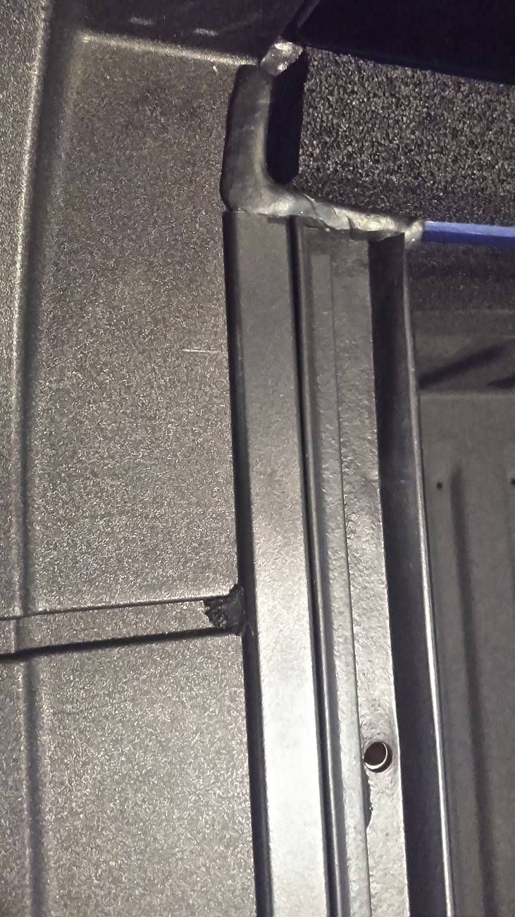

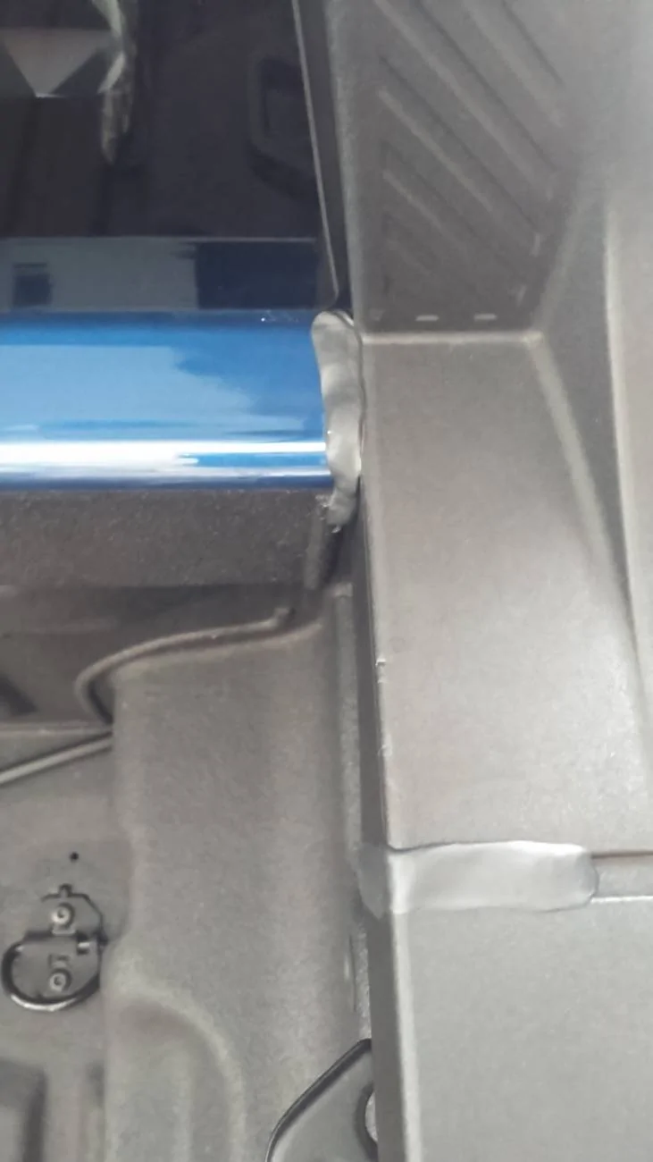

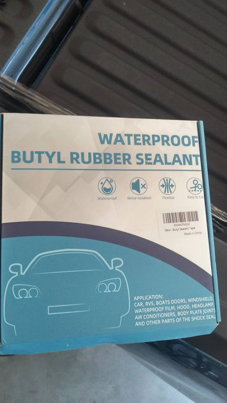

I used butyl rubber tape to seal the areas, Had to remove my cover again today to add a little more at the cab area. Here is a couple of pics. Tried foam sealer but foam is a sponge.
Thanks for letting me know, looks like you also did that area between the lip under the rear window and the side of the bed rail, thats good to know. I am going to order this material on Amazon now.

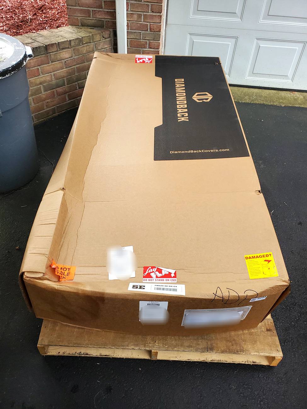

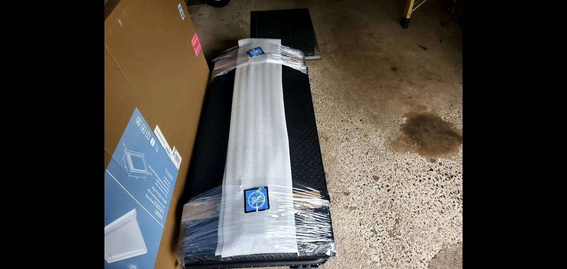

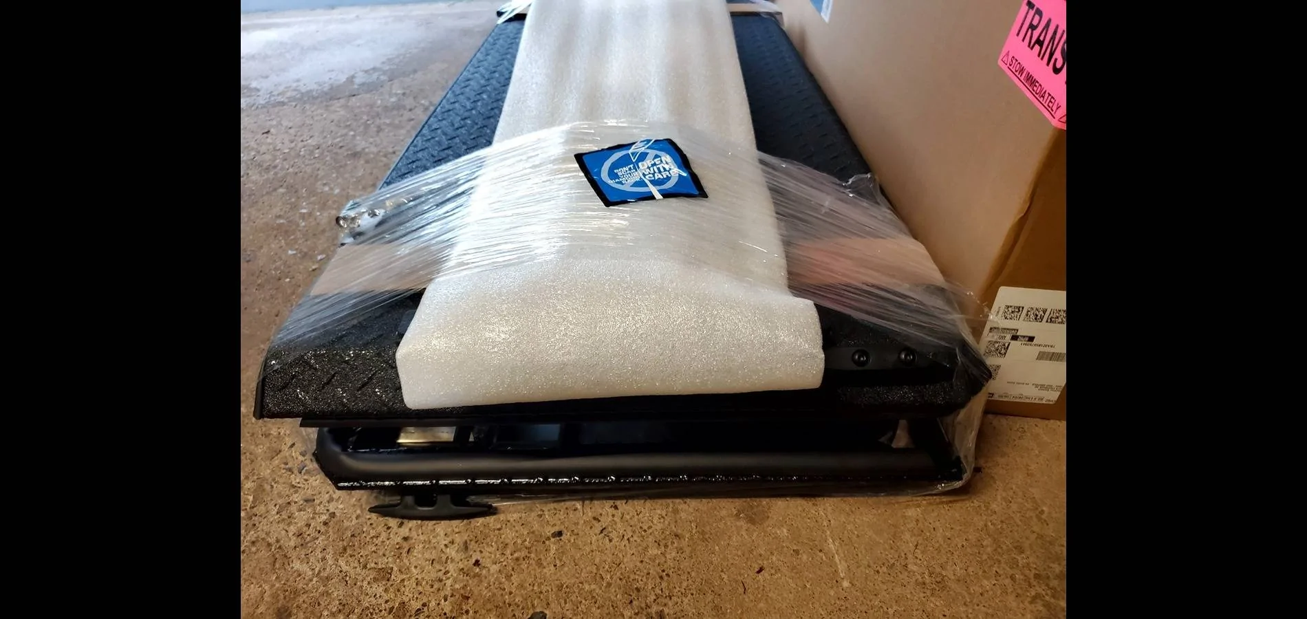

Also my Diamondback Cover came in, everything looks good. I couldn't install it yesterday due to weather and manpower shortages, it's probably won't be installed until next weekend at this rate but here are some photos...

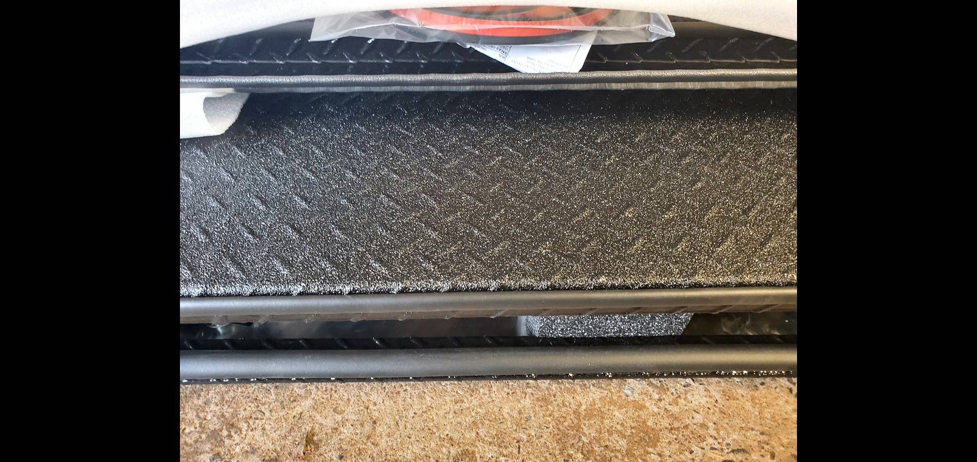

Some additional photos of it unpacked, the box looked bad but the contents were undamaged. In the 3rd Photo you can see the gasket kit I ordered separately from Diamondback that provides a seal around the tailgate.

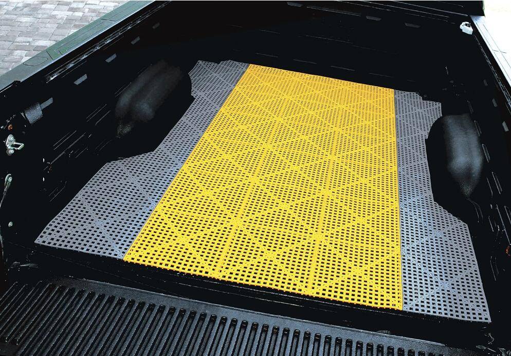

I was also considering one of these for minor, rare leaks at edges of the bed:
Ford Maverick Is the Tremor right for me. Screenshot 2025-07-10 085928
https://www.amazon.com/Dri-Dek-Pick...ocphy=9009782&hvtargid=pla-2281435176698&th=1
I figured a rare, minor drip would go between the grid and head for the drains in the bed, keeping the cargo dry. Just a through but I was going to see what this Diamondback cover can do before doing anything else, I figure if it can keep the bed dry when I go through the touchless car wash it should be good.

That's good to hear, I should be receiving my butyl rubber sealing material on Saturday, I will be using your photos as a reference where I should be sealing my bed. Also if you wouldn't mind, do you have the dimensions on those totes? I was thinking of doing one big chest style one for myself but I am open to other configurations too.

I filled the gap in the side rail with the butyl tape. Originally I had used weatherstripping to fill the gap under the cover rails. It acted like a sponge so removed and used tape. Tehn water pooled in the gap that wasn't filled so removed and added tape all the way.

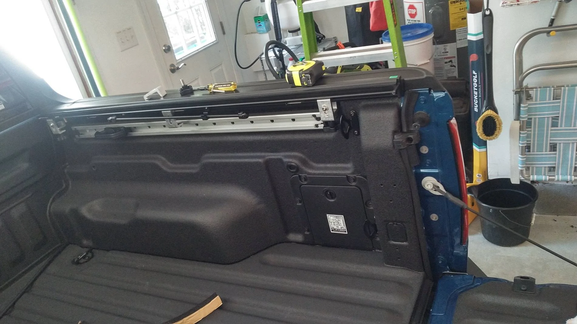

So I managed to get the Diamondback cover on this weekend, it was a bear to install, even with 3 people. Not only that but I didn't get the seal compressed enough up by the bulkhead below the window where the cab is, I was able to run my finger tips between the seal and the bulkhead. The instructions said to let the seal compress for 24 hours before doing anything, I tested the forward part and it does leak under the spray of a garden hose. The other issue is the butyal tape placed on those gaps towards the cab, the material got tacky under the heat and started sticking to the seal on the Diamondback. I tried to smooth it out but I may end up removing some so it won't interfere with the seal as much.
So I am going to contact Diamondback and see what they suggest, they make a bulkhead seal for some trucks but said the Maverick doesn't need it. I am also going to try to compress the seal with my co-workers when I get a chance again next week to see if I can improve it, its obviously less compressed than the rear portion of the seal. Worse case, I may take it to a place that installs tonneau covers if I can't get it adjusted to my liking, hopefully it doesn't come to that.
Speaking of, the rear portion of the cover is so tightly compressed that I cannot open the tailgate without opening the cover. I was hoping I could open the tail gate with the cover closed but perhaps its not designed to do that? Other than that, the cover locks perfectly and is tightly secured.
I also didn't have a chance to put on the tailgate seal, between the rain (Which I got caught in installing the cover) and all the time it took to get the cover on/adjusted, I ran out of time. The only other accessory I managed to get on this weekend was the bug guard. That work out nicely as least. I was hoping to get all my accessories installed this weekend but it didn't work out and it will probably be another week or two until its all done due to my work schedule.
Here are some photos tho....
