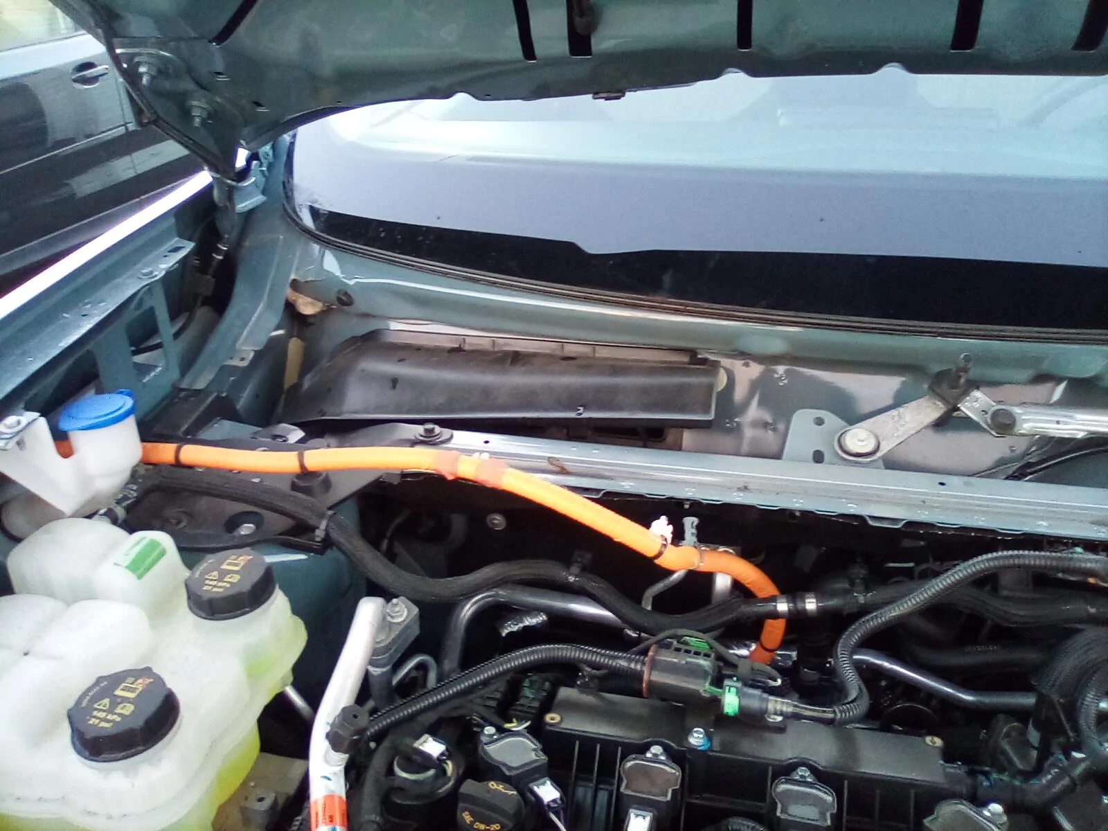

Thanks for the reply Gene. I was afraid of that (removing BCM). I am not sure how all the connectors come off. I already broke one off. I can't see any other way to put the third screw (in the back) back in once I get the fan down. I can reach it with a 5/16 open end wrench to loosten it... I guess I will see if I can figure out a way to mouse proof the air intake opening from the picture you shared. Seems I can put my 1/4 mesh over the top of it. I am hoping the mouse blocked the drain and that is why I had the water on the driver's side floor. Thanks for the tip and the pictures.

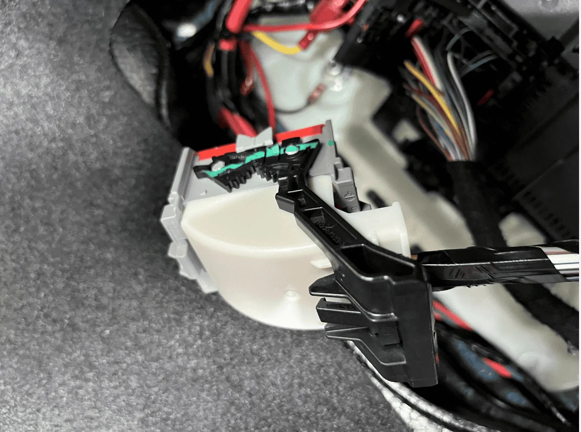

The large BCM connectos have latching levers that lock/unlock them.
The smaller connectors have their latch on the side or end of the connectors that has to be pressed for release.
