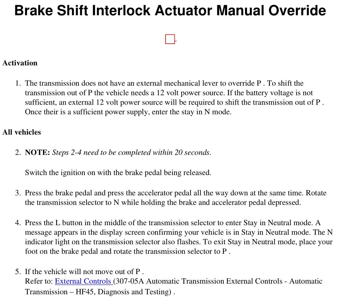

307-05A Automatic Transmission External Controls - Automatic Transmission – HF45
2023 - 2024 Maverick, Procedure revision date: 01/5/2024
Whoa. This procedure is different than 2022. No mention of pressing the accelerator before. 🤔

My maverick died today in rush hour traffic! I was sitting still in along line of cars talking to my wife on the phone when my maverick just died. no power at all, no phone, would not restart initially. Without power I couldn't put it in neutral to push it out of the way! I jumped out to help three or four vehicles get around me. After about three minutes I tried again and thankfully it started and I was able to make it home without any other problems. Is this a one off flaky electrical problems I read about here on the forums? I received my maverick on 3/28/23 it had 6032 miles when it failed. I haven't had any of the recalls done yet, thinking if they come up with a fix for the fire recall would have them all done at the same time. The only consistent issue I have is most mornings there is no interior lighting and I chalk that up to the inadequate 12v battery that Ford has yet to address. Has anyone else had this particular problem and how do you move the maverick if you have no power to get the truck to neutral ?
