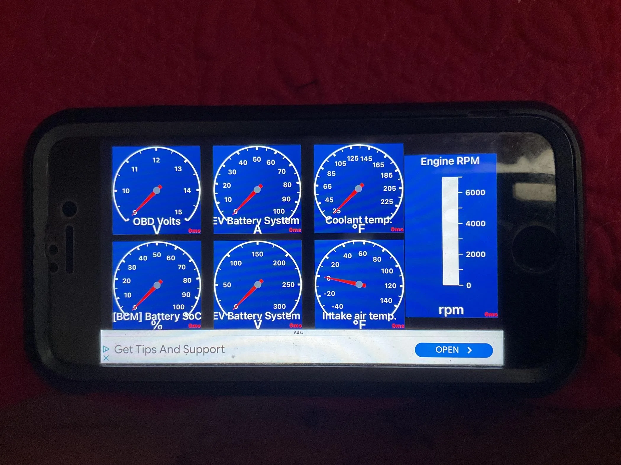

Used the Car Scanner app on my iPh & built a Hybrid Dash (beta 1) version. It reads from an OBD scanner plugged into OBDII port.
All gauges work, & I can watch the ICE come & go too. After 30+ minutes idling while setting this up the BCM battery was at 70% SOC.
Again, this is beta1. I want to change the gauges shown to a different look & maybe find a better pPh mount or maybe a small tablet. Will
continue to work on getting it to display on the Maverick nav screen.

Would be nice if we could put this on the main view panel like android auto folks can. I've considered buying a cheap android and just installing it permanently to use it.
I've been using Car Scanner for years, it's great. I cannot figure out how to pull transmission temperature though, that was one I would really like to have.

Does it work wireless ?
