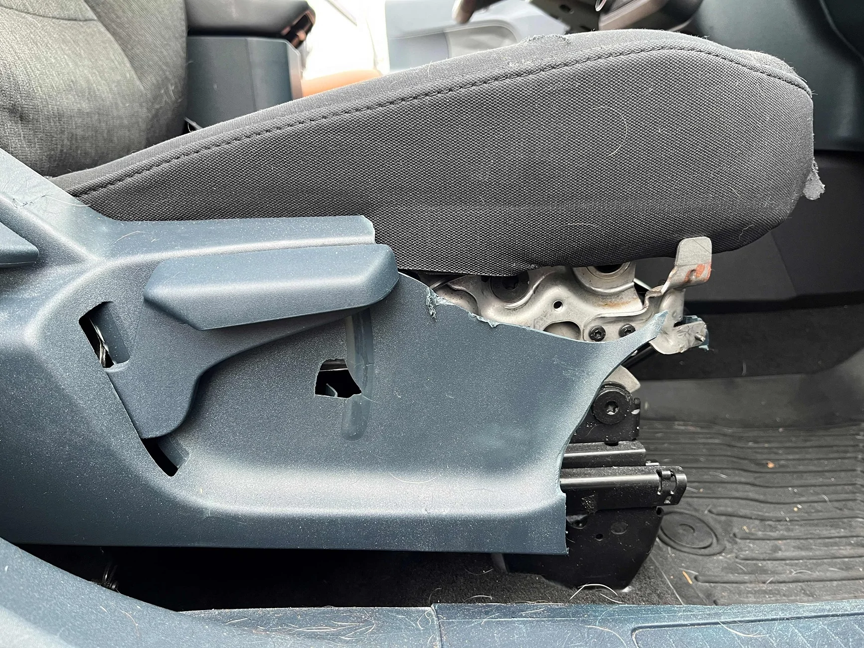

Buying a 24 Maverick with 17K miles, I noticed the passenger seat has torn plastic side cover and most of the plastic covering of the seat's rails etc. were gone. I have assembled most of the parts but how do I take out the seat to install the plastic covers to the rail? Or do es the seat come off the rail?

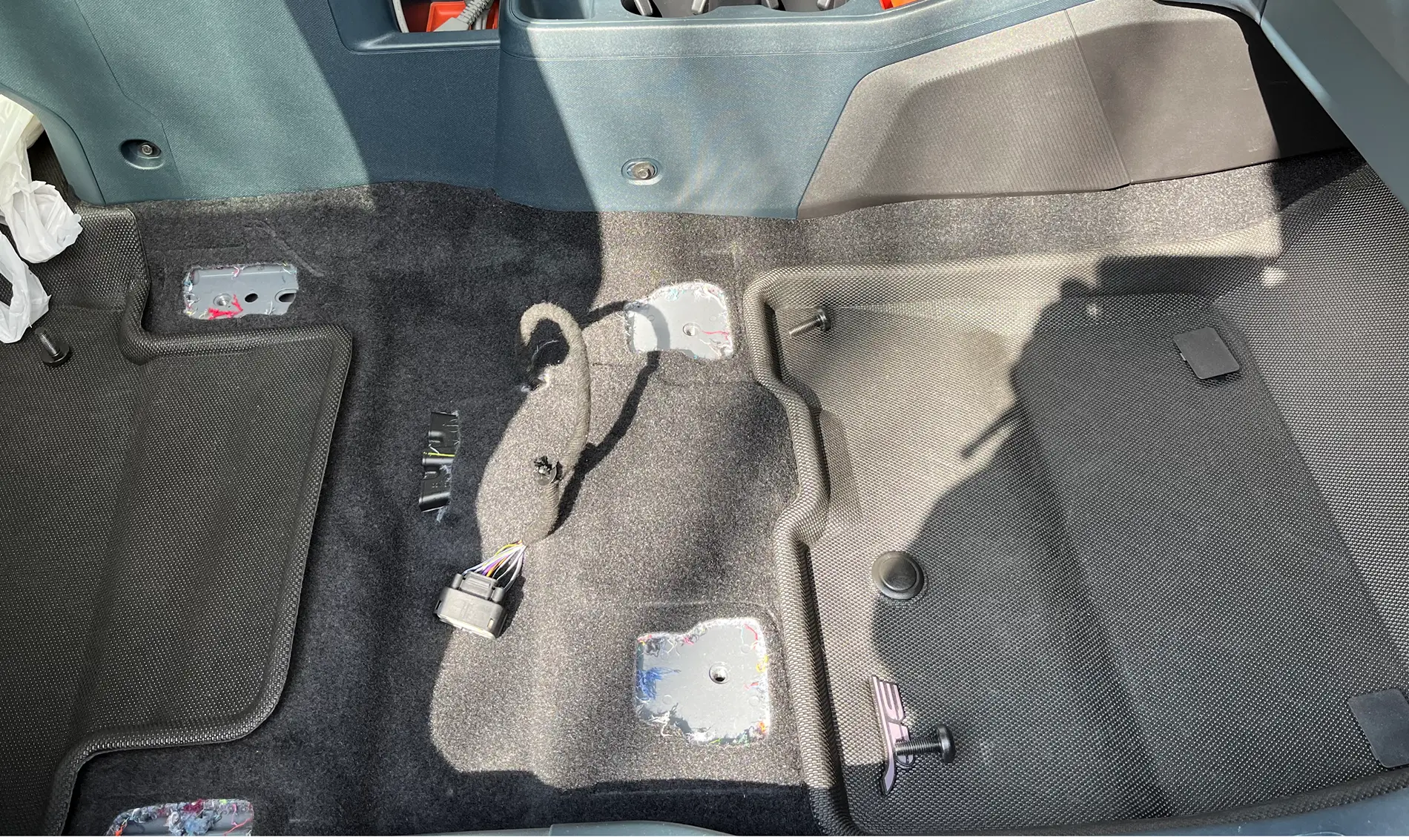

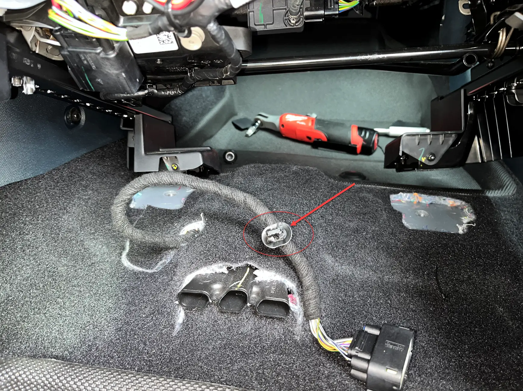

Disconnect 12V battery.
Work the body harness ty rap fir tree mount out of bottom of seat.

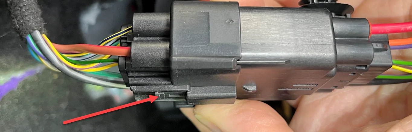

Disconnect the seat connector. Have to press on the release lever and takes some force to separate the connectors.
(Can work loose the fir tree loose & disconnect once seat bolts are out and tilt the seat back to access the ty rap and seat connector easier)
Small screwdriver or thin trim tool to lift from the inner side of the seat mounts to reveal the Torx Plus TP55 bolts.
The small trim pieces come off from one end easier because of how they clip in.
Four TP55 bolts hold the seat down.
When they are removed, lift out the entire seat out the door.

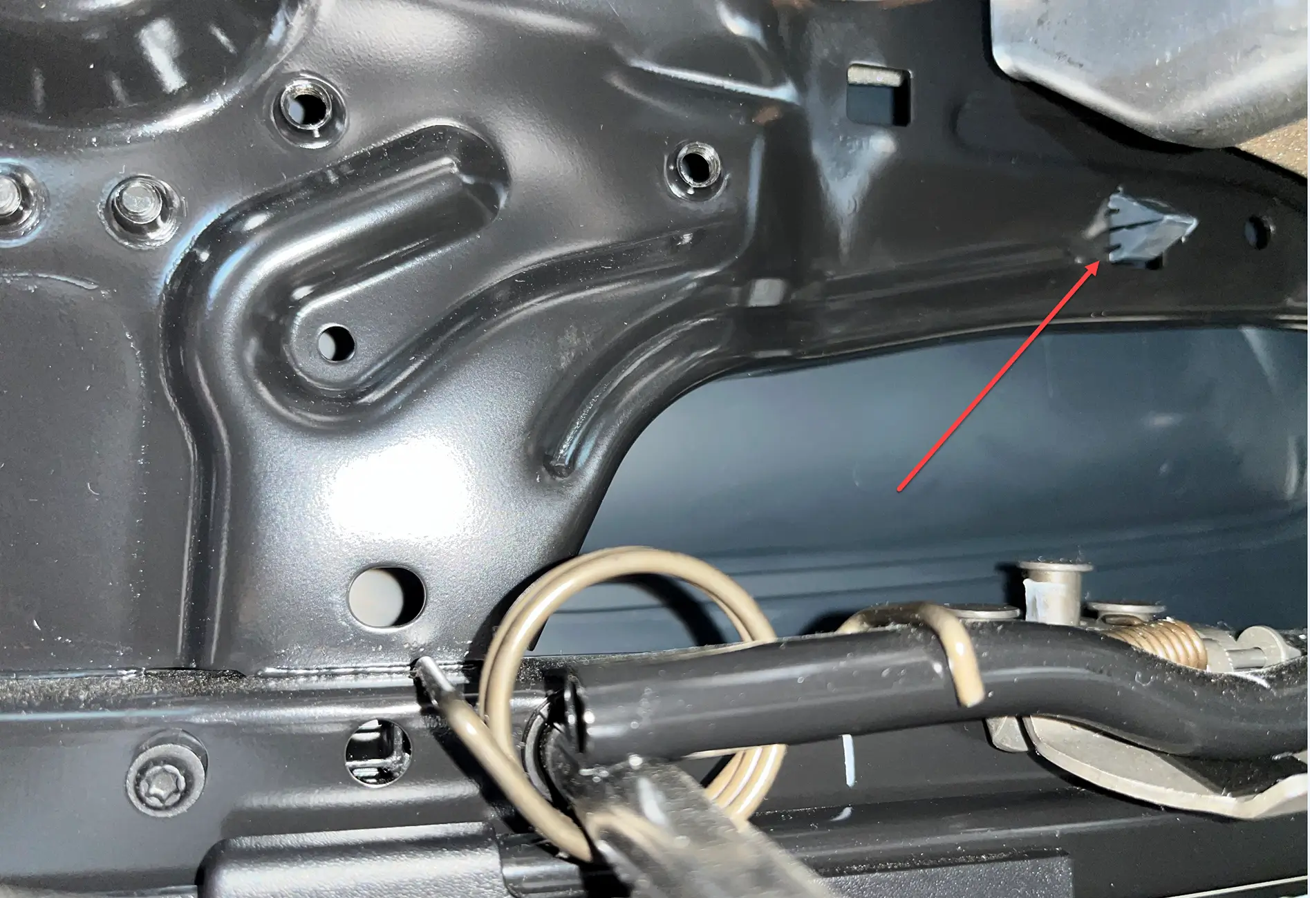

Ford Maverick How to Remove Front Seats? 1772220833514-6f

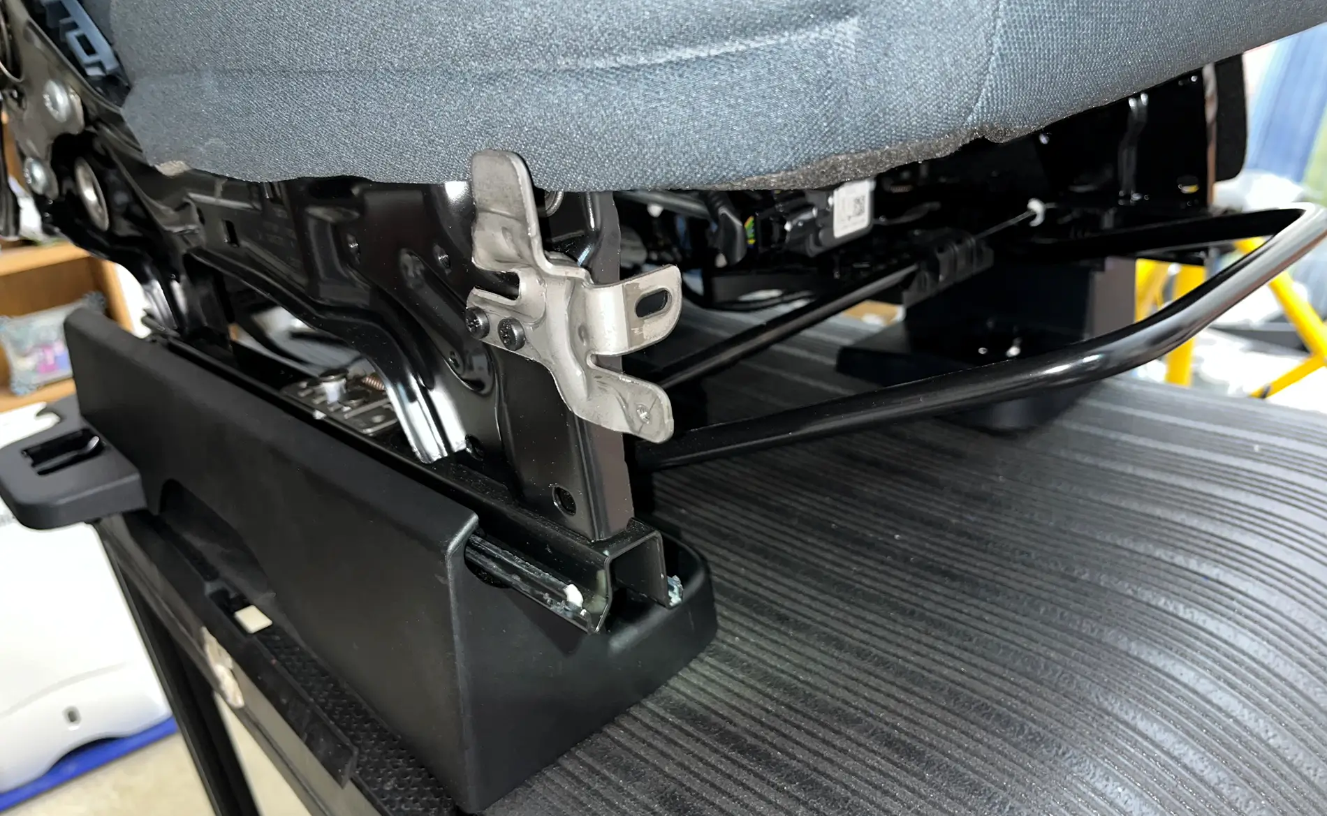

Seat Connector Unlatch Lever. The Lever releases from the shark fin.
Press and hold while pulling the female, male connectors apart.
Ford Maverick How to Remove Front Seats? 1772225243091-96

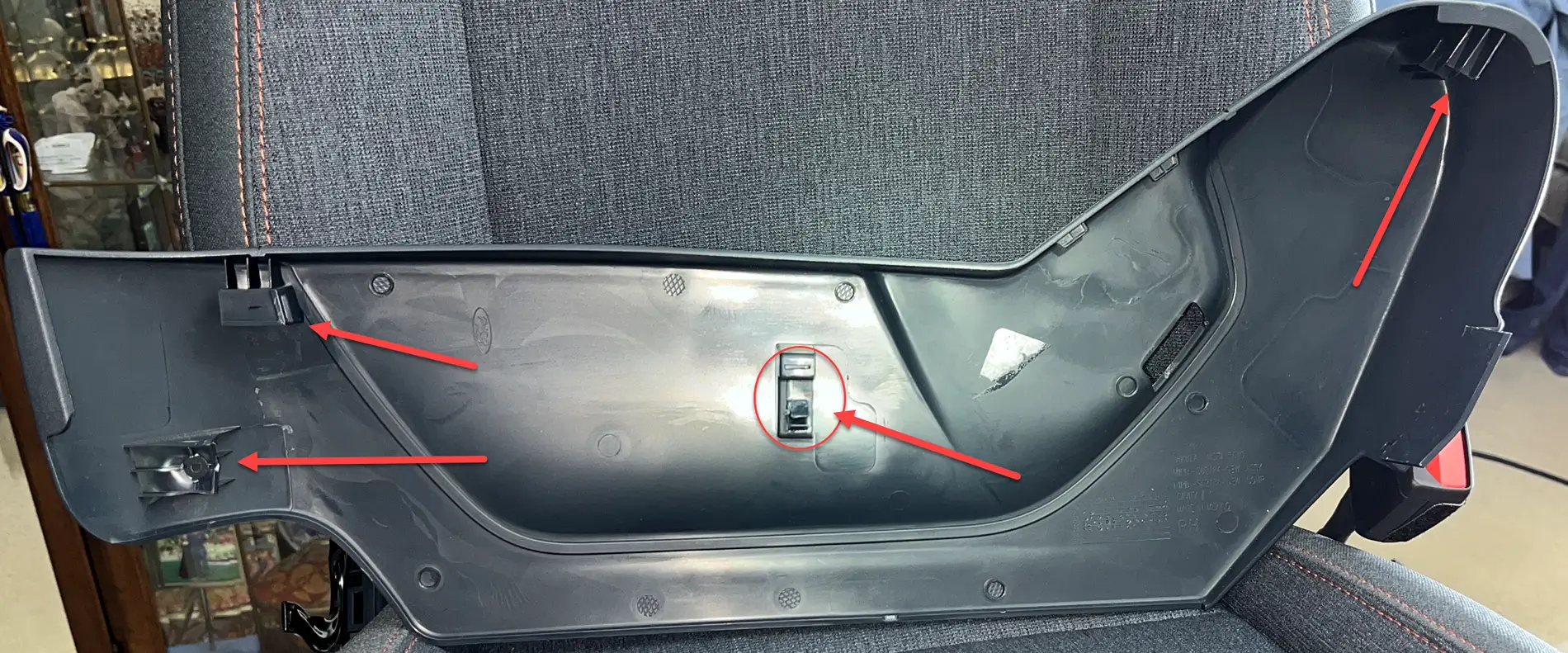

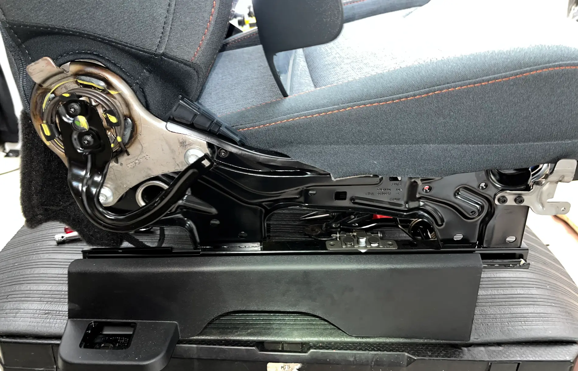

Passenger trim:

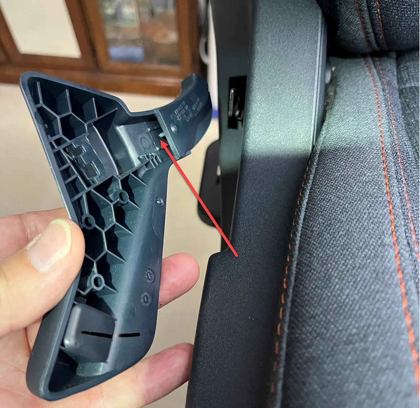

I removed the plastic lever by pressing on the plastic where there's a notch that hold the plastic to the lever.
Remove screw that hold the trim at the front
Use needle nose to release one clip from inside the seat frame
