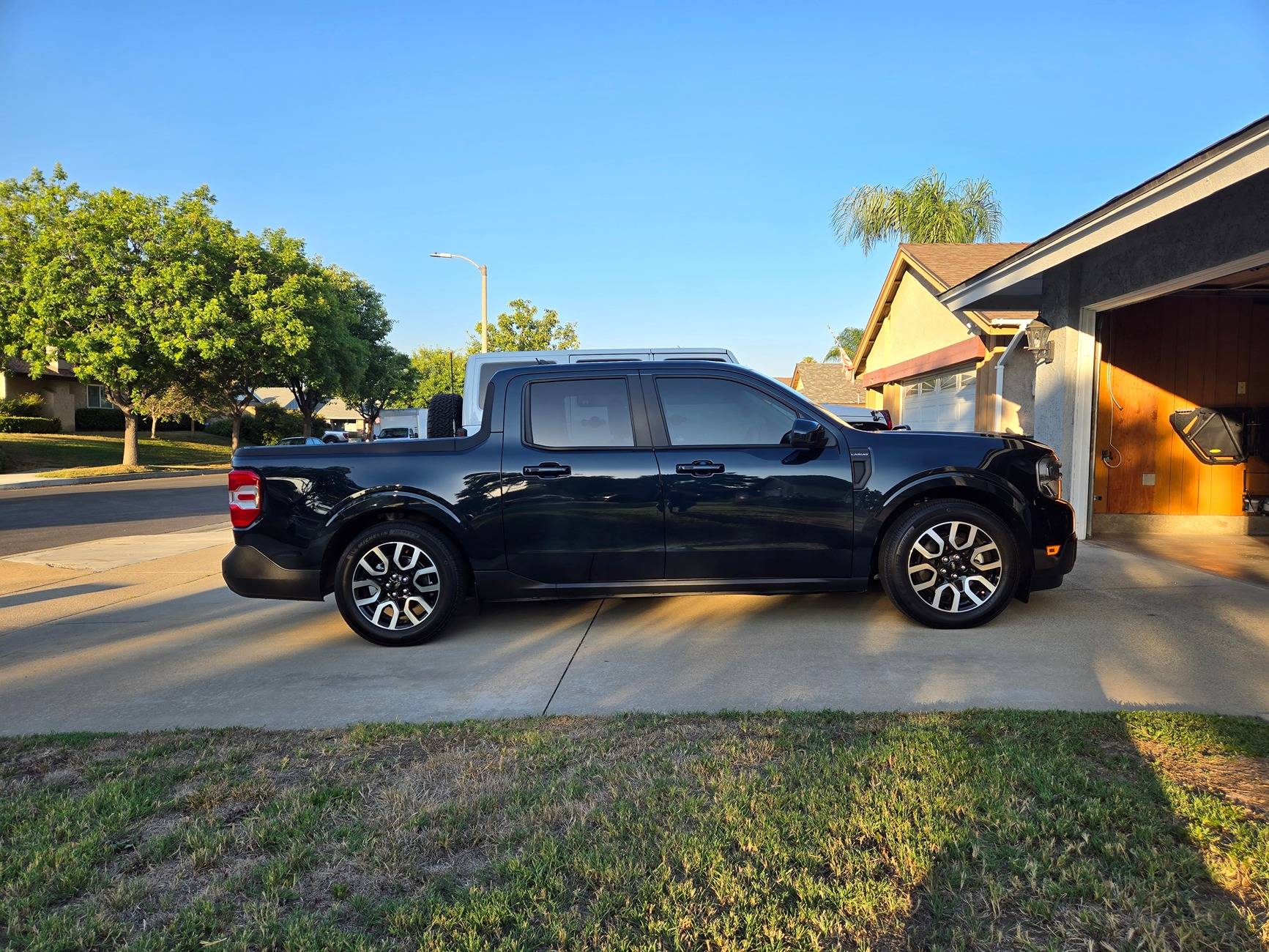

It took me about four hours. The front takes longer. I have the Lariat, AWD, Eco. I wasn't willing to pay a shop to do it. I'm very happy with the ride and looks.
Ford Maverick How many hours does it take to install Eibach Springs? 20240715_190905
Ford Maverick How many hours does it take to install Eibach Springs? 20240715_190851

Thanks for taking the time to respond. Much appreciated. Your Mav looks great.
