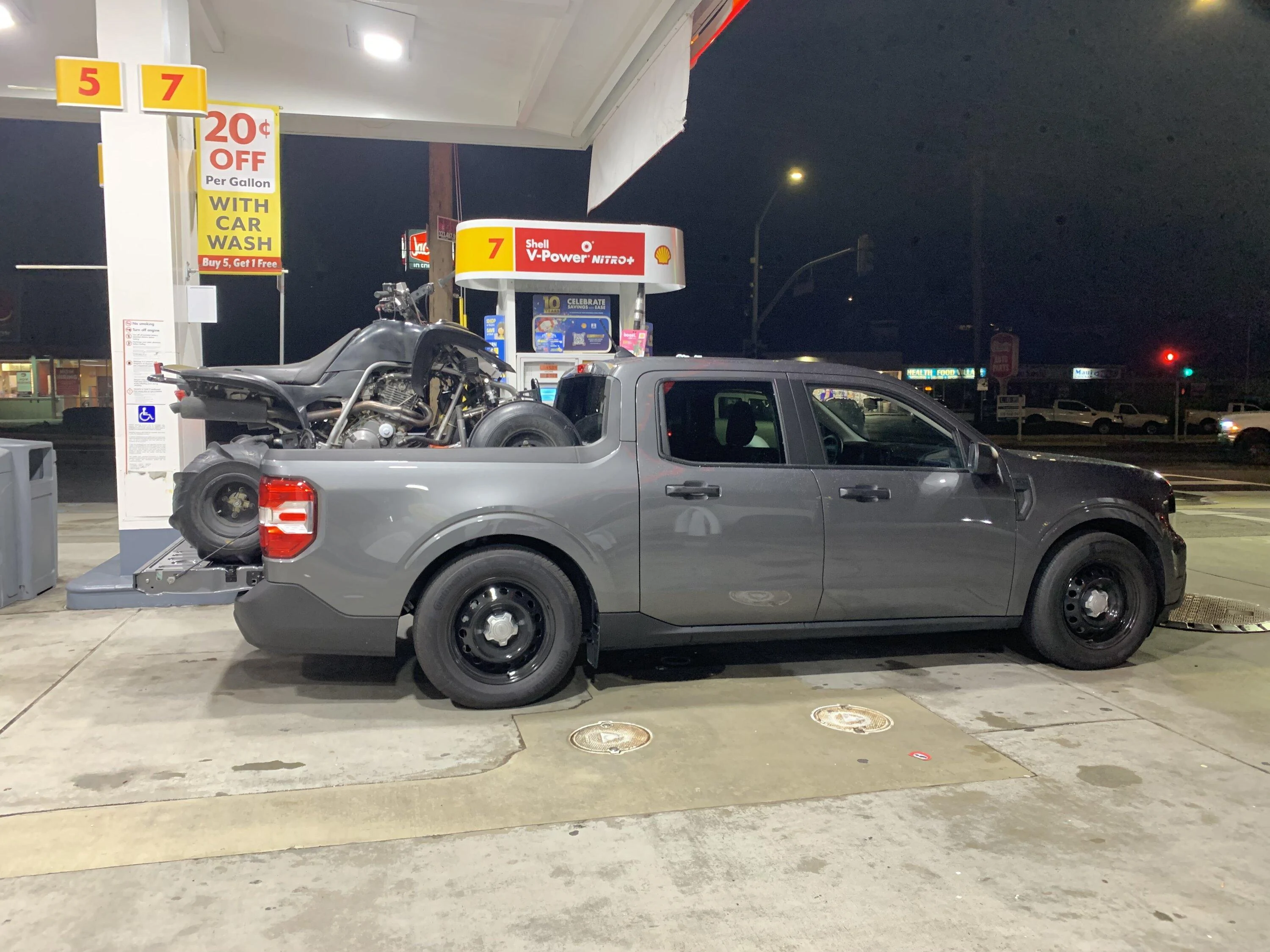

I have H&R super sports on my awd xl. The most weight I have hauled was my atv plus some wood ramps so probably 450ish lbs in the bed plus about 100 lbs of gear in the back seat. I did a 600 mile round trip like this and while it did have a slight “squat” with the extra weight it drove great. No bottoming out or anything. I did have a few people flashing their lights at me though, so I do eventually want to find some bags that work with lowering springs.
