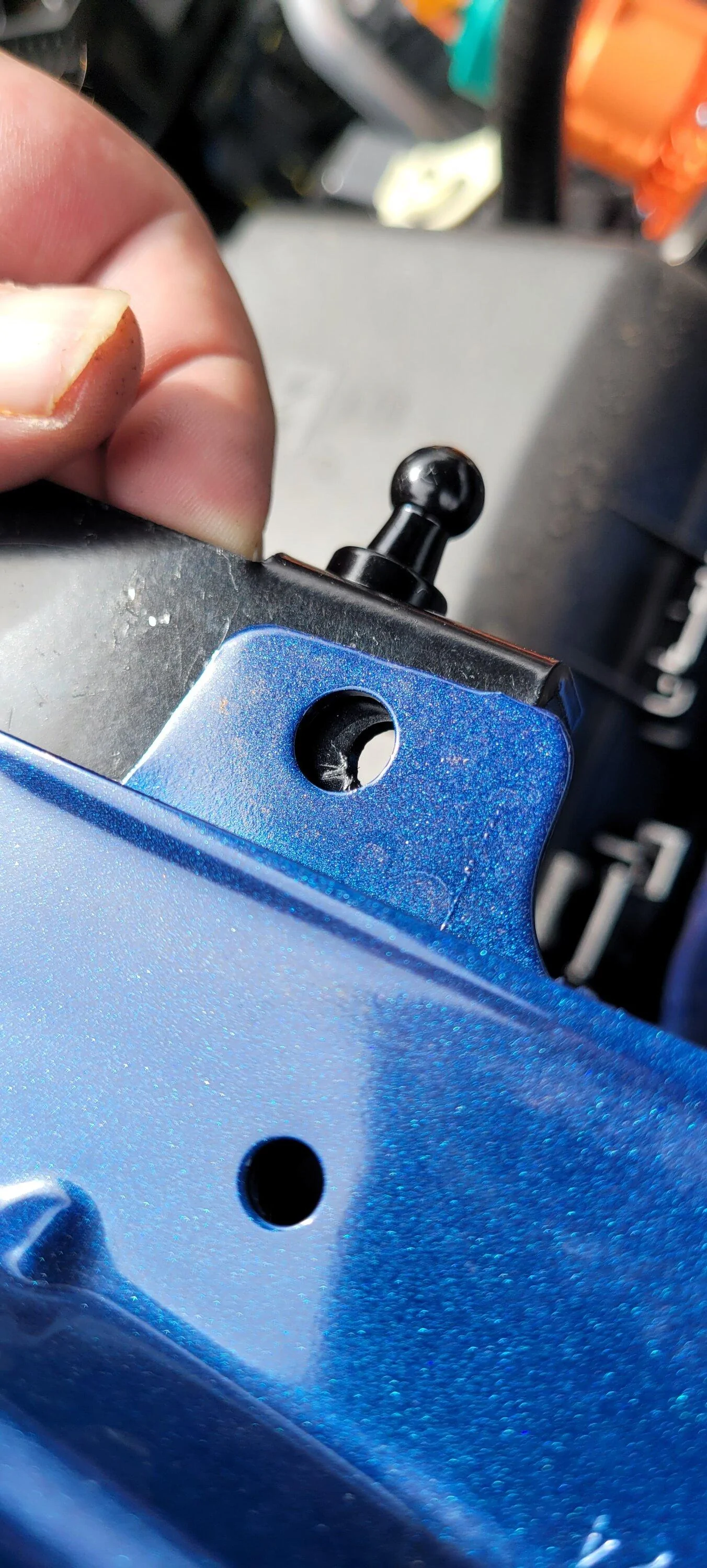

Went to put the hood struts on and ran into problems. I ordered this from Amazon (https://www.amazon.com/dp/B0BPH1641Y?psc=1&ref=ppx_yo2ov_dt_b_product_details) and it said it was a Pacewalker, but what arrived was a Speedpark. Didn't look all that different from others out there so I unwrapped, read the directions and watched some videos. After that, I went outside to install. I tried "dry fitting" the parts before taking off bolts and none of the strut brackets would line up. The top bracket was too short, and the bottom brackets wouldn't line up with the existing holes. Back they go. Strike one.

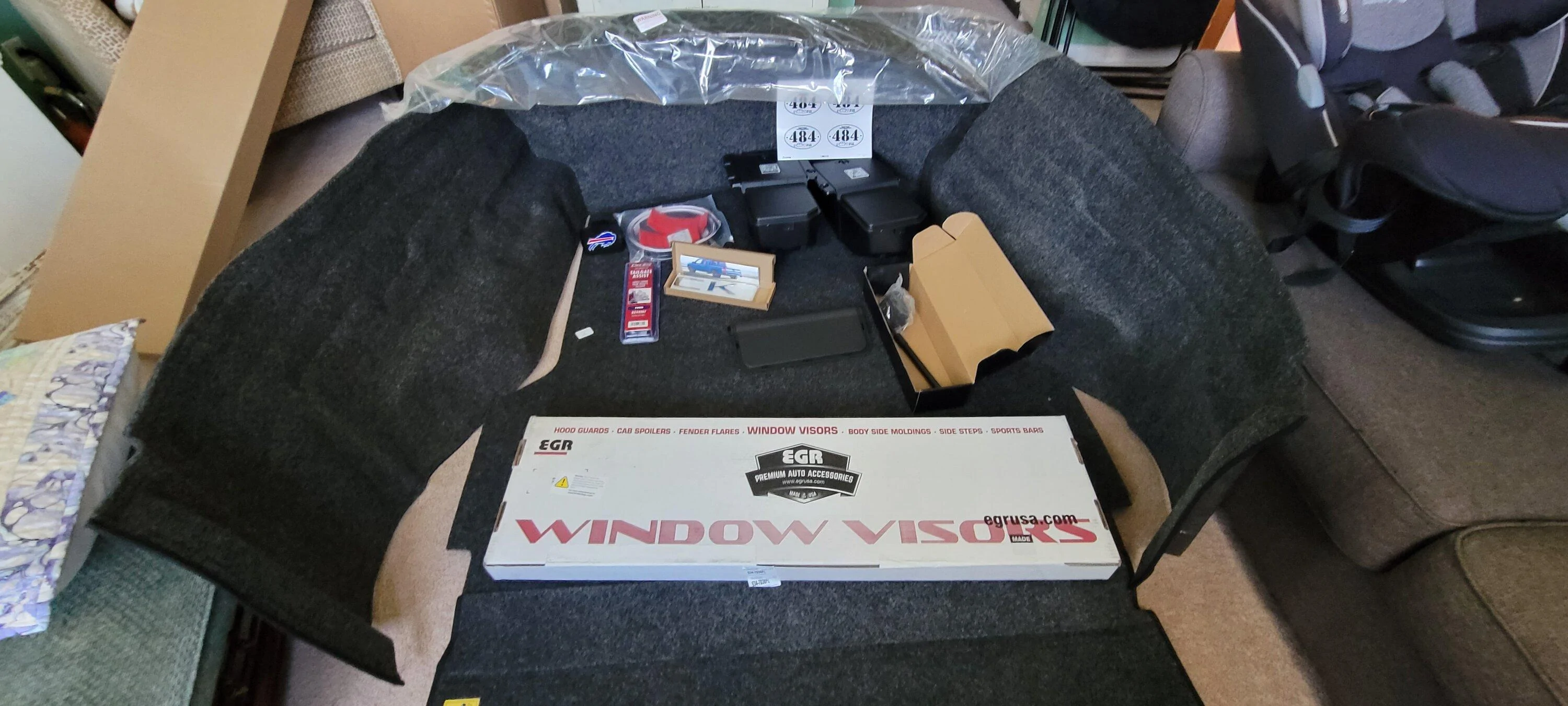

So, next was the bug deflector (2022 Ford Maverick EGR Superguard Bug Shield | RealTruck). Watched the video again at the @Realtruck website and began reviewing the instructions. This is where I was disappointed. In the video it shows the bug shield as a single piece. In the instructions, it has you install six separate clips to the hood and then attach the bug shield to the clips with screws. This is not what's shown in the picture, and not in the video further down the page. So now I need to decide whether I want to install it and see if I can live with it or return it for a full refund.

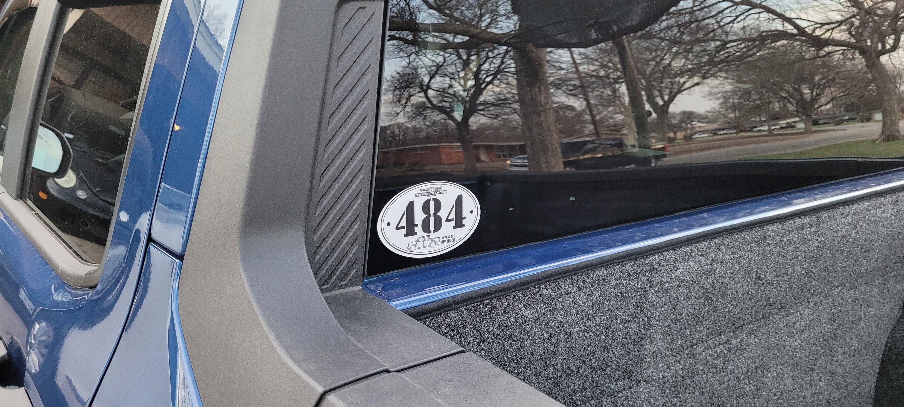

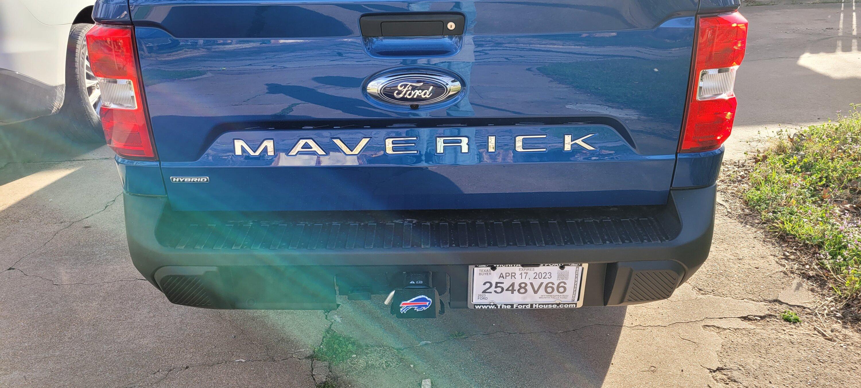

So, to get something constructive done I installed my lettering and "484" sticker. At least it's something.

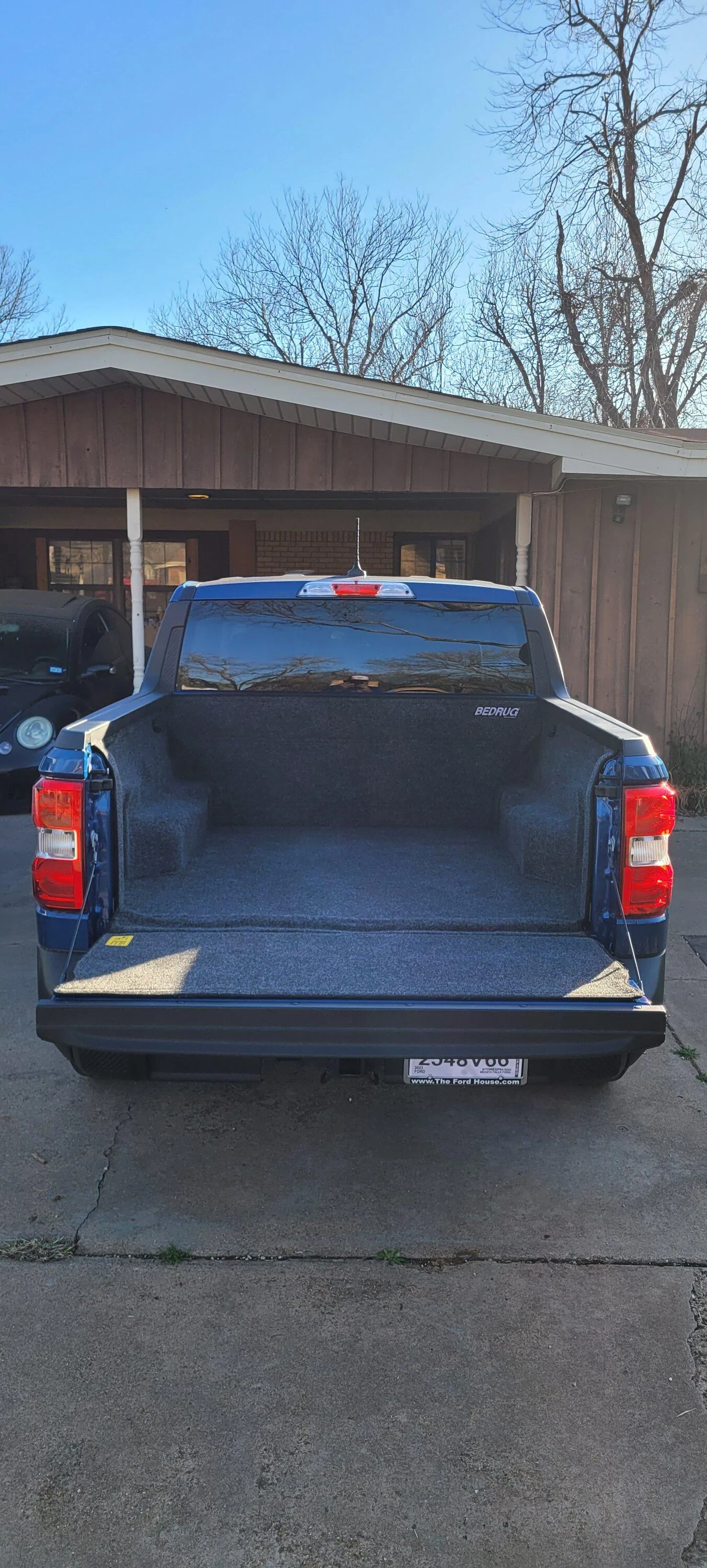

The bedrug is awesome, but a PITA to install. Since there are no specific instructions or videos, the area around the cubbies are a bit of a puzzle to get them to fit and line up with the holes (anything you can do about this @Realtruck?) The silver bolts in the bed cubbies are $.69 each instead of whatever Ford is charging. Thank you, Ace Hardware.

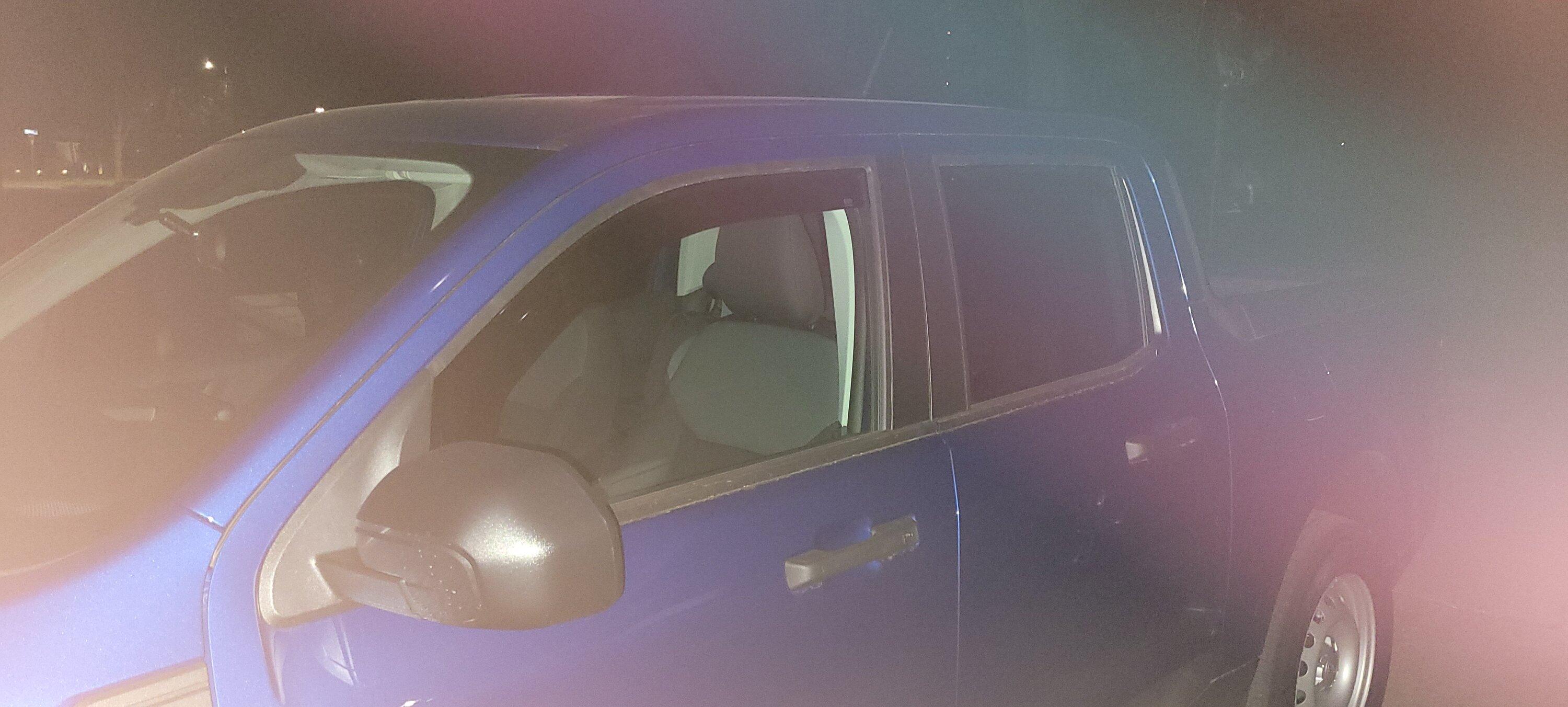

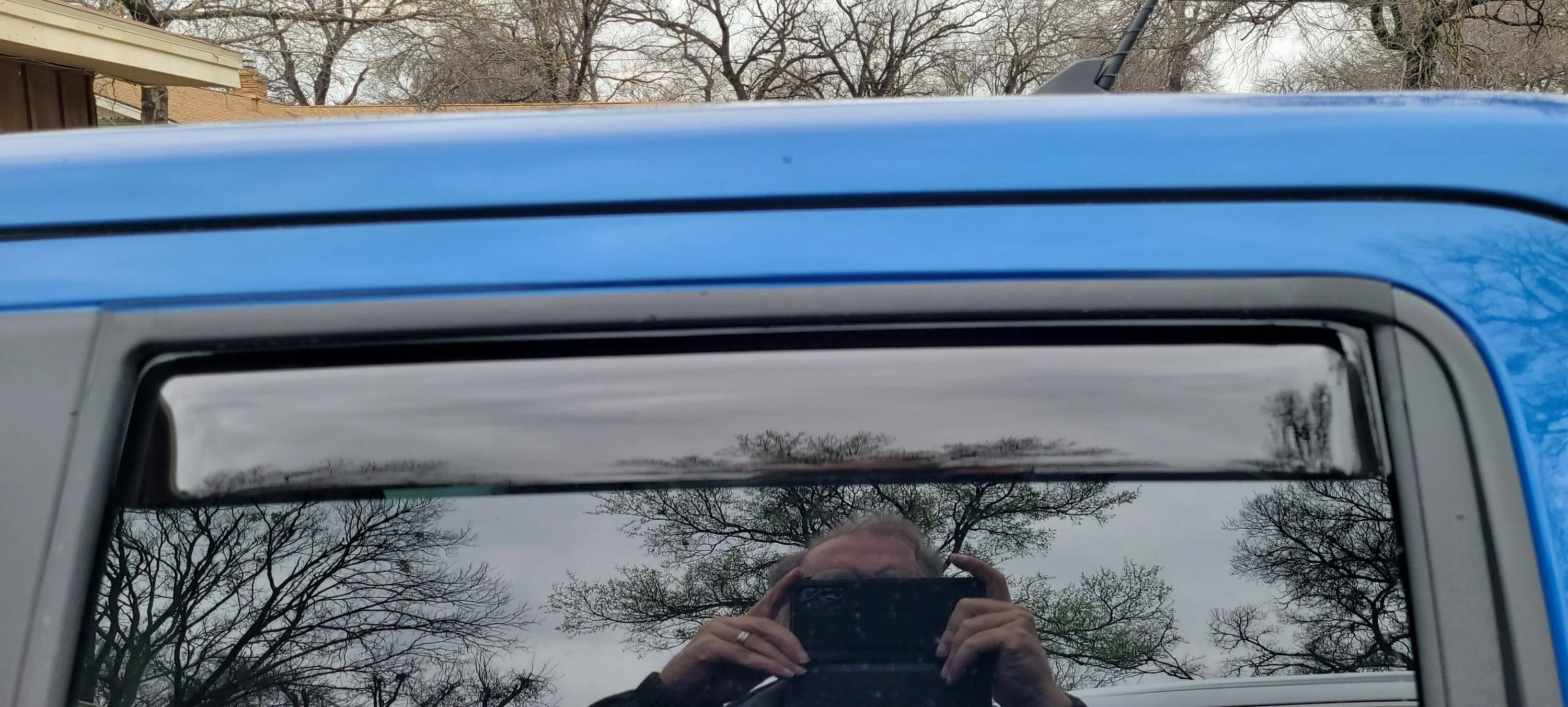

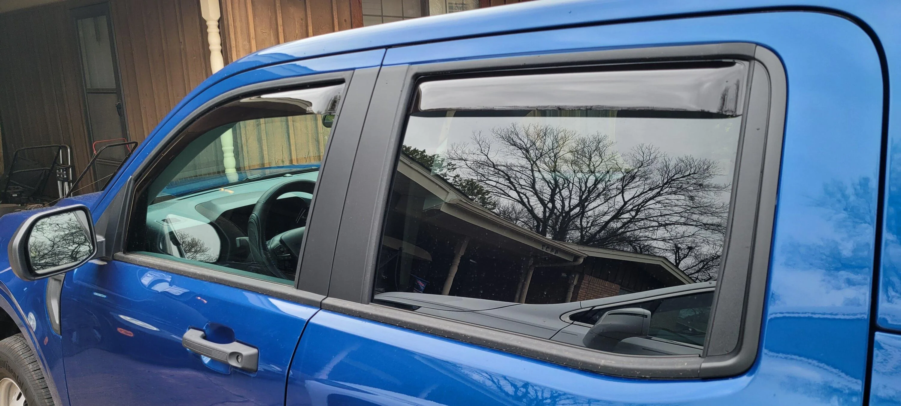

The window visors went on last. Really easy, no tools. I'll try to get a daylight picture tomorrow.

I haven't used it yet, but it shouldn't affect it much (maybe 1/8 to 1/4 inch). Since I knew I was going to use the boards in the flex bed, I waited to measure it out until after I installed it.
How does it work with the locking tie down rails? Might be better than going with a SIBL. And better than the hard plastic drop in liner!
You should be able to mount the rails. The sides of the Bedrug are contoured very well to the bed. All you have to do is make the holes (not as easy as you think) for the bolts and mount it right on top.
How easily accessible are the bed tie downs?
If you are talking about the ones attached to floor of the bed, I don't know. If I do the bed tiedowns. I will get the ones that @Shay used in his XL ( (1) Cargo Box Tie-Downs for XL for under $15 | MaverickTruckClub - 2022+ Ford Maverick Pickup Forum, News, Owners, Discussions )).
And how much trouble is it, getting the cubby reinstalled?
It's not as easy as it looks since the cubby bottom sits low, almost to the bed. The cut out on the back only takes into account for the default panel. You can start by cutting that out, just remember you will need to do more trimming on the bottom of the hole to get the cubby to seat properly. Be careful of the zipper and use a fresh blade on your cutter, and you shouldn't have any problems getting it lined up. I used this video (How to Install BedRug Impact Bed Liner on a 2021 Ford F-150 - YouTube) to get the general idea for installing it (the written instruction suck) since there are no installation videos specific to the Maverick (hey, @Realtruck think you could help us out?).
