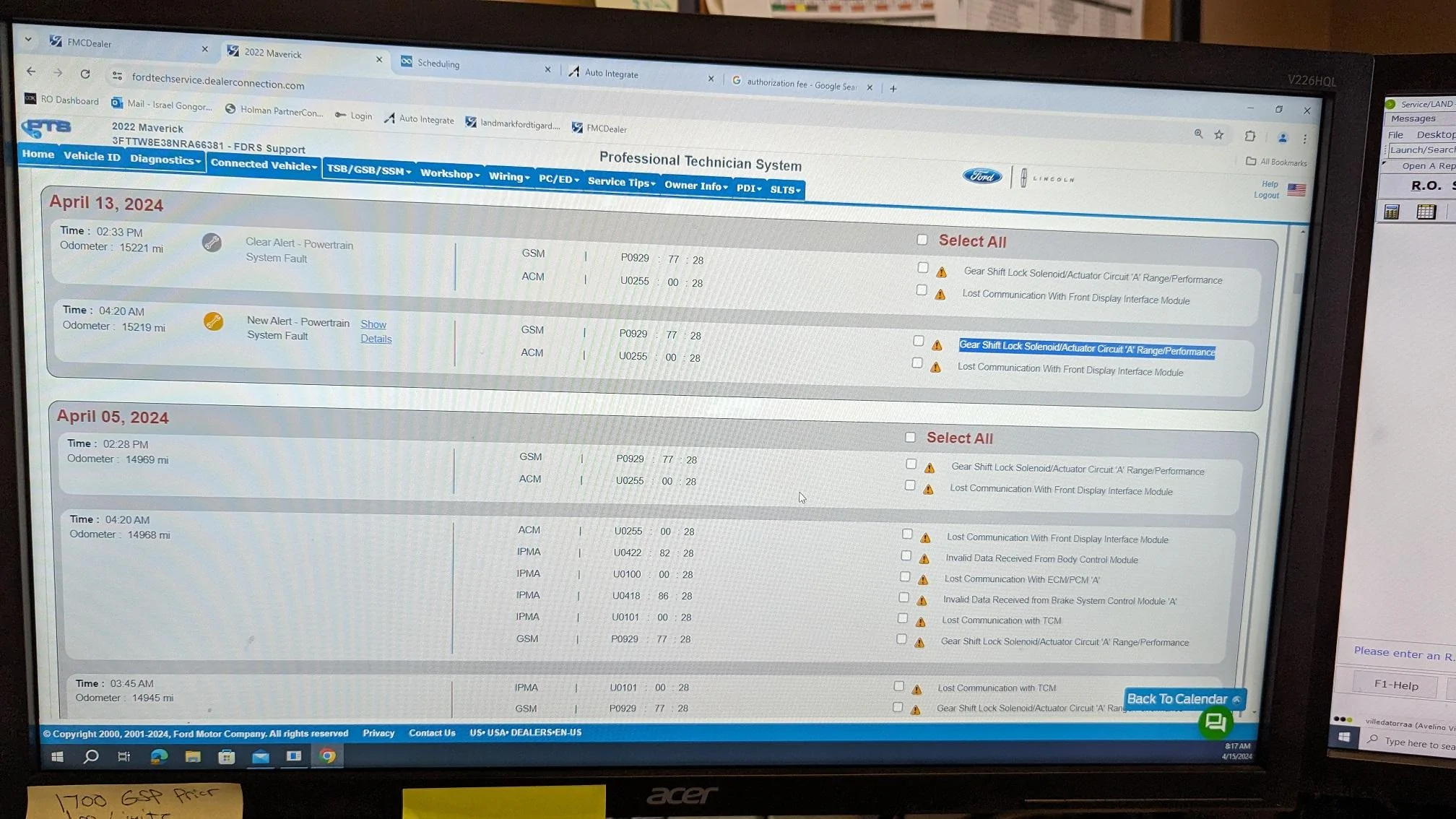

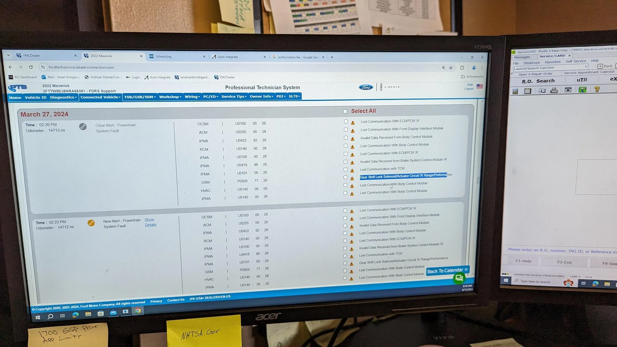

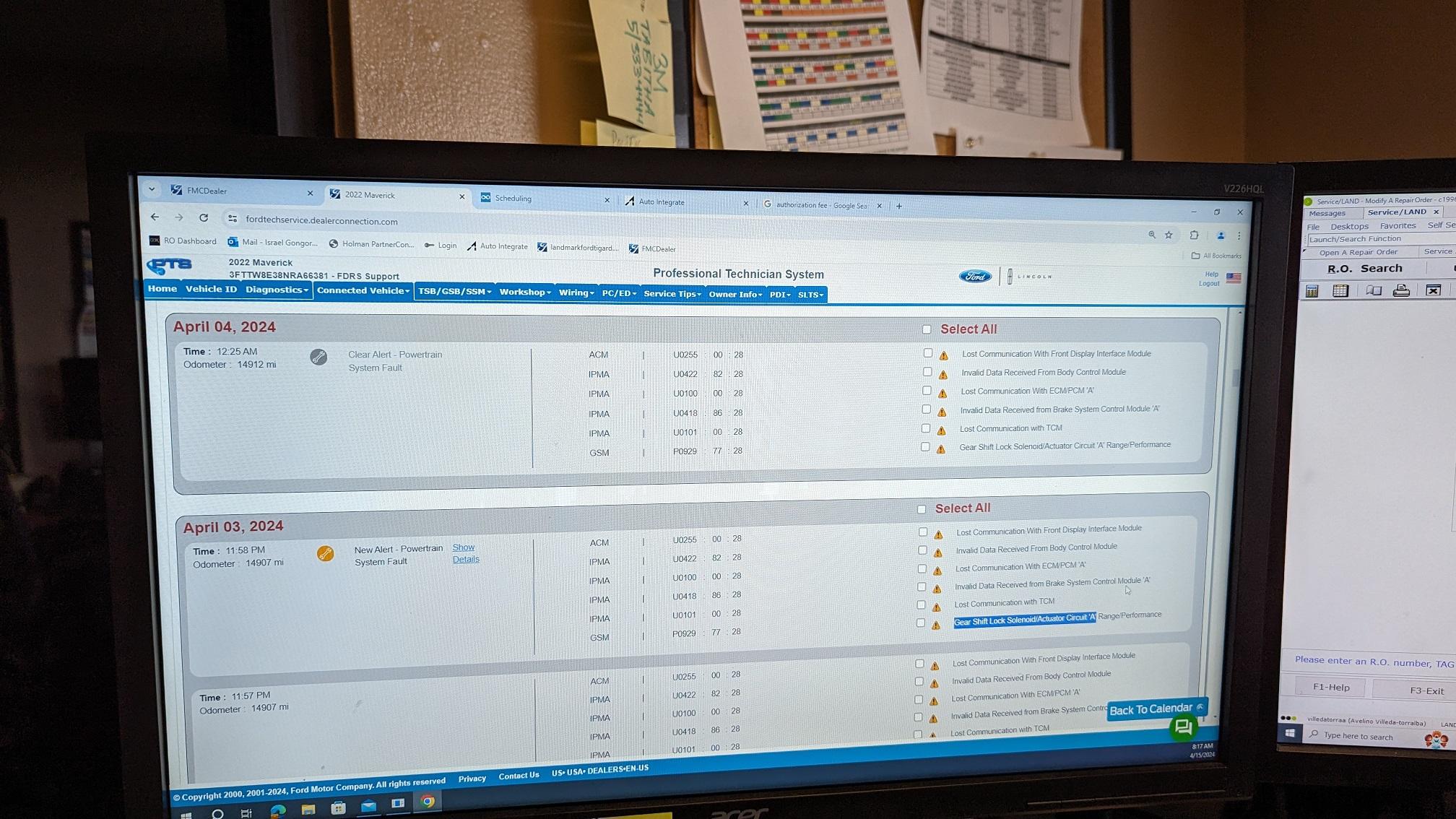

Took it to another dealer this week, and tech showed me a calendar on his computer screen showing alarm codes for the last 3 months on this vehicle. He noticed the "Gear Shift Lock Solenoid / Actuator" was in almost all these messages and checked it. He discovered the shifter was not putting the system into sleep mode when put into parked. It was still drawing power and causing these low voltage issues. New part was ordered, and it will be installed next Monday. Tech also recommends I get a battery tender if I'm going to let the vehicle sit for more than 5 days, due to the nature of hybrids.
