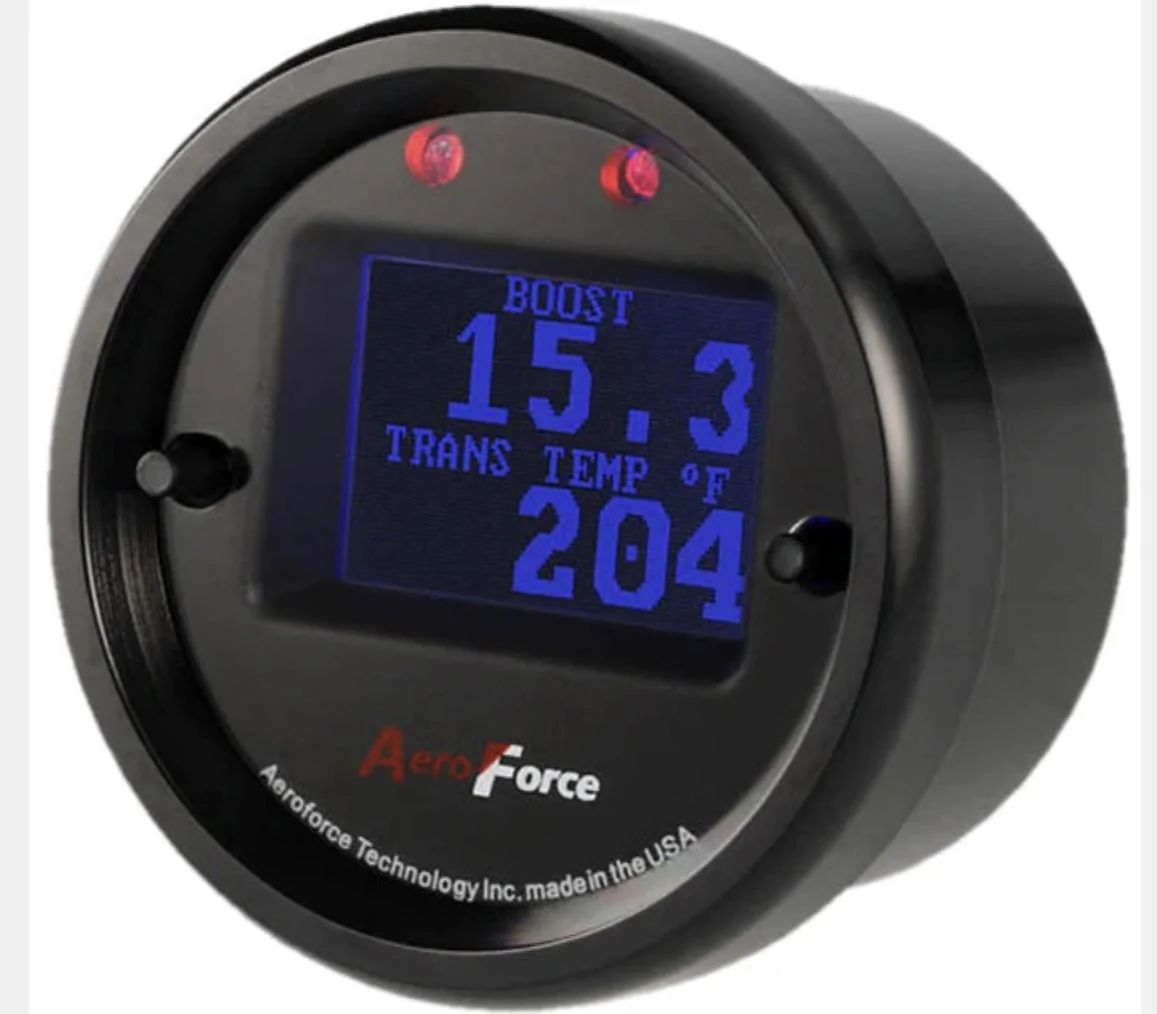

Ethanol content kit coming soon. It will include the following:
-Aeroforce vent Gauge Pod
-Aeroforce Interceptor Gauge in your choice of various screen and bezel choices. Gauge screen will have Maverick on it instead of Aeroforce.
-Ethanol sensor with wire harness to connect to gauge.
-PTFE line with AN fittings (this will replace the OEM line that connects supply line to HPFP)
Kit will be 95% Plug and Play. Only some simple wiring will be required to power sensor harness.
Price will be coming soon.

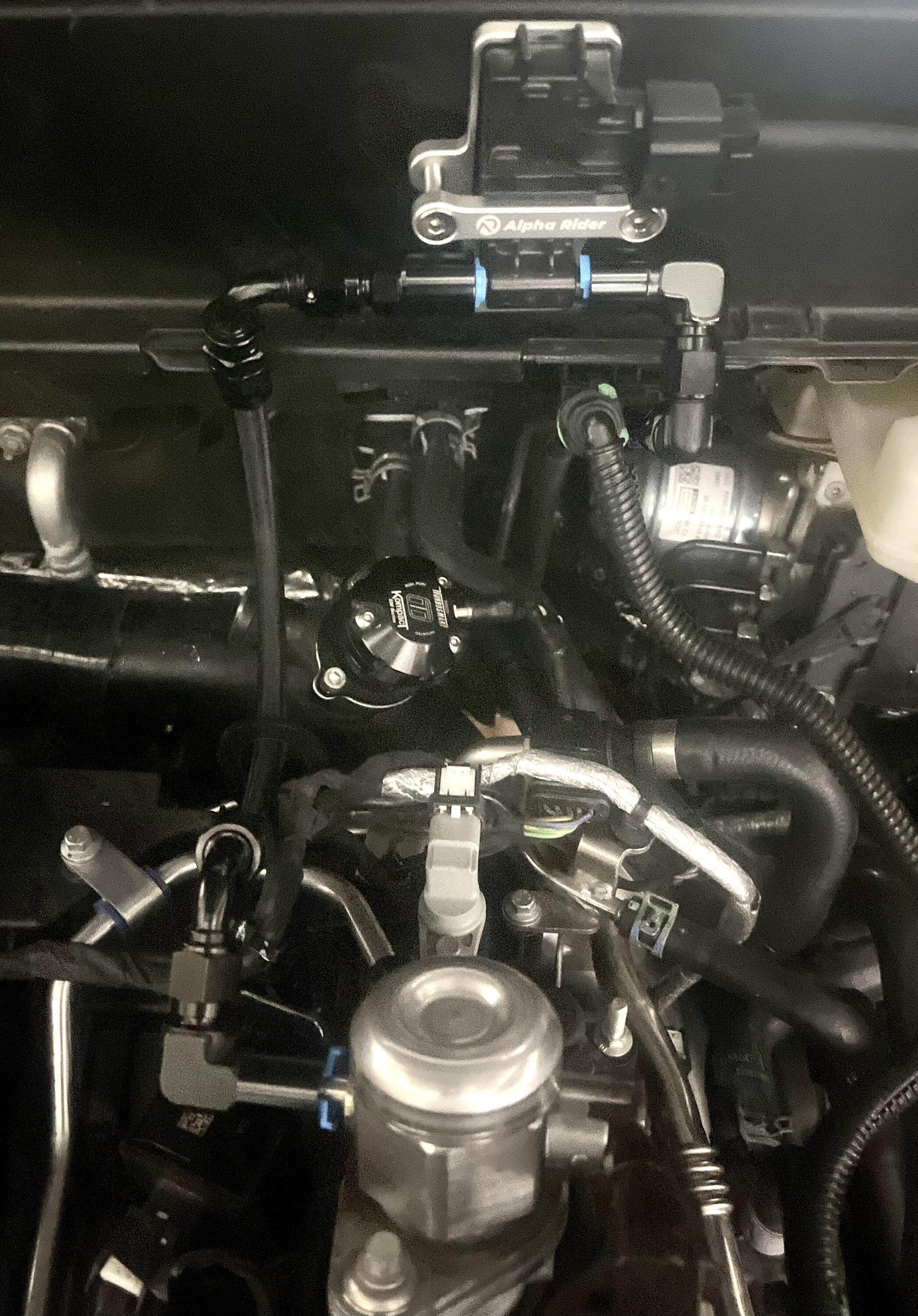

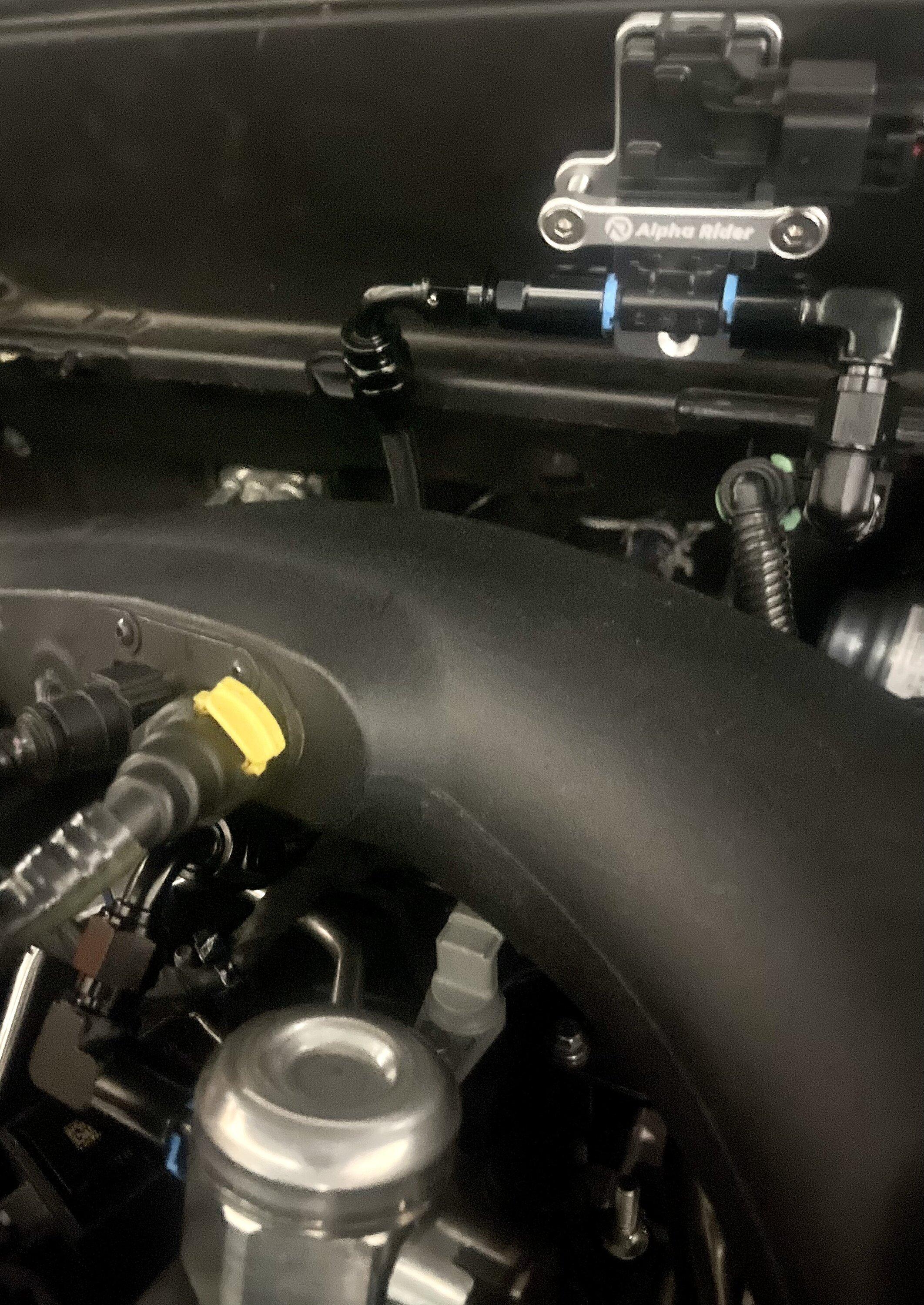

I finished up the Ethanol sensor line just waiting on module and harness. I got this cool sensor mount on Amazon though I still need to mount it. I like this routing because it’s up off the engine and the S&B tube clears fine.
I plan on replacing all the hard plastic PCV hoses with -6 SS lines to declutter the engine bay.
Hope you guys like it.
