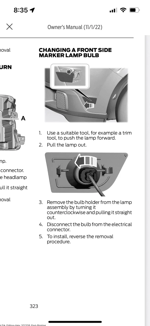

Is the lens not just held into the bumper with a pressure type clip? Couldn’t you just put in a flathead and pop the housing out?
Doesn't look like it. Squeezing tabs on other side of fender is the safest.
One slip of the flathead and you'll have a scar to remind you of how that worked out...on the paint, and maybe one on your hand if it was in the way.

Page 323 in the owners manual :)
