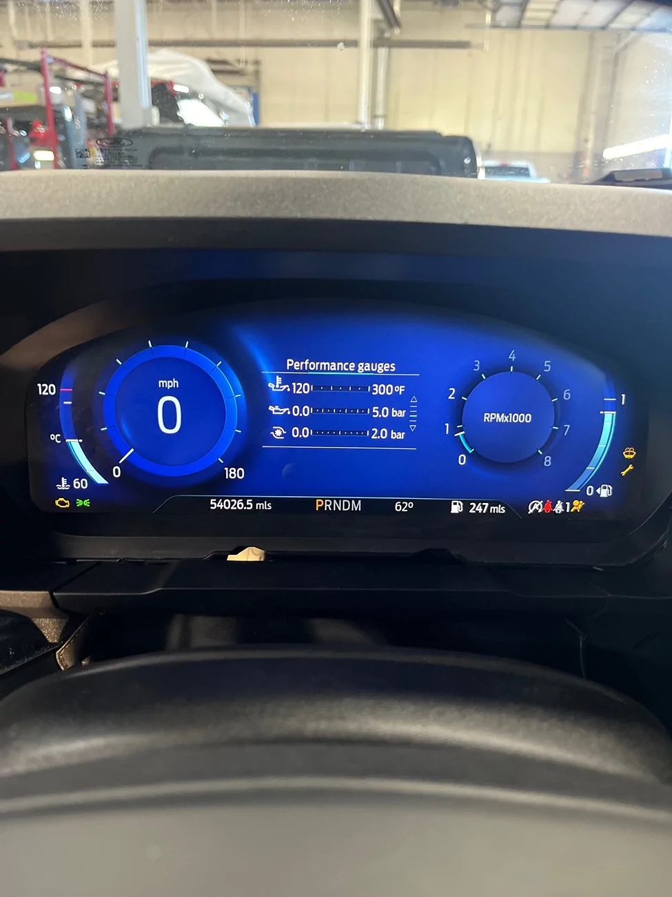

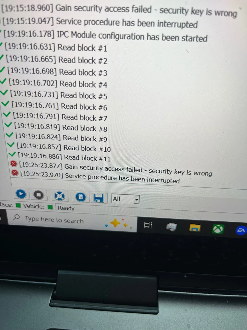

Can someone help me understand how to get past security key issues swapping over to digital dash from mk4.5 focus st. I have forscan and my shop has full ford software but still need dealership to change mileage.
Ford Maverick Forscan security key issue IMG_2499
Ford Maverick Forscan security key issue IMG_2490

Ok already figured it out updated forscan to latest software and I can change everything.
