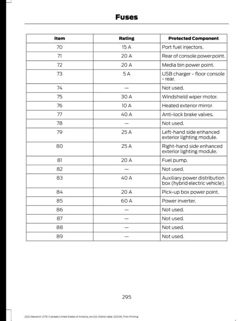

I was setting up my bed lights and hooked up the pig tail to the flex bed connector…. Tested the lighting, and then the wire arced out on the bed tie down, 😑. No more power lol

Fuse, good luck

Definitely not number 84 that’s labeled “pickup box power point”

try fuse #88 20amp, not labeled

79 or 80?
When you were "testing" did you have connected bare wire ends of pigtail insulated or just twisted together for quick check before finishing the job? Must be some reason for the arc...
