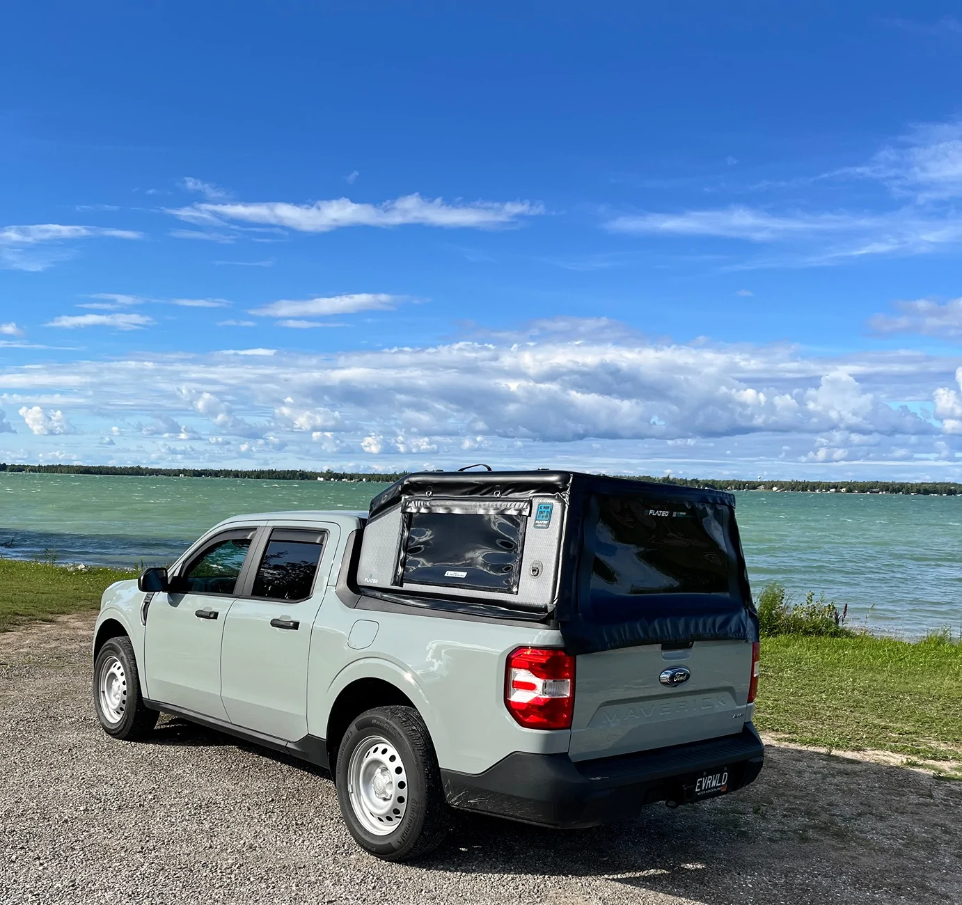

Unless Flated seals tightly to the cab at the top and all along the C pillar and down the side trim you will get water in the bed. @ToddsTruckLife posted a great video how to eliminate water infiltration at the bulkhead. I followed his instructions and also sealed the gap on the side trim pieces with Permantex silicone sealant. Link to the video is in this thread. Good luck and let us know how well you like the topper.
