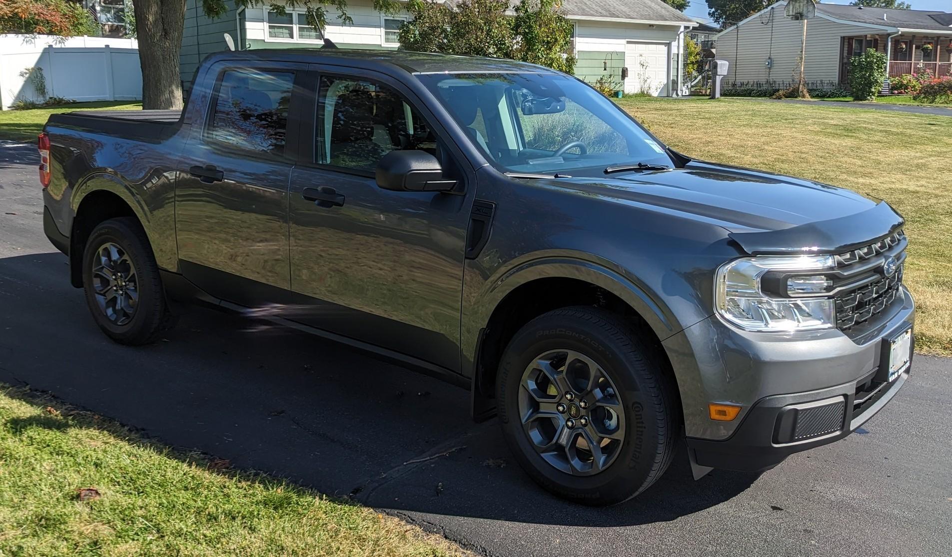

After waiting well over a year I finally got my XL hybrid Maverick Thursday and I love it. The nice thing about the wait is I could research and plan all the modifications I wanted to do.
The list of what I've installed so far in the few days I've had the truck.
-Power tailgate lock: added wires to factory harness and used generic actuator following instructions posted on MTC, only cost about $20 and an hour or so of time.
-LED Bed lighting: LED light strips mounted under the rails, turn on automatically when bed is open, can be turned off using illuminated switch. I used a magnetic switch and a relay, probably make a more detailed post later.
- Installed XLT wheels purchased from another member, made a huge improvement in looks.
- Splash guards.
- AVS Bugflector II
- BAKflip MX4 tonneau cover.
- Tailgate dampener
- Ran wires from fusebox to to kia auto dimming mirror and dashcam, concealed behind trim. Both have constant and accessory power requirements.
-Infotainment screen protector.
-Rust protection: sprayed "Surface Shield", I removed the spare tire, wheel well liners, taillights, and all the underbody covers to get to as much as possible, still have to figure out the clips for the rockers so I can do those. This was definitely the biggest PITA of all, especially without a lift.
So far I couldn't be happier with this truck, it's not perfect but it's an amazing value and fits my needs perfectly.
