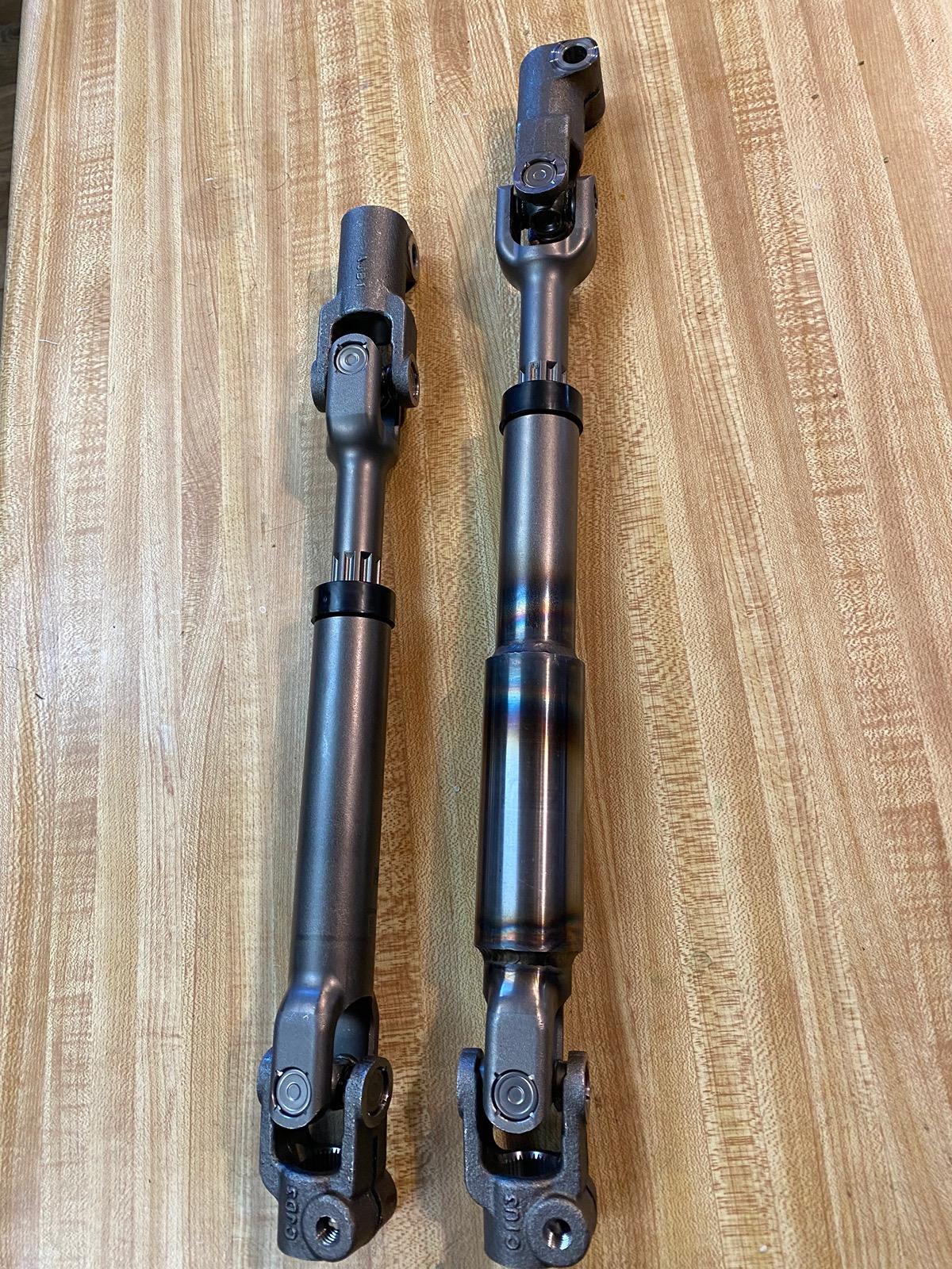

No , but have removed , lower airbag and removed and replaced the steering column section from e box under dash to the steering rack on the front subframe . Consists of 2 very tight 13mm head bolts , with a slip section behind brack pedal area .
Here is pic of slip column section .
Ford Maverick Dropping Steering column IMG_3064
left one is stock length , right one is extended for lift I created for my tremor.
