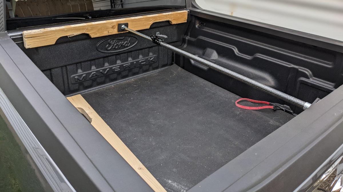

Same thing happened when I installed my drop in liner. I removed the old adhesive and used 3m vhb heavy duty tape and added a bit more in the center. I also used a ratcheting cargo bar with a board to apply pressure overnight to make sure it adhered fully.
