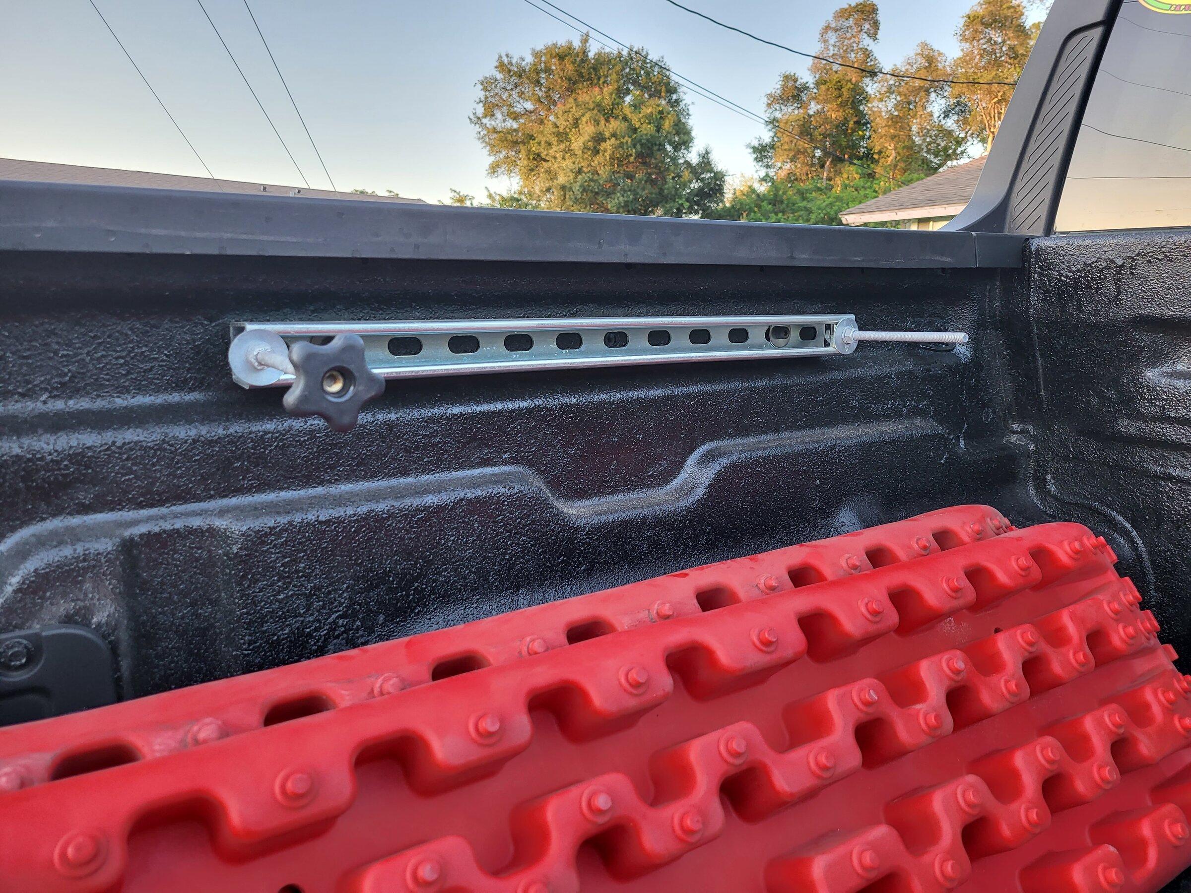

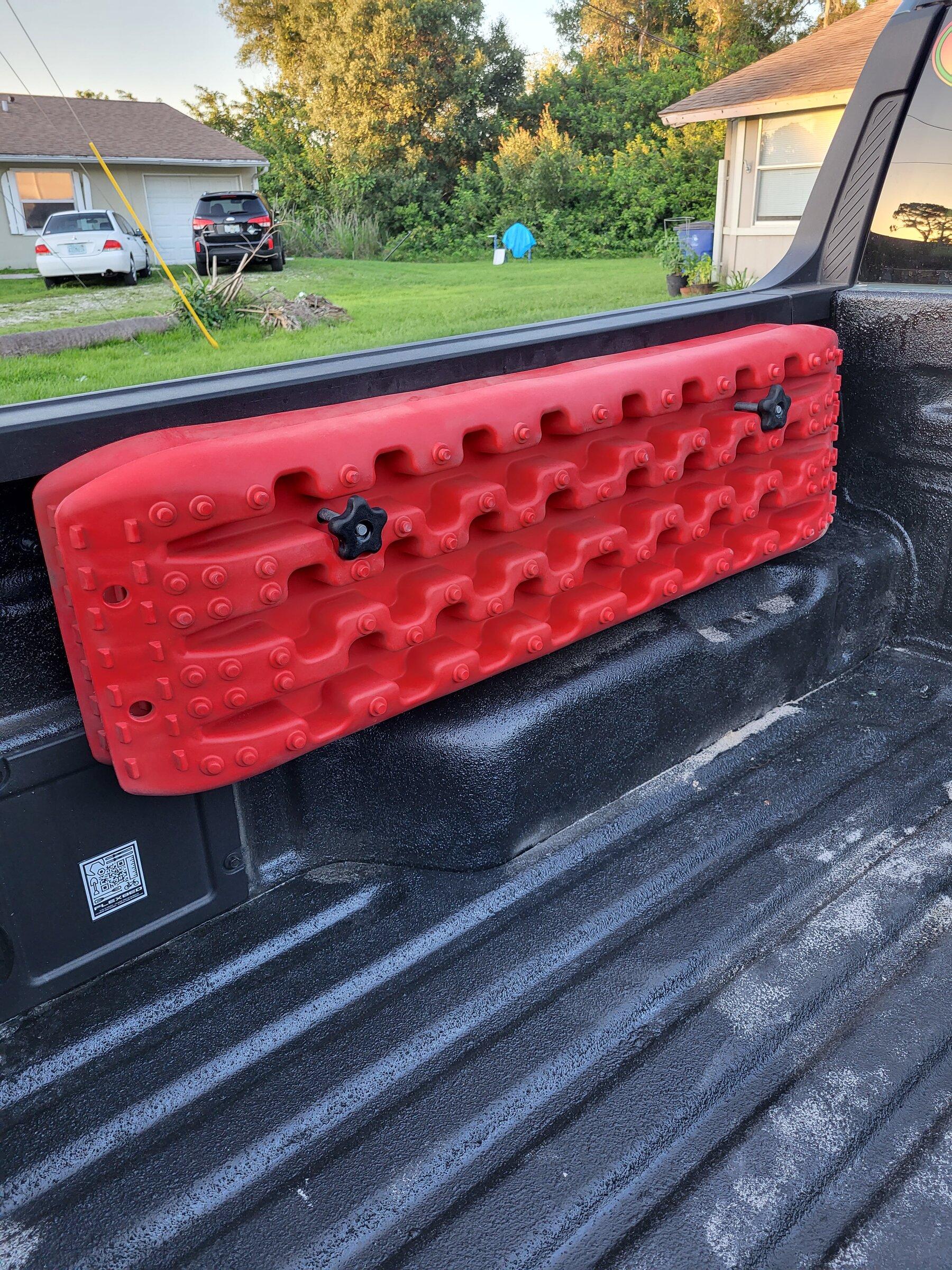

I used 2' piece of Superstrut steel found in electrical section of home depot. 2- 3/8" superstut nuts that slide into the track. 2- 6" x 3/8" bolts screwed in from behind the superstrut nuts. 3/8" lock washer and nuts to secure. Bought the 3/8" bolts with plastic on Amazon to secure boards.

That is very creative and looks professional. Might be a marked for that setup.
Thanks for sharing.
