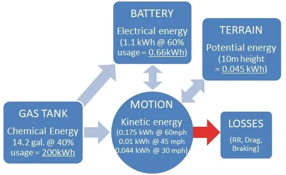

... your use of percentages is odd and confusing.
Not really. In linear systems, losses are cumulative. If regen braking is 90% efficient putting DC into the HVB, and the motors are 80% efficient turning HVB power into motion, the system efficiency is the product, 72% = (0.9 x 0.8)x100.
I look at it this way. More of a "use it or lose it" situation once gas is out of the tank.
