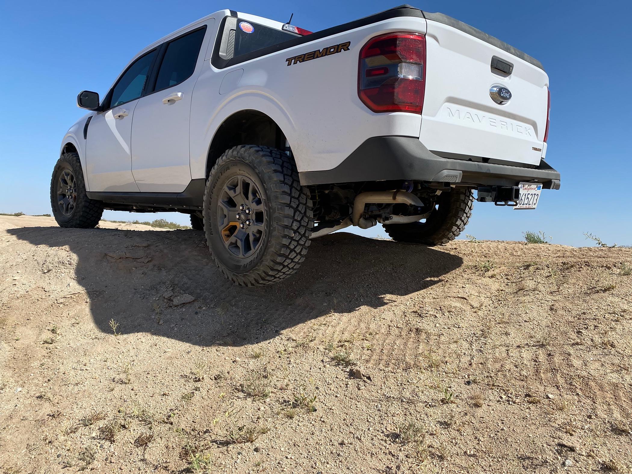

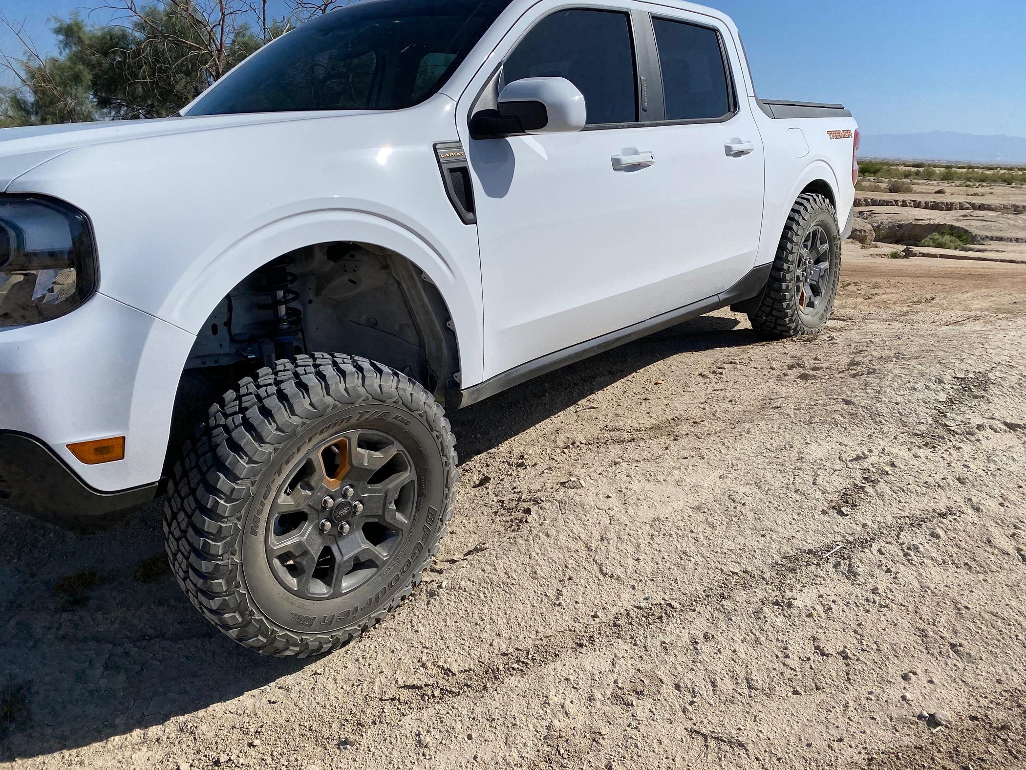

And everyone said I would be the first tremor!
4 1/2” lift and 4.5k miles plus another trip to the desert. Will post more soon.
My hero!!
Your truck is my trucks spirit animal. I so wish I had 2 Tremors one to keep stock for my wife and one to party with yours! Love what you did with the rear bumper, I would have personally tapered up a bit more to eliminate the lil bumperettes and put some hooks there. Maybe bend a nice piece of metal to the shape of the edge to finish it off. But what I am I saying Im still too chicken to cut mine.

More to come soon on the bumper !
Complete tube with departure skid plat back to subframe to accommodate a good bash plate for the diff.
