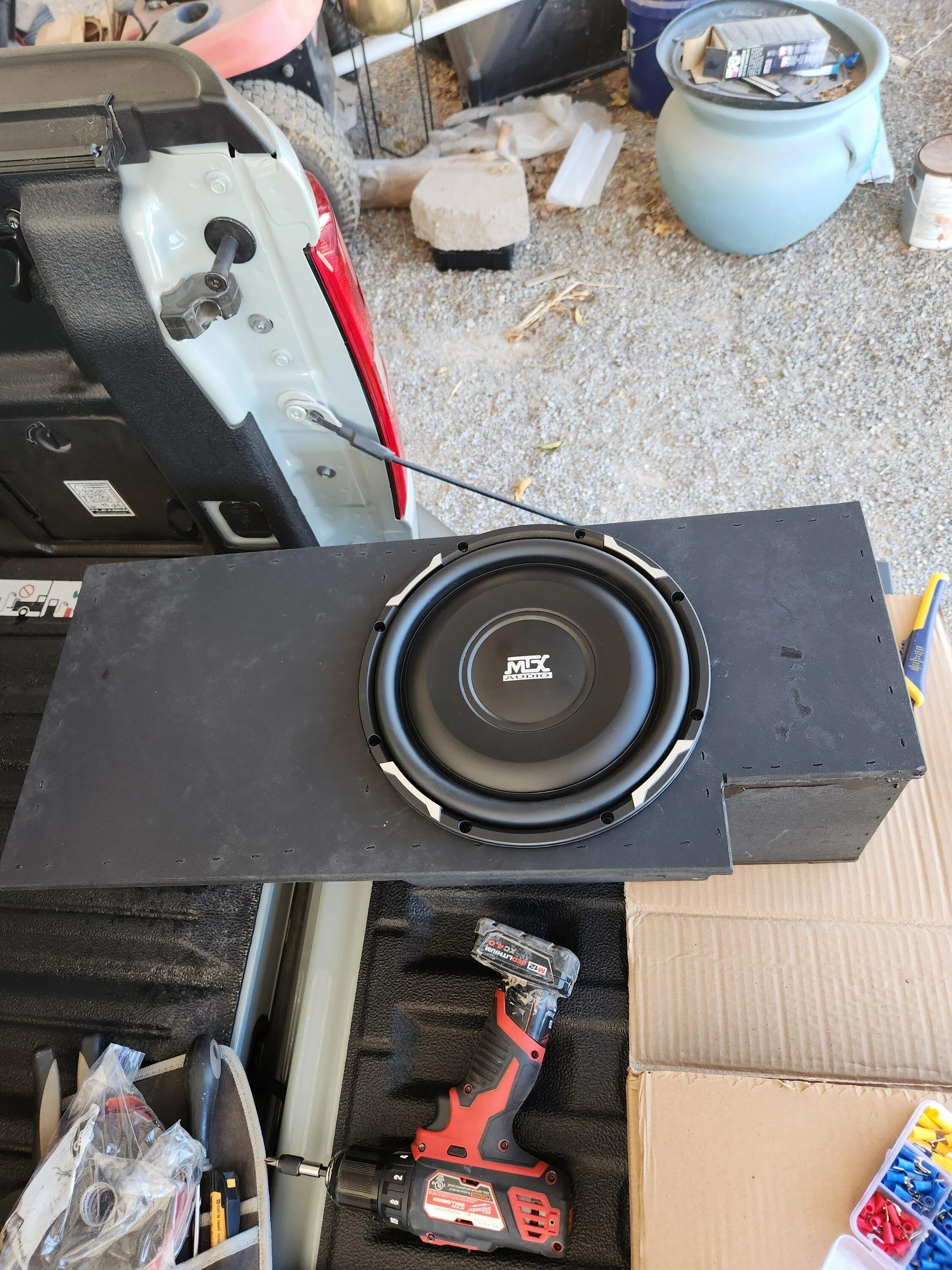

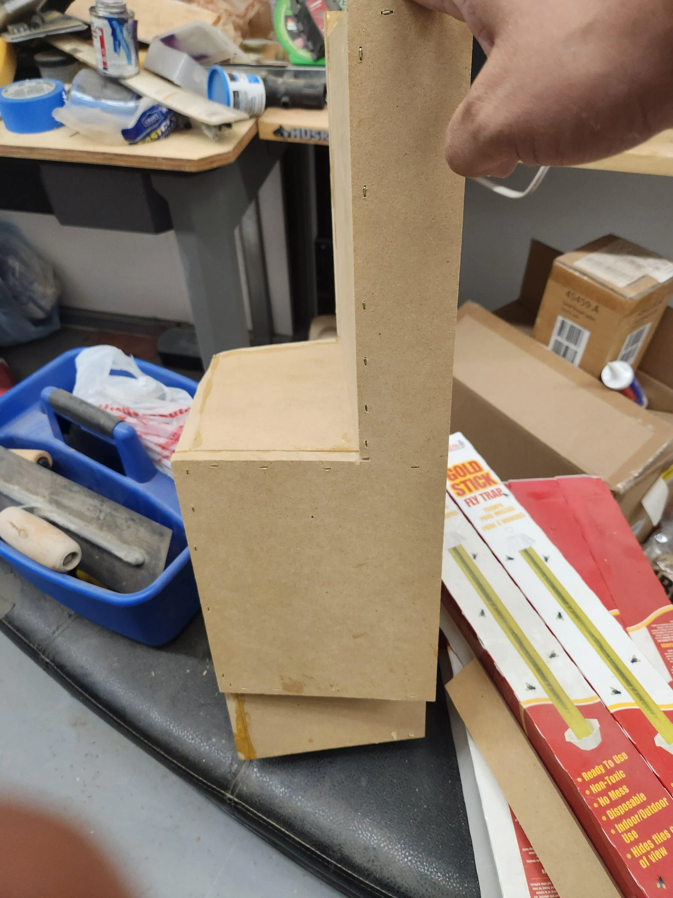

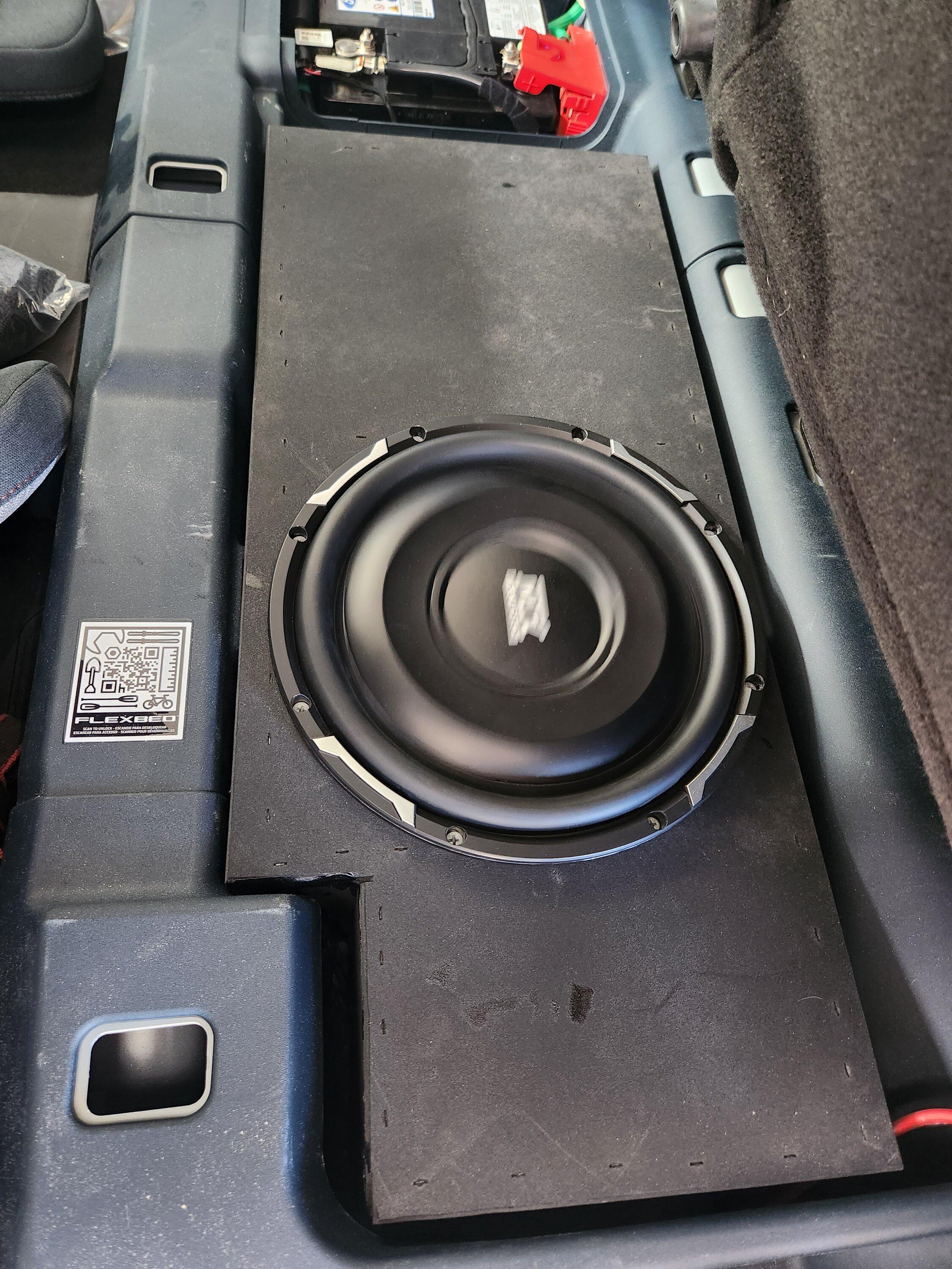

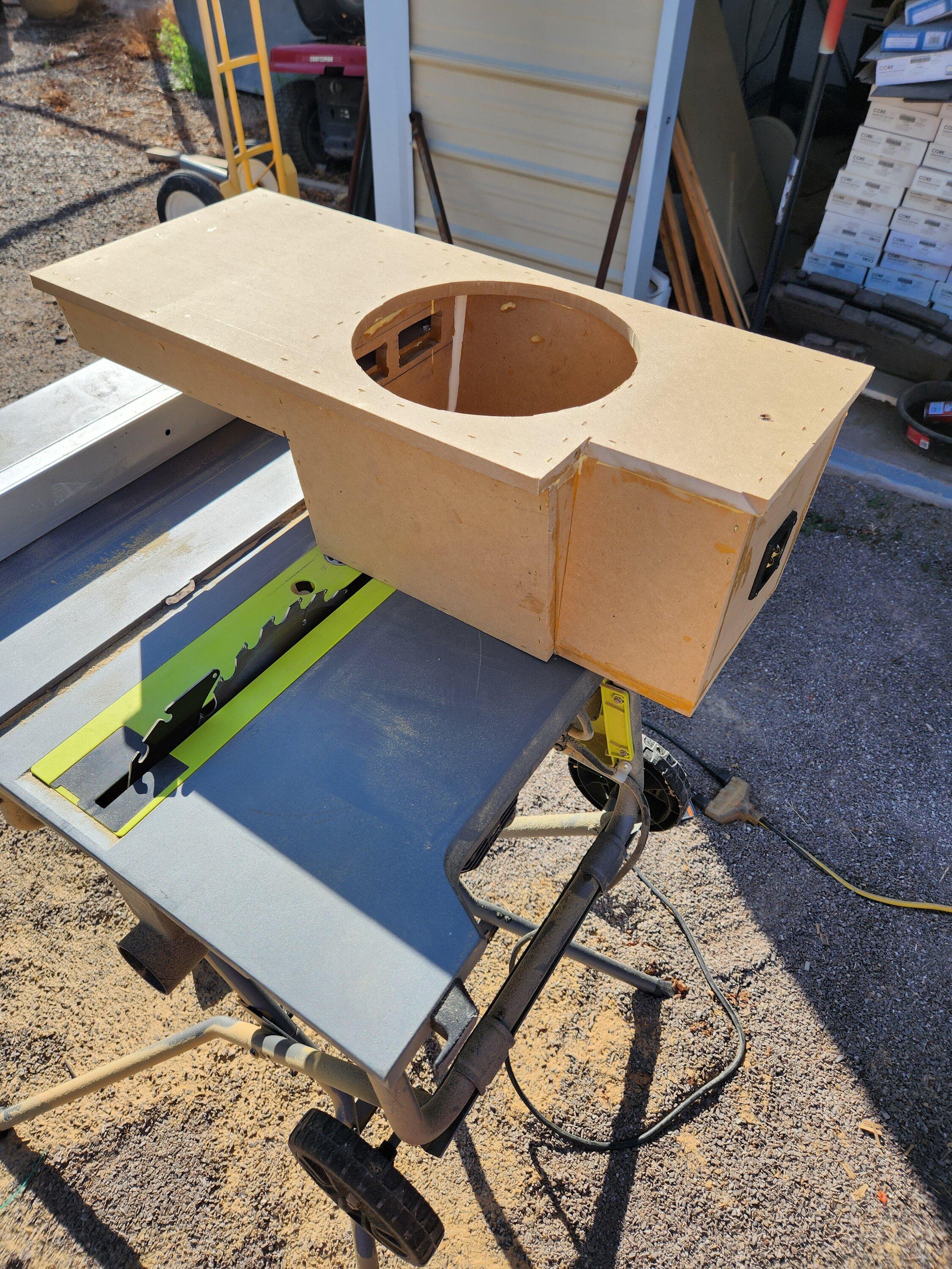

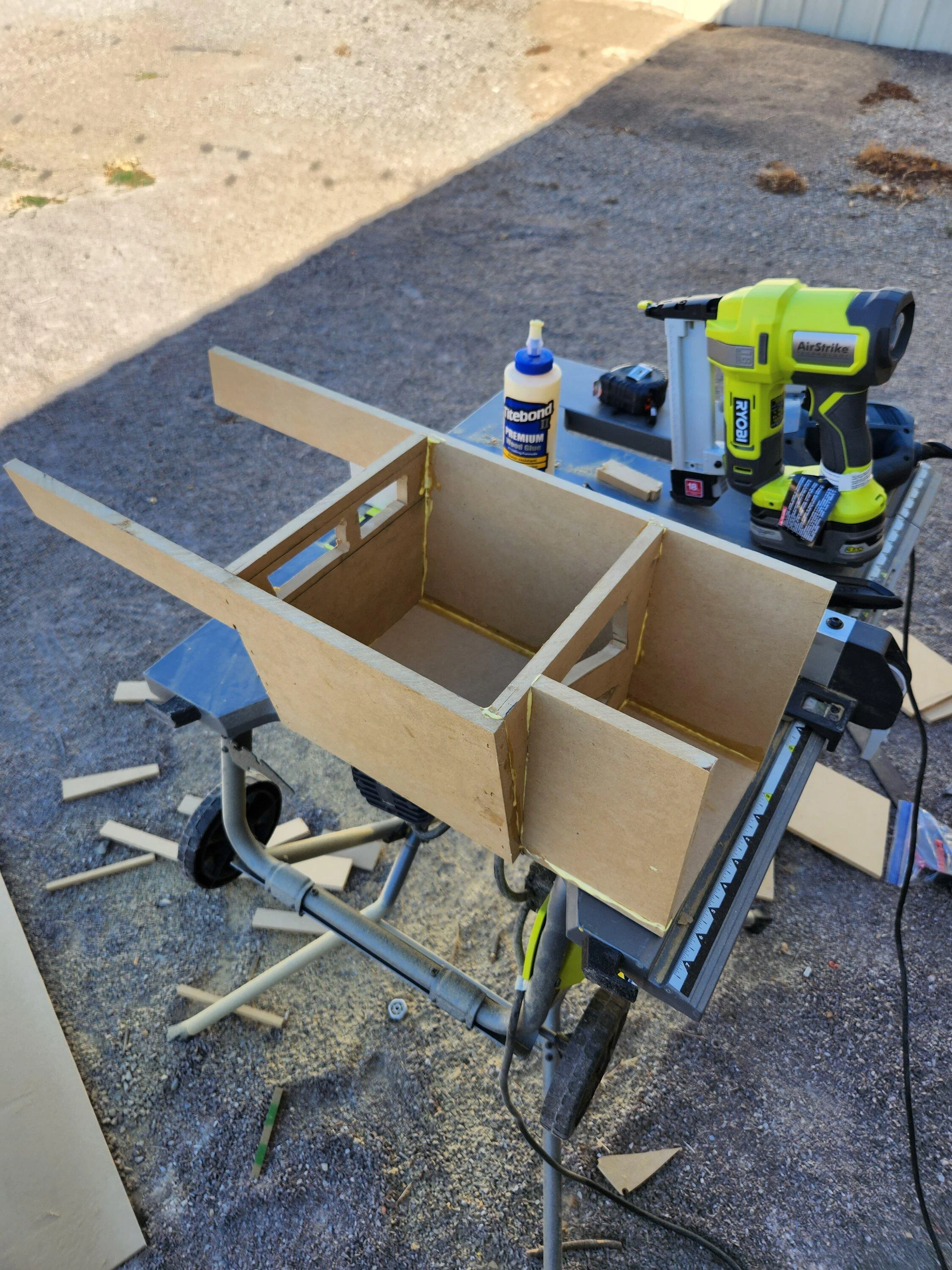

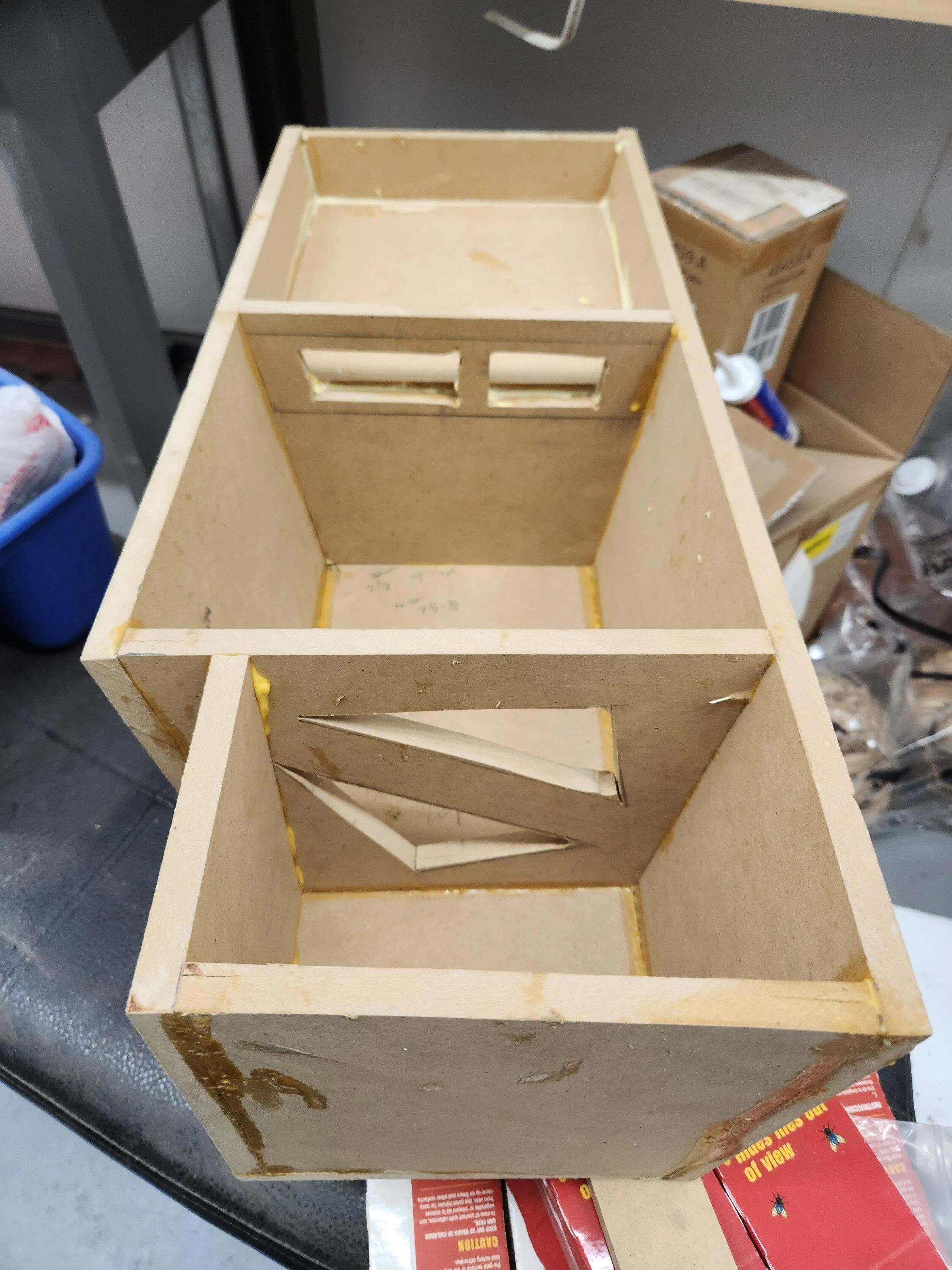

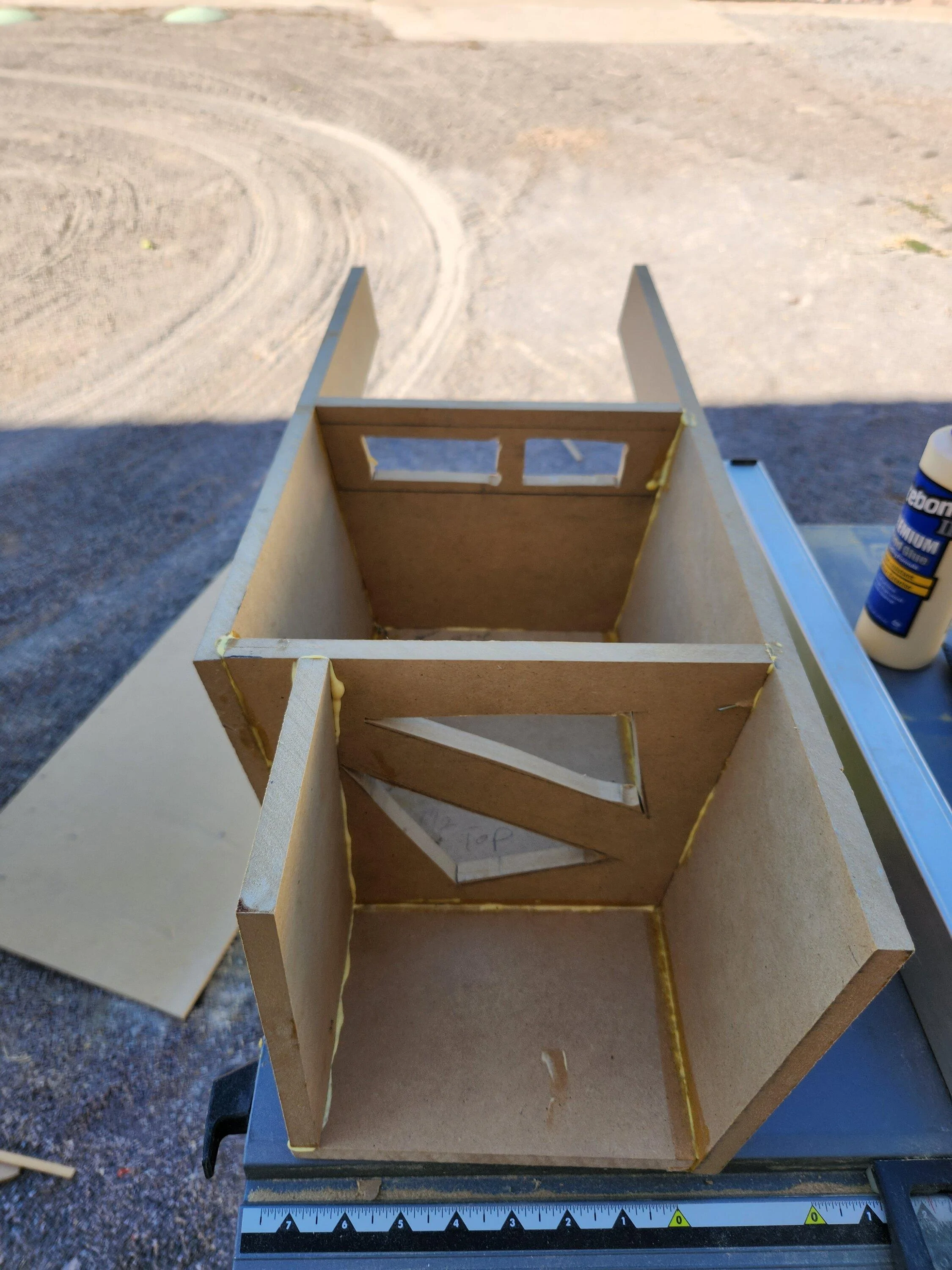

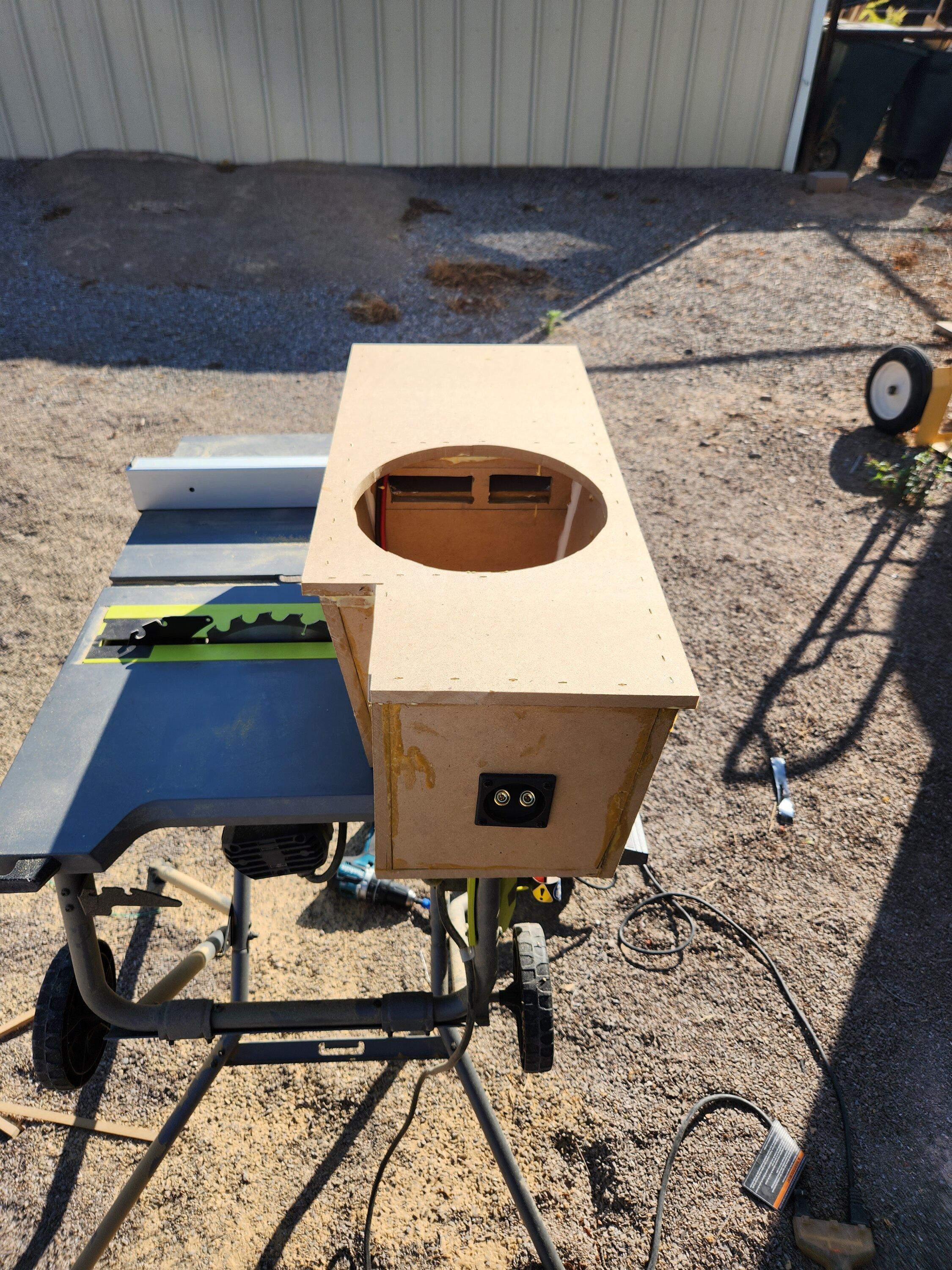

Ok so I am a cheapskate wanted to build my own subwoofer box because everything out there is so expensive ground shaker box 215 dolls or the custom box from sound decision over 350 plus shipping. They all are great looking boxes but wow I bought a sheet of 5/8 mdf and have started build the box here is my progress so far I copied the design of the sound decision box.

Looks good. Did you have to cut away any of the plastic bin? Also do you have a rough idea of volume?

No cutting of the bin it should have the same volume as the
Should be .7 look at ford maverick audio on face book I copied there box.
