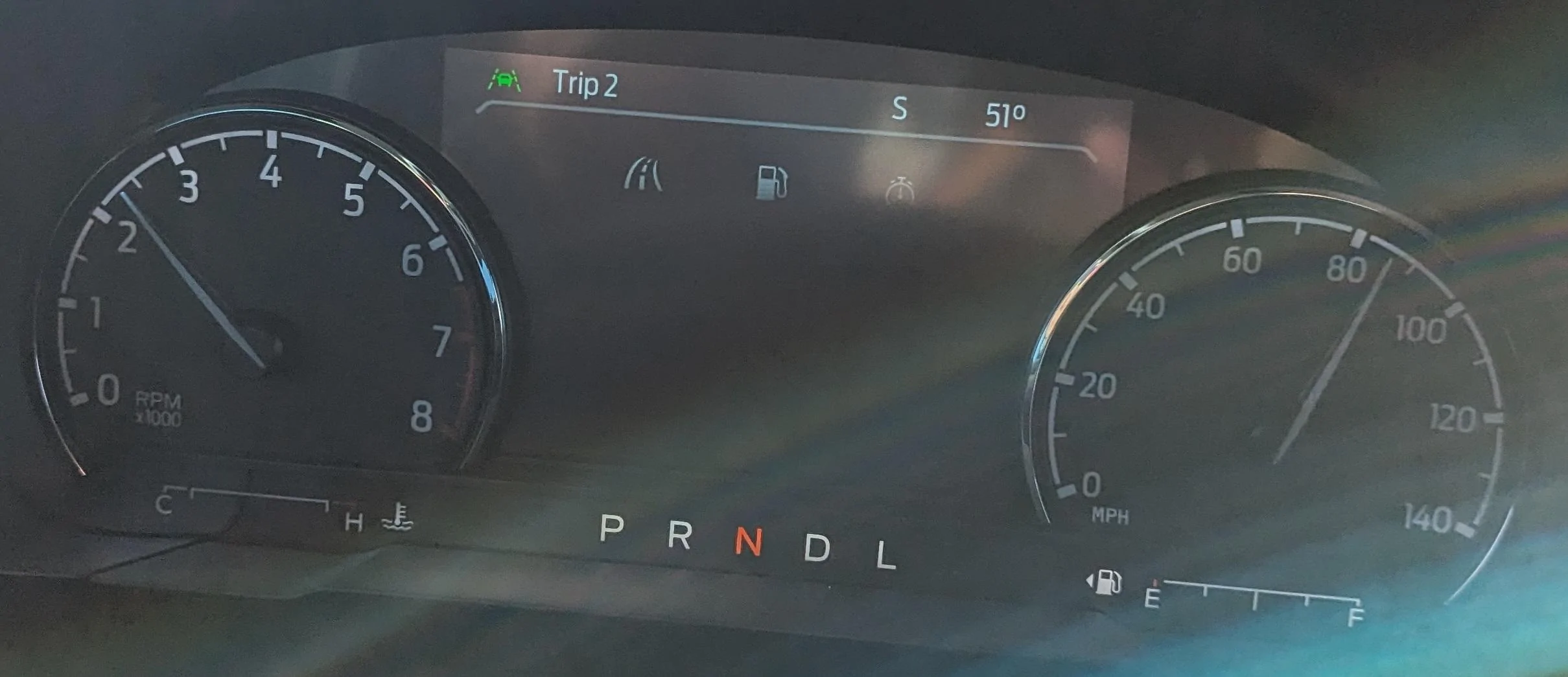

I am not a flat tow expert either, but the way the mechanic I worked for explained it is that at high rates of speed, the pressure created by the wheels spinning can overwhelm the pump that is spinning slower and can still cause damage.

I'm not sure if this is the situation, but I know some tunes will increase RPMs to match speed at higher speeds so you don't slam the transmission and damage it putting it back into D. Ford may have programmed that in here for that purpose.

Modern cars shut off all fuel flow when coasting in gear. When you coast in neutral, the [electronic control unit] then has to inject fuel and burn it to keep the engine at idle. When you coast in gear, the momentum of the car keeps the engine spinning rather than the fuel in the tank.
