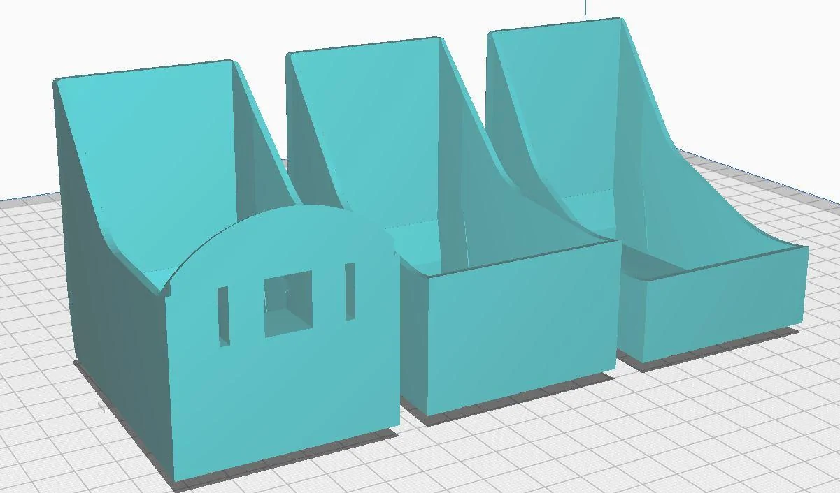

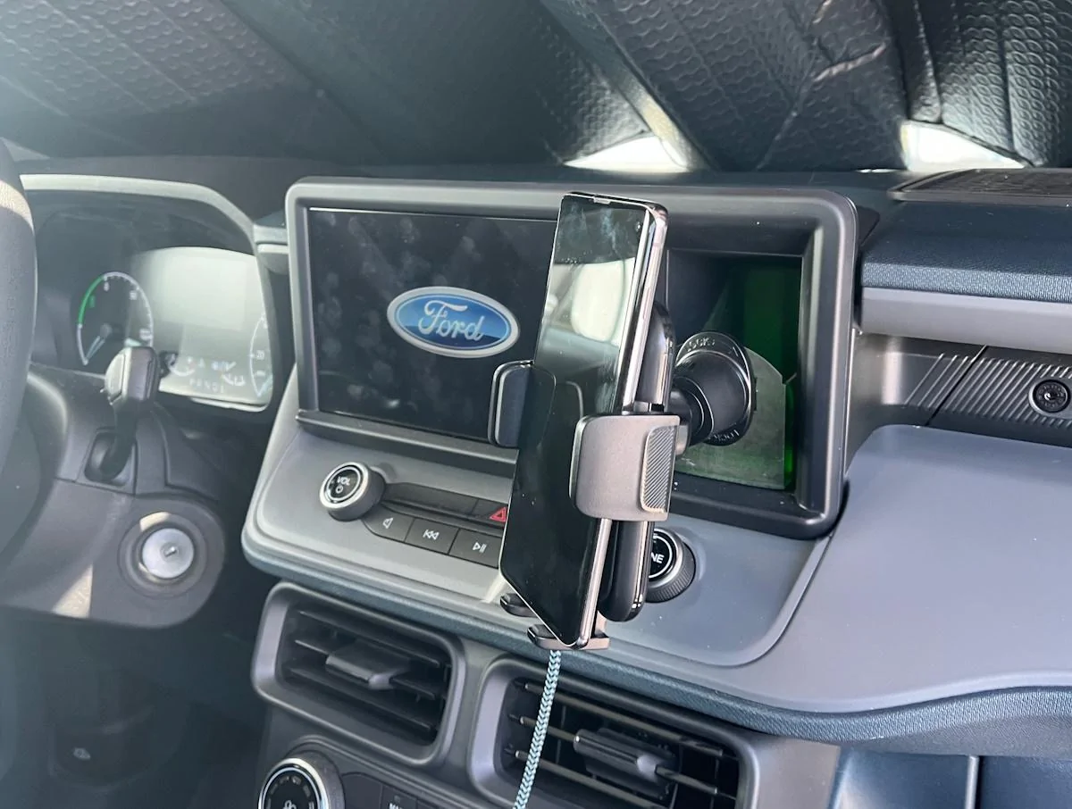

Designed and 3D printed 3 types of boxes that fit inside the cubby. Two designs are just plane boxes to hold stuff. Third design has a re-enforced front wall that holds a phone cradle for my smartphone. It uses the cradle that normally clamps onto the air vents. I put a small square nub at the bottom that fits into the square hole in the cubby. 3D printed out of resin so does not melt like PLA or ABS when it is 105F outside and 140F inside the truck. Fits both 2022 and 2023 models.

Nice job! Those files would be worth sharing!

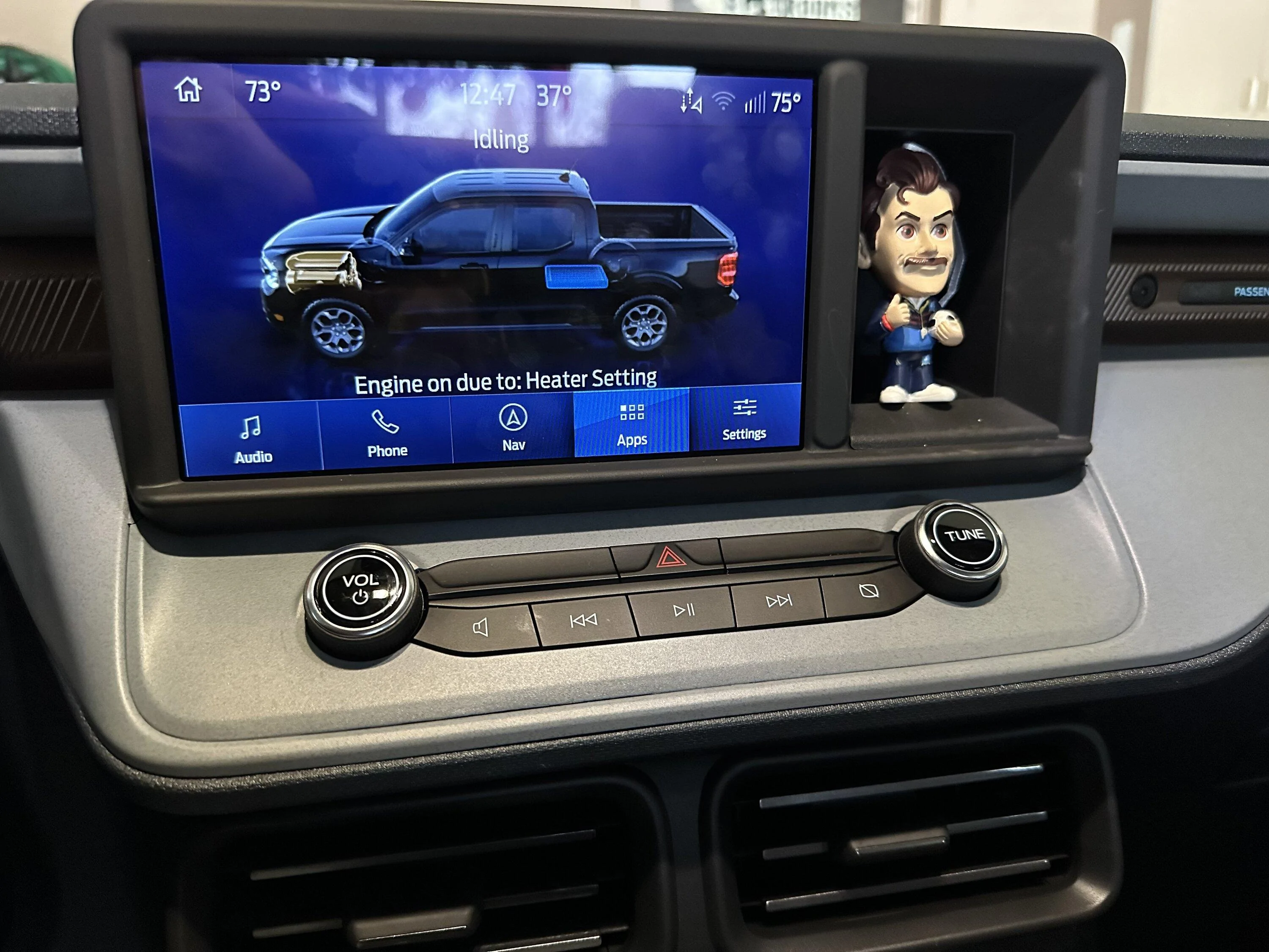

I am an assistant soccer coach at a nearby community college, thought this Ted Lasso ornament would be perfect!
