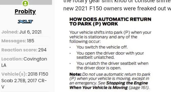

Car Wash Update:
Drag Chain style: 10 washes
Since having learned of CAR WASH mode (aminal and huunvubu) I've experienced zero problems with ECM dumping Trans back into park. This includes "popping open" driver door to first latch position during drying cycle.
Drive Thru style: 10 washes
Again, with CAR WASH mode ( Trans in Neutral, press "L" button or LOW, then "OK" on message center) 3 out of 10 times the ECM dumped Trans into Park while slow rolling thru dryer and door ajar!!!!
ANYBODY ELSE?.......congrats! FESS UP
Seat Belt fastened, motor running, driver door ajar...must be ARP
