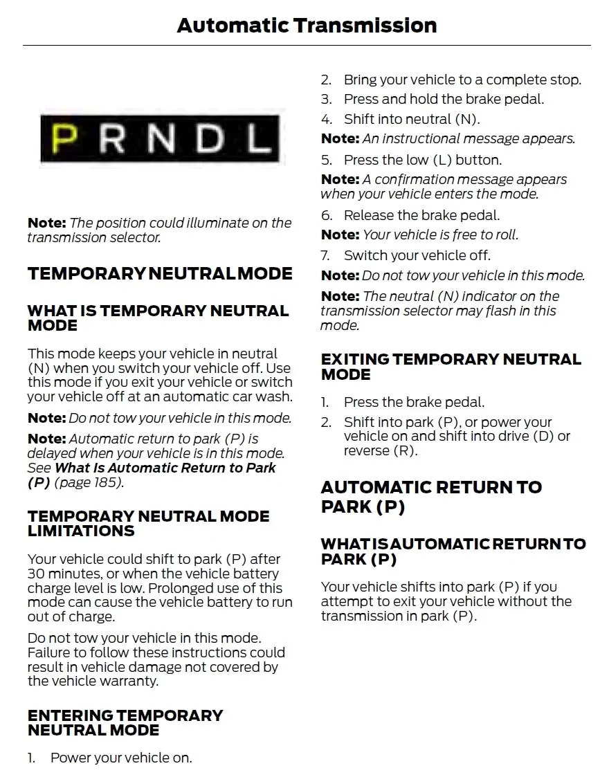

Twice now my local car wash has put my Mav in PARK while going through the wash!!!!
First time I'd thought it was nerves and accidently did it myself when Knob is easily "bumped"...but then yesterday- NO ACCIDENT!
WTF is that all about? EMI or moisture
'cuz both times now it happened at the end and at the blower drying phase of wash.
