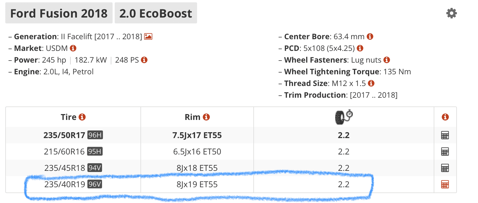

From a 2018 Ford Fusion 2.0 EcoBoost:
Think these are the same or very close:
https://www.1010tires.com/Wheels/DAI+Alloys/Autobahn/DW4819001
Wondering if these could be used for winter rims…
