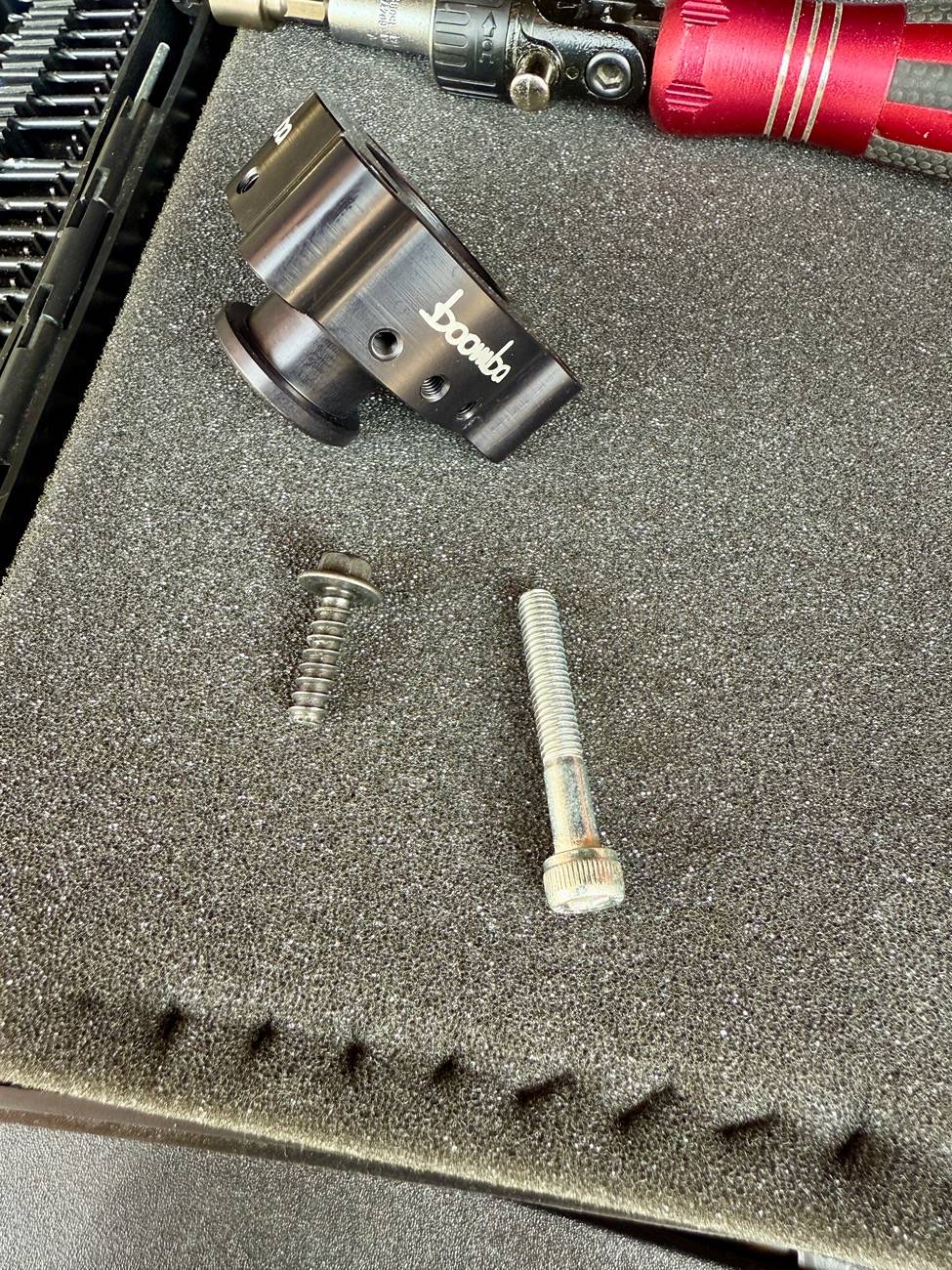

I looked but couldn’t find anything. Does anyone know the the thread/pitch size of the stock bolt on the bov/bypass valve? The boomba bolts obviously don’t fit.
and no the hardware stores want to give me wood lag bolts. That don’t fit. Thank you in advance

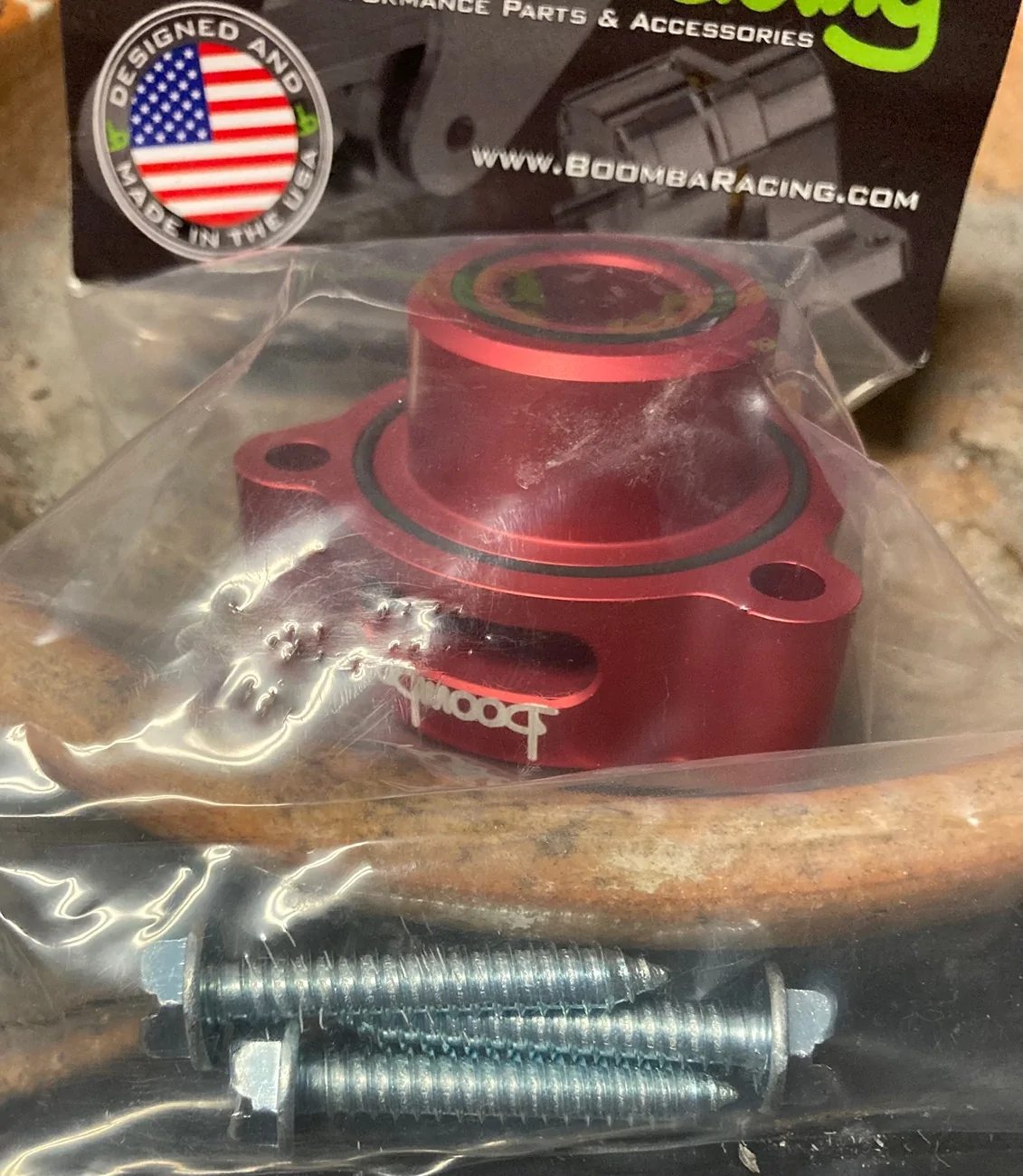

Searched everywhere and never found the right answer. For those who want screws that dont cut new threads/making it easier to return to stock order the following
Ford part:
W506858S437
Same M6 size and 35mm length as what boomba sends, but in Fords weirdo thread pitch on some of the MPC ecoboosts (not applicable for the fine threaded BOVs. A part number for that is in another comment here)
