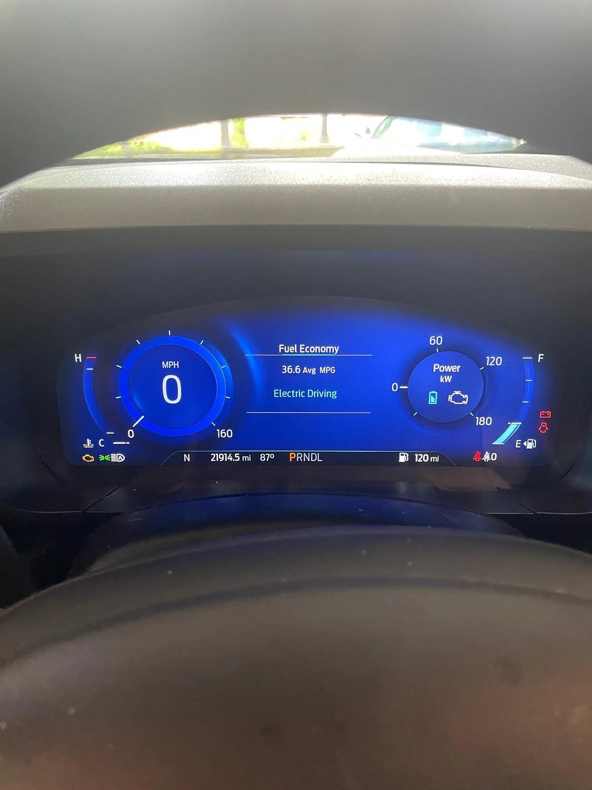

Some others have also posted about blank screen with key on so I contacted Dave for thoughts.
If he had to guess: if maybe if Escape is push not key possible conflict in ignition

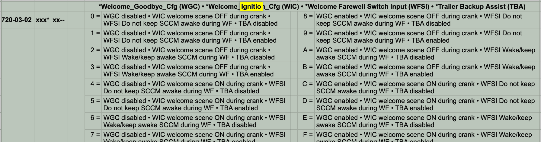

Send me a picture of what you’re seeing on your cluster! And maybe a picture of what should be showing up ! I can try to find the exact coding that way. Or even better send your factory as built ipc vs your as built ipc coding now

Sorry Econ, never saw your reply , I played around with it today and you’re right on. Change 4th “C”. To a “6” XXX6 . Txs for your input.you and Ryan got it going.
Awesome!

Well seems if you have key on screen you lose the welcome screen. When you open the door.I tried all the hexdec and was unable to keep both. Hope someone more on board with forscan can.
