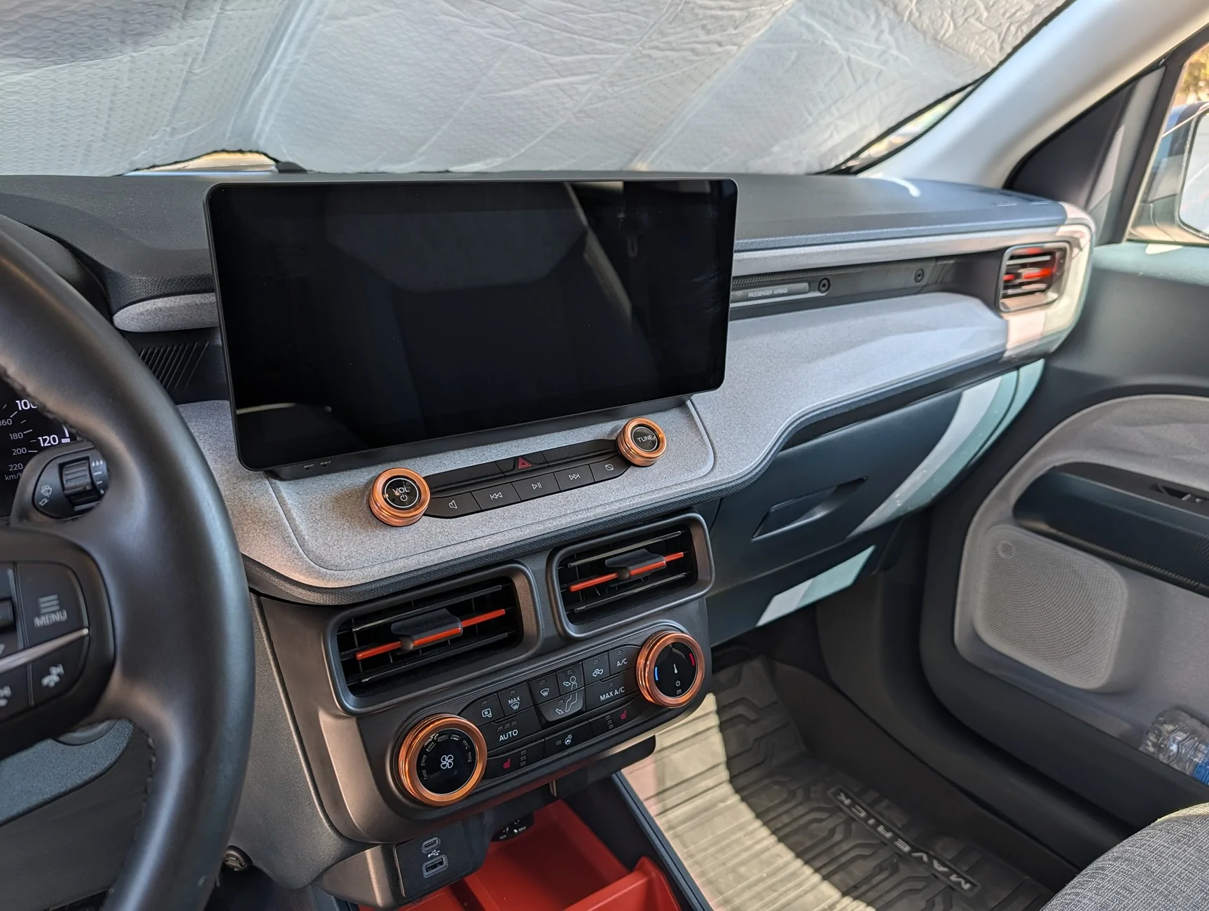

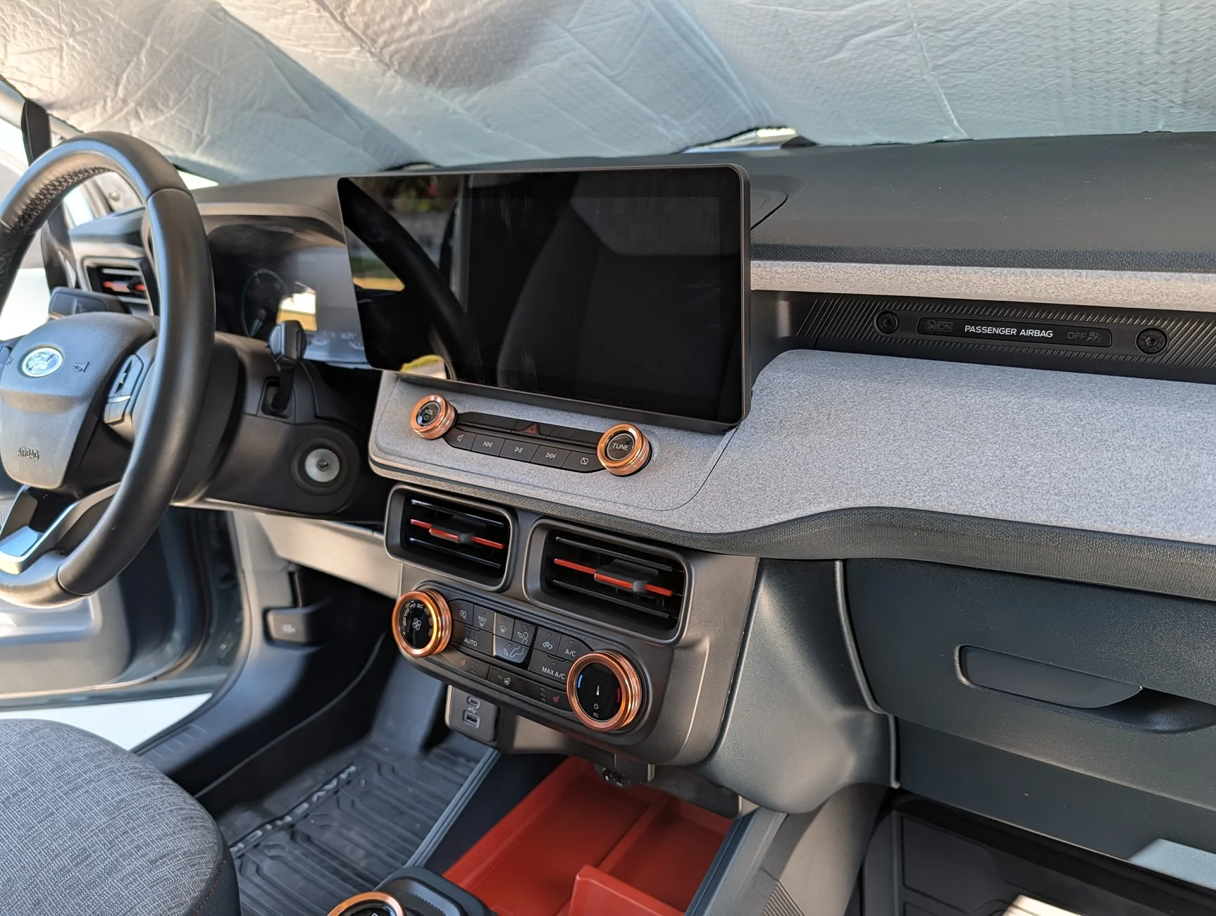

Hi,
I just installed the Dasaita unit in my 2023 Lariat hybrid this past week and I love it so far compared to the stock radio.
The install was not bad at all with the help of their YouTube video. The kit comes with lots of extra cables. I only used what I needed for it work with the minimum. I did not need the SIM card, GPS antenna or the extra usb cables. I’m satisfied with the stock look it gives it.
FYI:
The only problem I noticed was that with calls people say I sound far away. So I need to figure out why that is.
The reverse camera seems a little slower to engage than the stock radio.
I did contact the manufacturer support about this and they sent me a link to update the firmware and MCU. I haven’t done this yet to see if it fixes any of these couple issues.
My Maverick came with the no SYNC radio. So installing this unit was nothing too concerning for me.
Doesn't this unit come with its own phone microphone that works separately? The stock microphone for my 2023 XLT Hybrid is on the drivers side pillar. The videos I have seen to install this kit has you running a wire up through the passengers pillar and to the center roof area.
