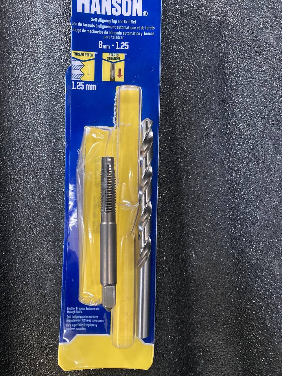

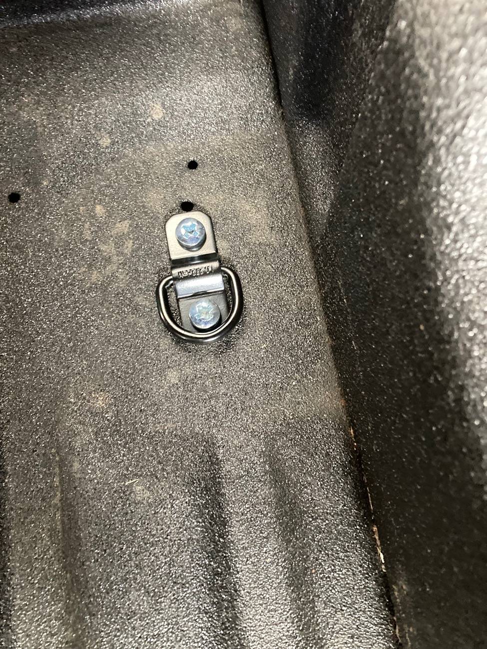

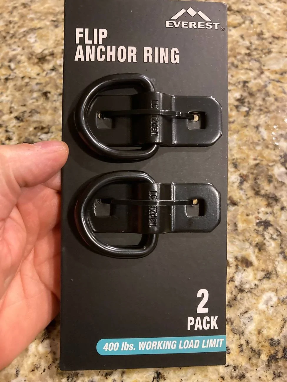

I just added a pair of D-Rings to the bed of my XL, because the XL does not come with them I've learned. I first looked at the FORD part numbers and did a search for prices. It was easily over $50 for Ford parts. I did the whole thing for about $22.

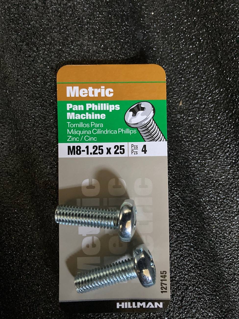

I bought the D-rings from AutoZone for $7.99 for both, the 4 bolts for $2.36 from Lowes, and the tap/drill bit for $9.00 also from Lowes. Add tax and it's just over $22.
Pics attached, I hope...

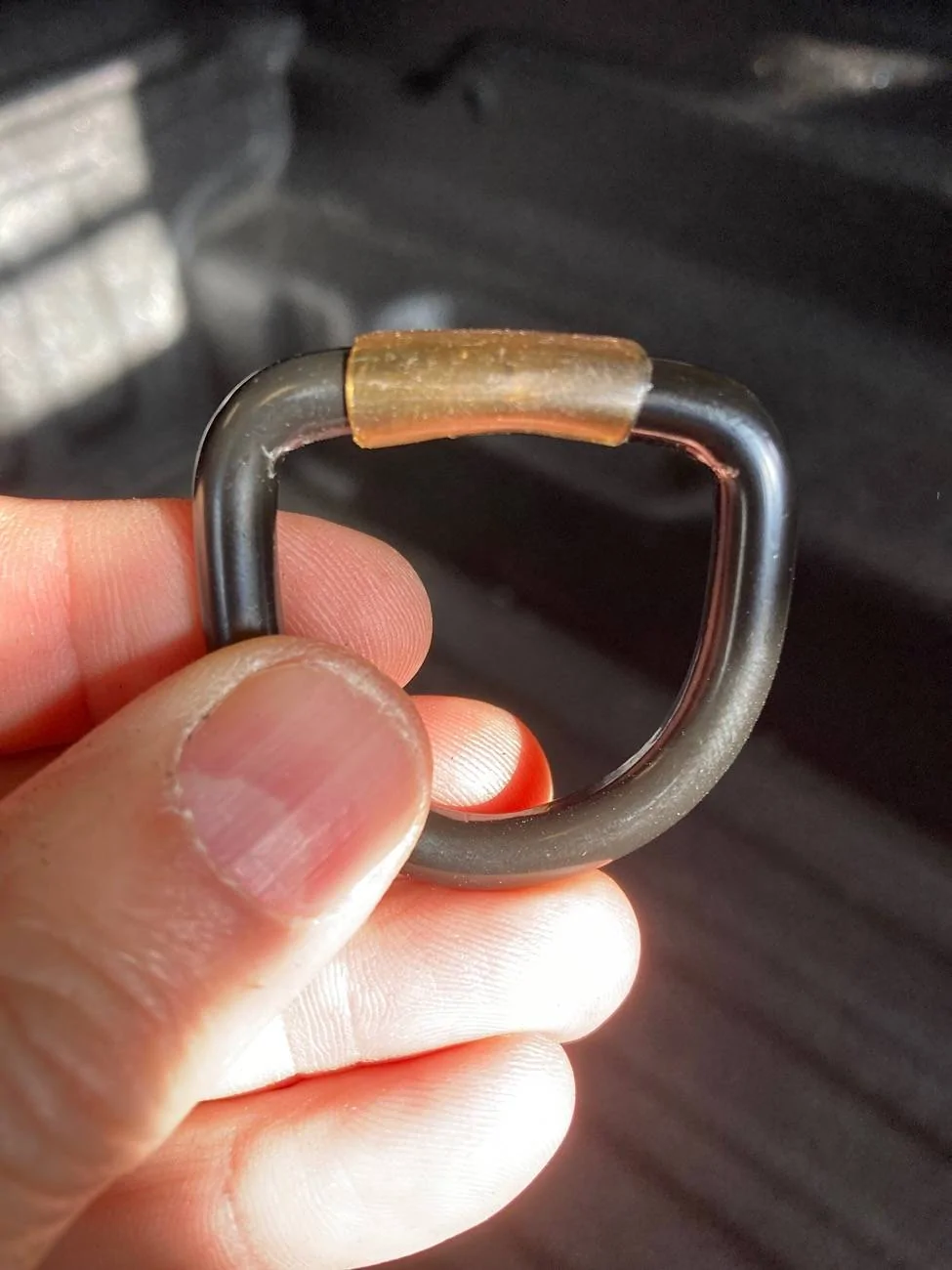

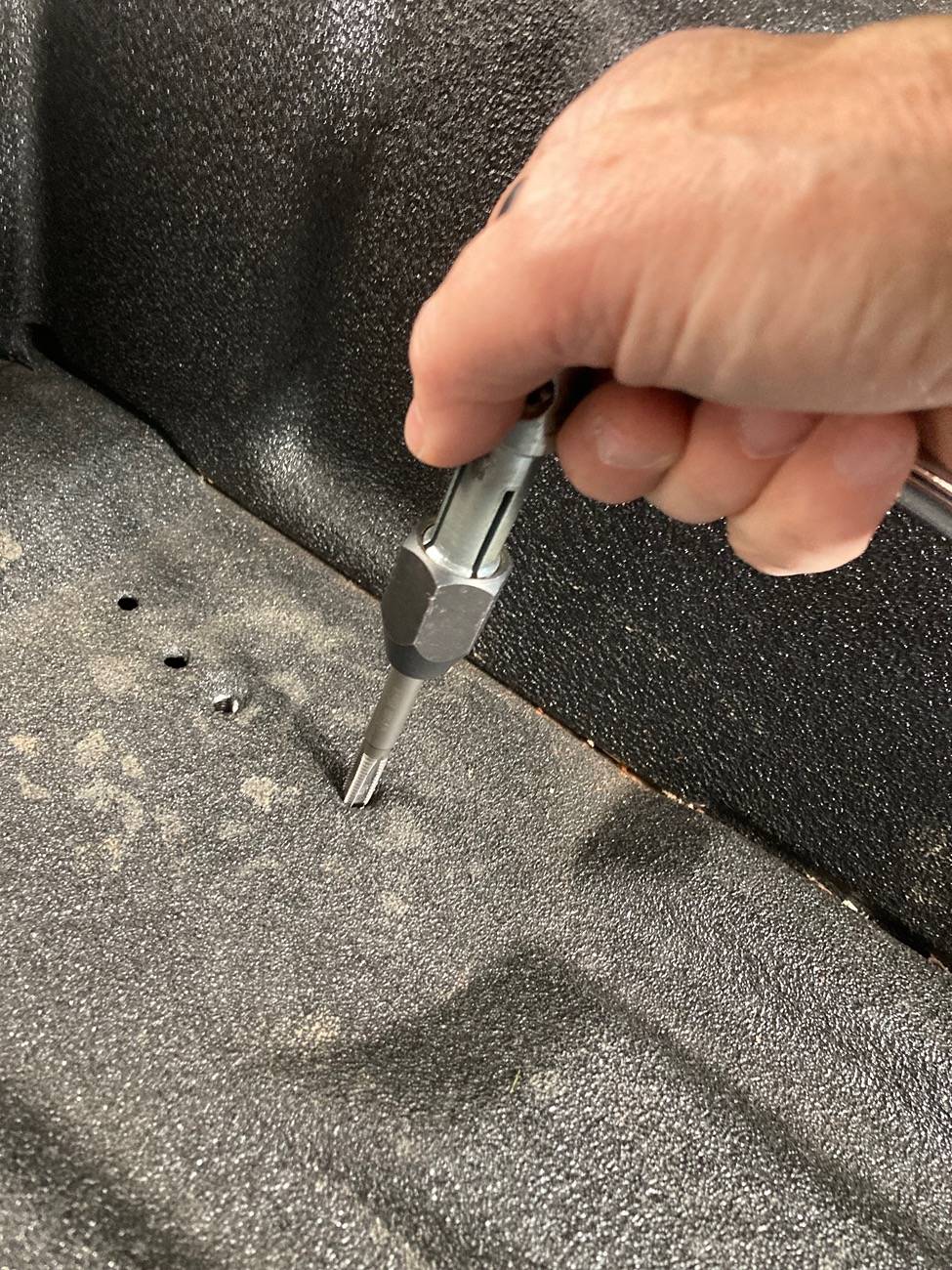

The install took about 20 minutes. I did not need to drill the holes out. The tap fit in nicely and the threads came out great. I did stick a piece of wire coat hanger down the holes to make sure I wasn't hitting anything first. I cut a couple of short pieces of plastic gas line to keep the Rings quiet too. Then it was just screw the bolts in and done! View attachment 185505

Was the distance between the two mounting holes on the D ring the exact same as the existing threaded holes on the truck bed?
MYMAVXL
MYMAVXL
Chuck
Dec 18, 2023
100
123
Connecticut
Yup…perfect fit!
