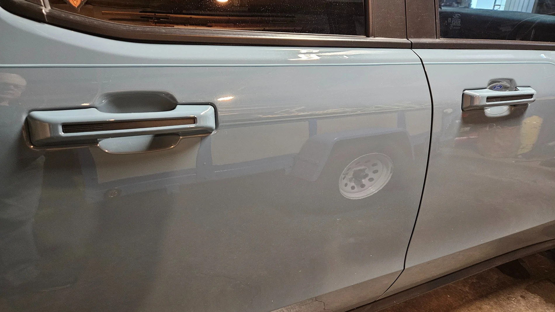

How did you paint them

They came out great for sure!

Nice! Looks like a Lariat now. Honestly, I don't think it'll cost all that much to incorporate body colored ones to all the trims.

They look great! First thought you had also applied a trailer decal on the side, but decided it really was just a reflection!!!!:unsure:;);)

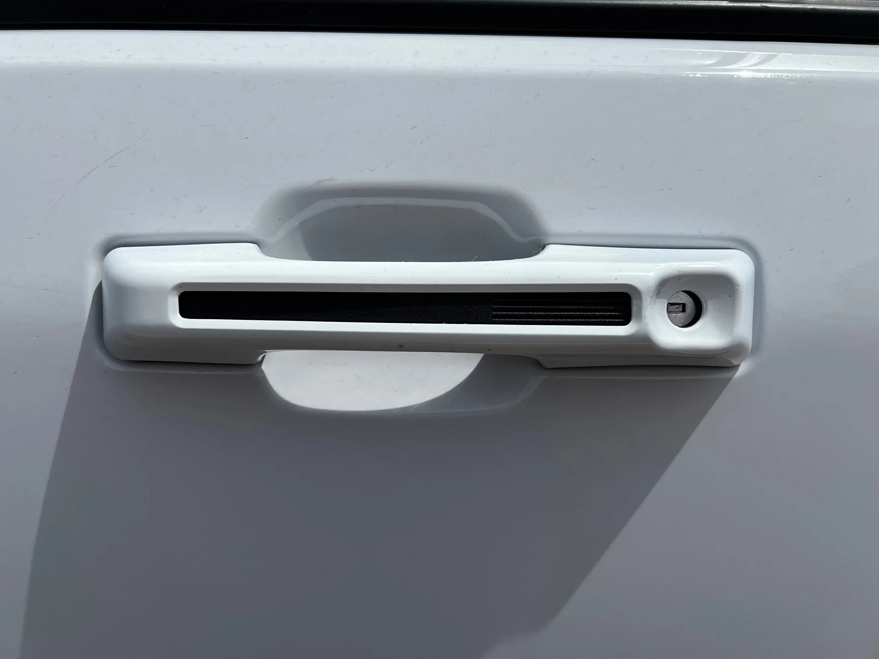

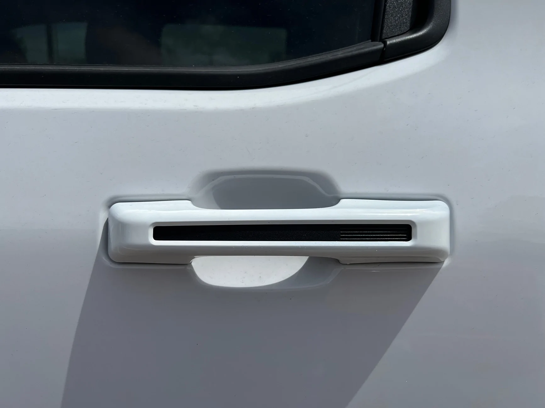

I got over lays on Amazon prepped with plastic adherence first then primed then color followed by 2k gloss.
The over lays from Amazon have 3M double sided tape in them. That’s what I used.

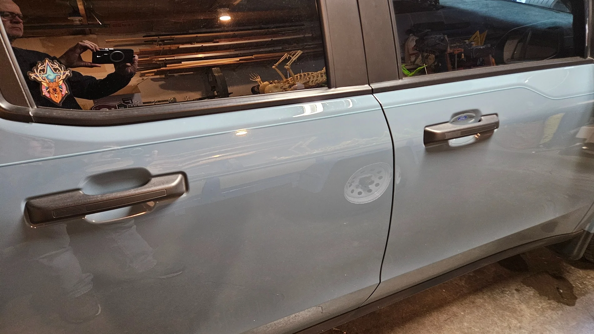

The before and after of the door handles painted think they came out great.
Looks good..I did mine the same way about 6 months ago
