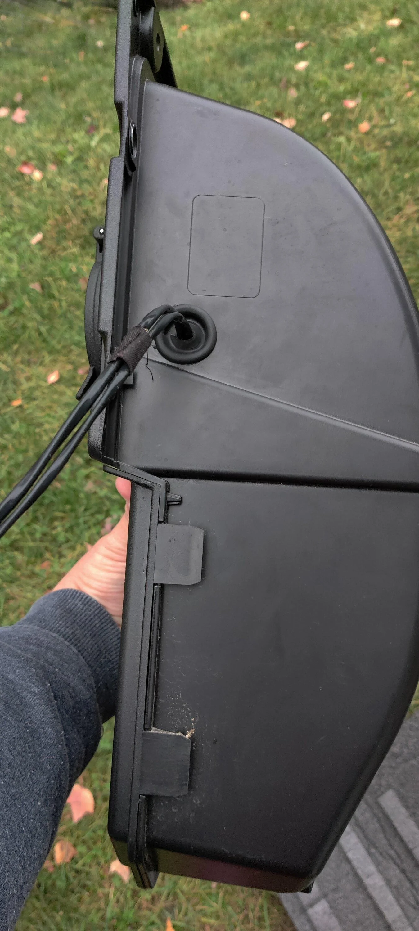

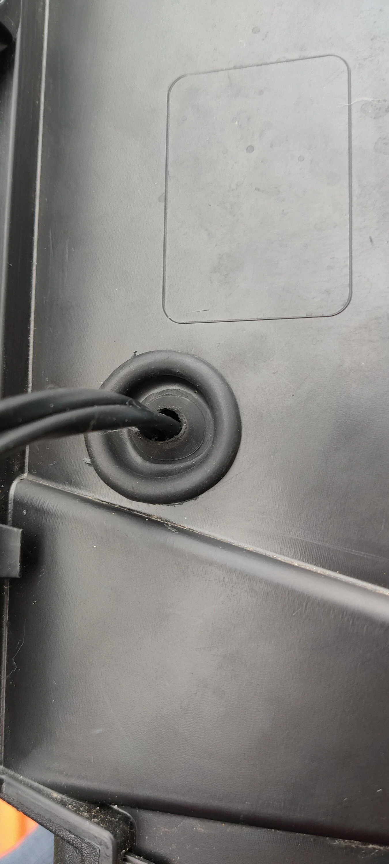

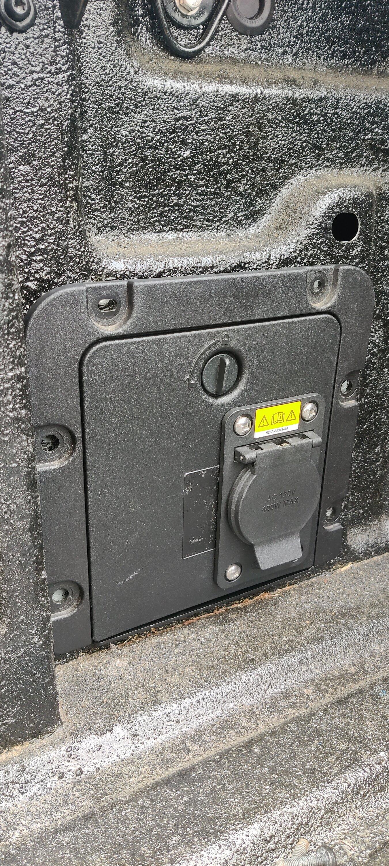

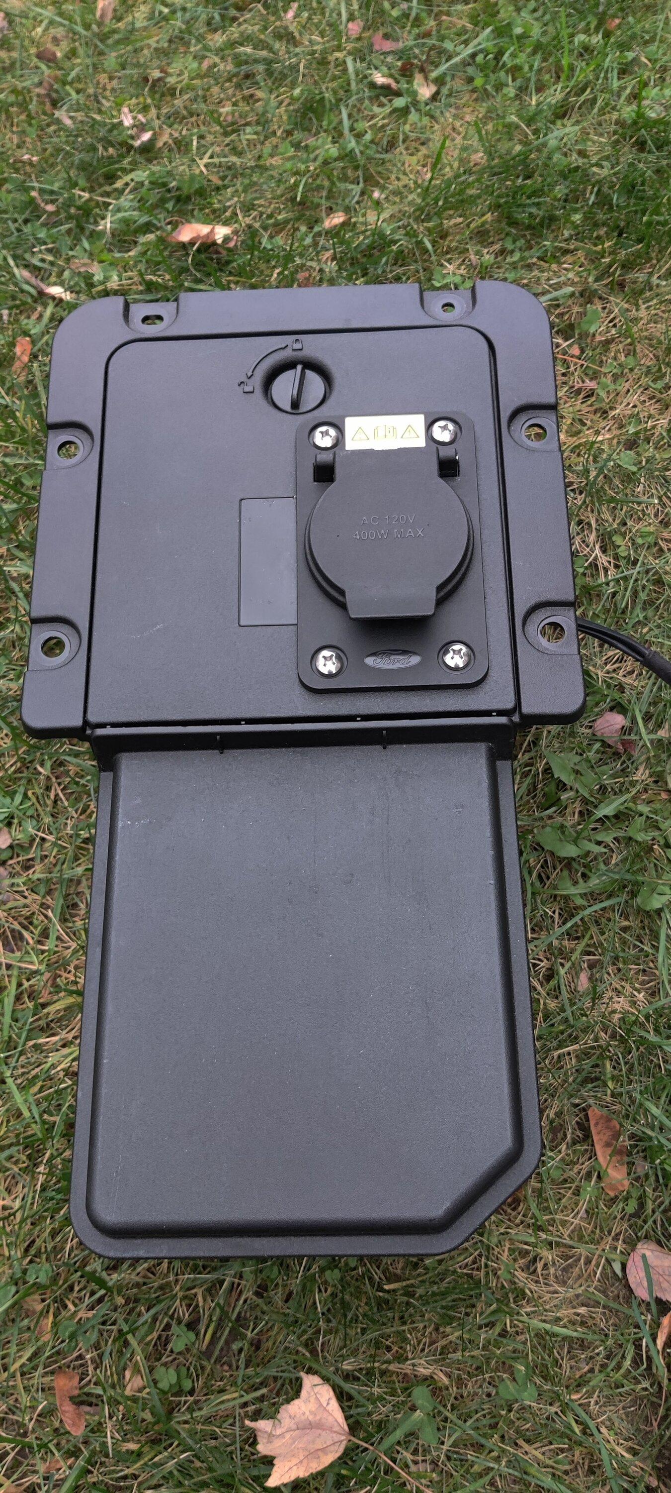

Wired in the bed cubby outlet. The gasket came out perfectly! Has just enough give for the cable to move and keep dirt out. Not done with rust proofing and blocking the left rear gap, cubby not screwed in.....yet.
Why not put the plug on the inside of the cubby? Make it kinda hidden?

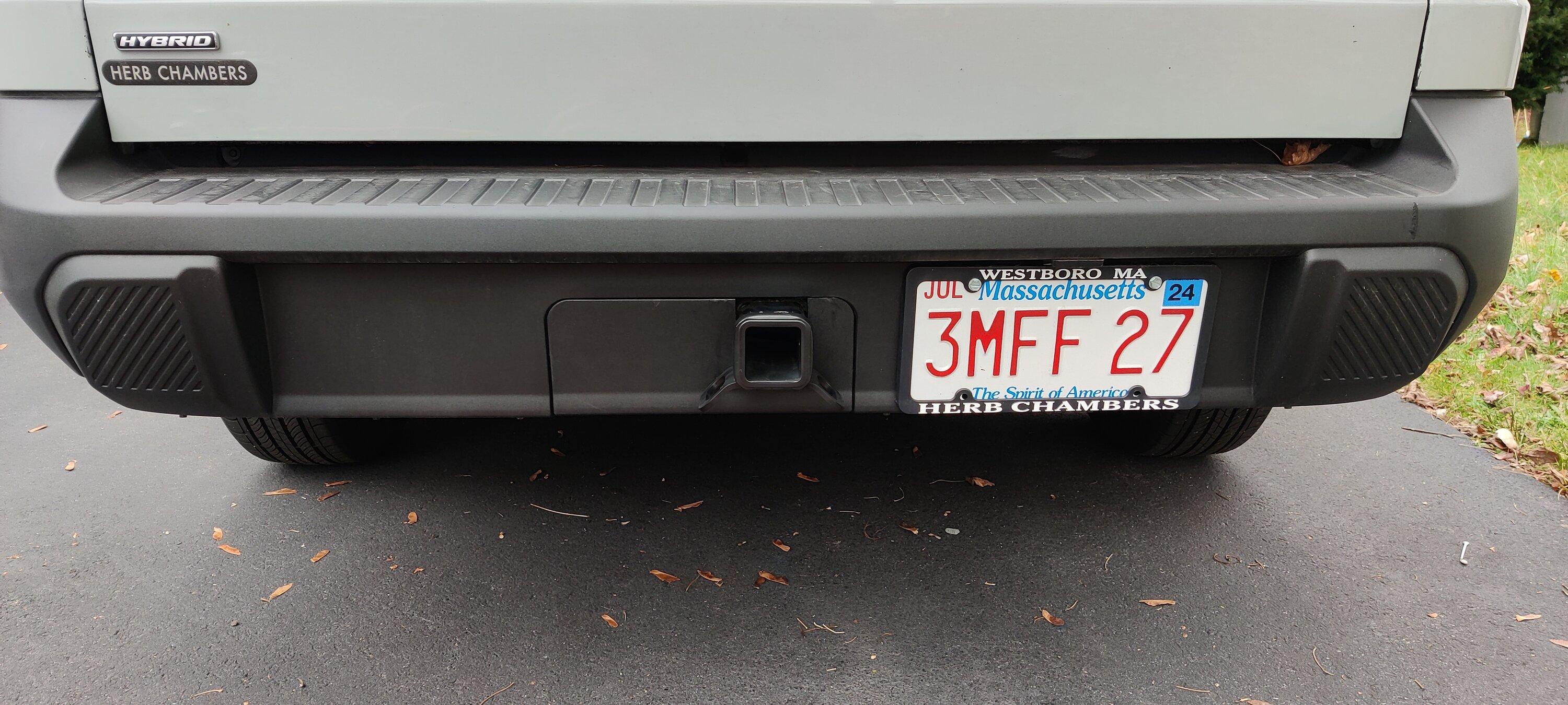

Had time today to get some long waited mods finished. See ya later trailer connector.
Is this 3d printed? Any chance you could post files?
Does not look 3D printed to me. Looks like they just cut the blanking plate that comes standard on Mavericks that don't have a hitch. You can probably order one from Ford for pretty cheap
Couldn't find a good spot inside to mount it to. I wanted to keep the original outlet which is kinda on the larger side.

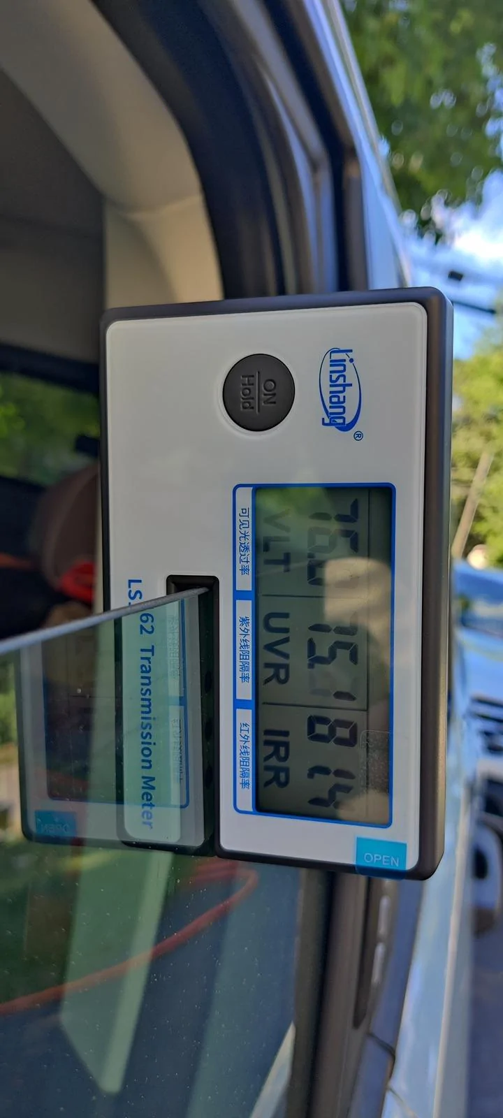

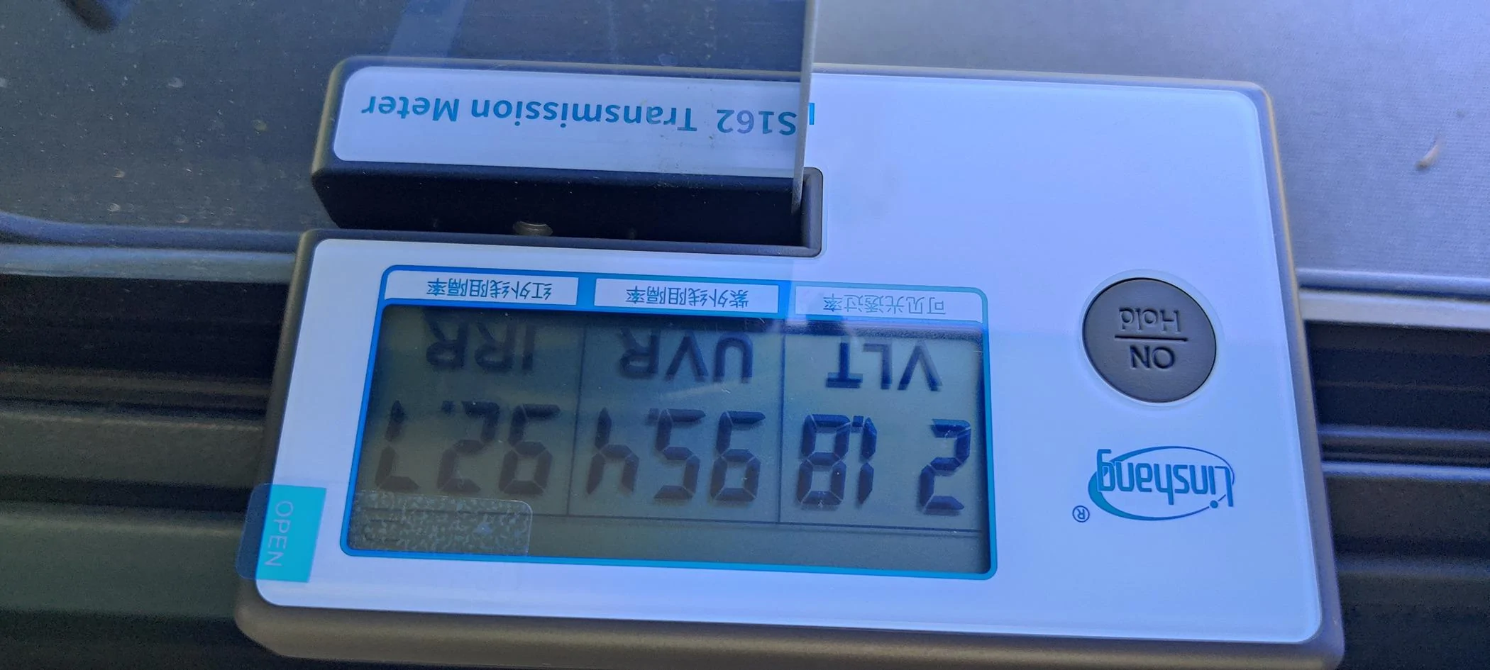

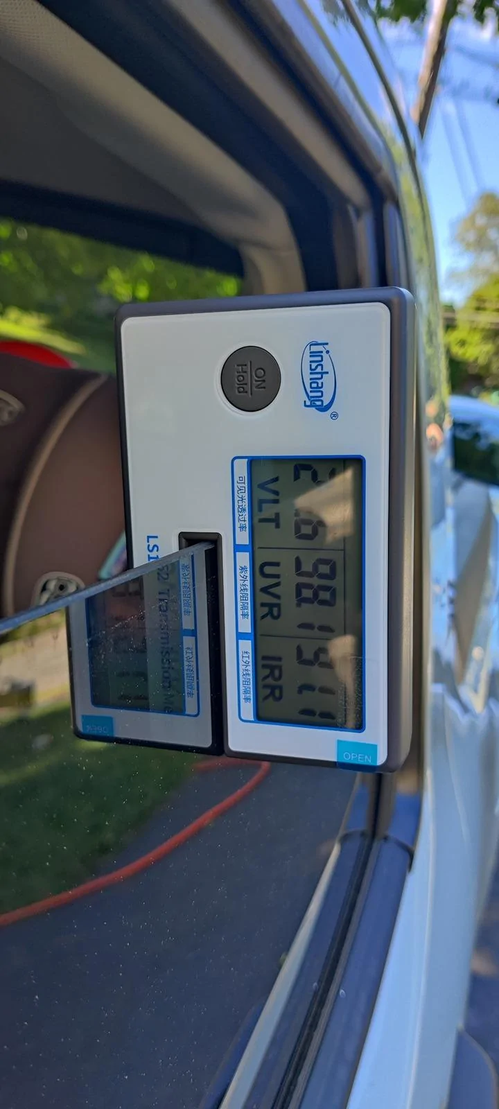

Window tinting is getting done today! I got a tester off Amazon to check the numbers before and after. The back windows and slider made ZERO sense to get the uv/ir film added. So I only did the front with 45% ultimate IR. Stuck with legal, not messing with taxachusetts.
From factory, the vlt front is 76% and the rears are 21%.
